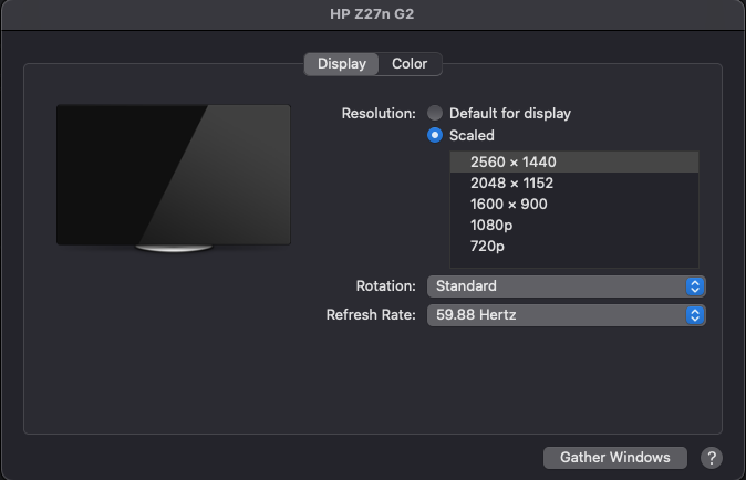

I spent some time to get the highest resolution possible on my Mac running Big Sur.
What ended up working for me is using an HDMI cable (USB-C isn't recognized by the Mac at all) and setting the DisplayPort Mode to 1.2. This is done by going to the monitor's Main Menu -> Input Control -> DisplayPort Mode... -> DisplayPort 1.2.
After doing this I can simply use the "Default for display" option on my Mac or switch to the scaled option where the highest resolution matches that of the monitor
