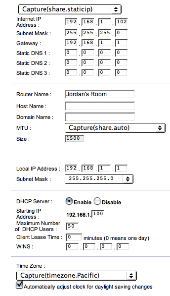

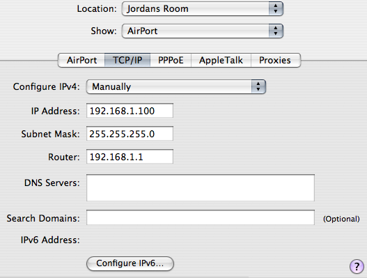

Alright, so I'm in the setup page, but I now I need some more help. I can't remember how I had it set up when I first got it, and I can't get it working again. I'm able to connect to the router, but not to the internet. Attached are my settings in the Linksys setup and in the Network pane on my mac. I have tried a number of different settings but I can't make it work. All I remember is that one of the IP's is supposed to match the computer but one should be different, or something.
As you can see, I know little about networking. If someone could point me in the right direction I would be greatly appreciative.
If you're going to configure the IP address of your Mac manually, you should keep it outside the DHCP range, e.g. 192.168.1.99, so the router doesn't hand out your computer's address to another box.
EDIT: If I read that correctly your LAN and WAN addresses are both in the 192.168.1.X range. Your internet gateway is pointing to the router's local IP address, and the router's internet address is also in the DHCP range. Sounds like a recipe for confusion! What is on the internet side of your WRT54G?
Unless you're behind another NAT router, your router's internet address should not be in the 192.168 range at all! Can you use the ping page in the WRT54G to ping something on the internet?

DinoAdventure said:
The only reason I tried manual is because the automatic settings didn't work. Trust me, I am plenty confused.
So if I want my mac's IP to be out of the DHCP range, what should I type in?
Sorry if I am confusing to deal with, I know nothing about this stuff.
Thanks.
No problem, manual settings are OK, but they require you to configure more things. As CRAM says, you need to tell it everything, including DNS server addresses.
From the router config page your DHCP range is 192.168.1.100 to 192.168.1.149 (50 maximum users), give your Mac an address in the range from 192.168.1.2 to 99 or 192.168.1.150 to 254. The article you originally linked to had 192.168.1.5. Try that.
However I think your bigger problem lies upstream from your router. If your "internet" address really is 192.168.1.102 you are behind another router and no amout of tweaking you do to this one will clear your firewall issues.
What is connected to the "internet"/WAN/public side of your router?
