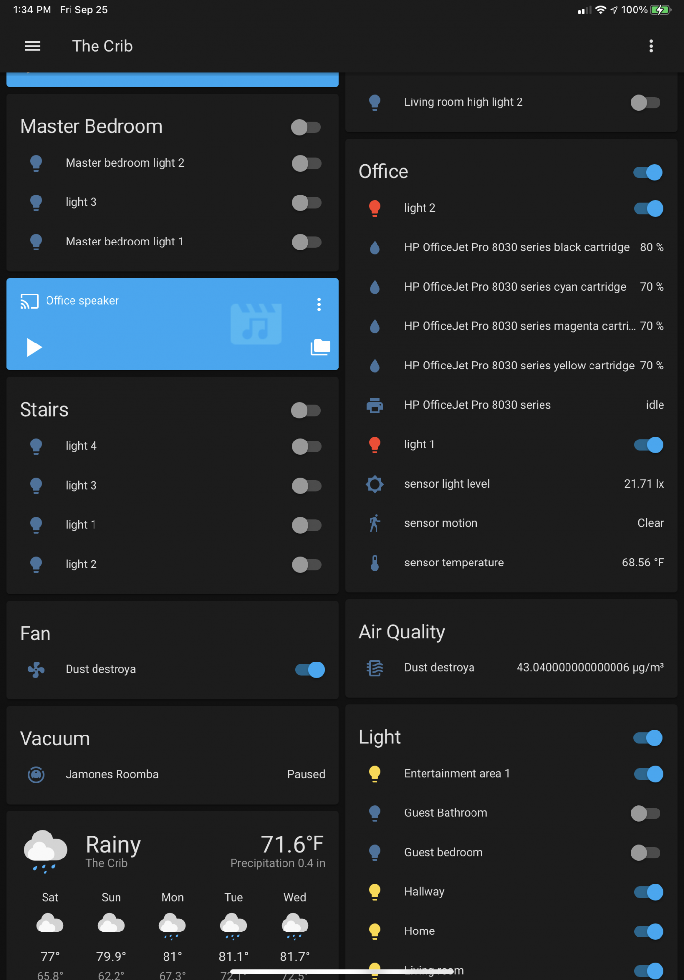

You can make even more progress by running Home Assistant. Similarly to HomeBridge, it will allow you to forward all non-homekit compatible devices to homekit, but its also it's own standalone Home Automation platform. You can write your own automations in there, you can fully debug them, you can view raw sensor/event data coming in.
These days, I use HomeKit so that I can control my devices through my phone when I want to manually control them - but almost all automations are in HomeAssistant. The only ones still in HomeKit are location based ones.

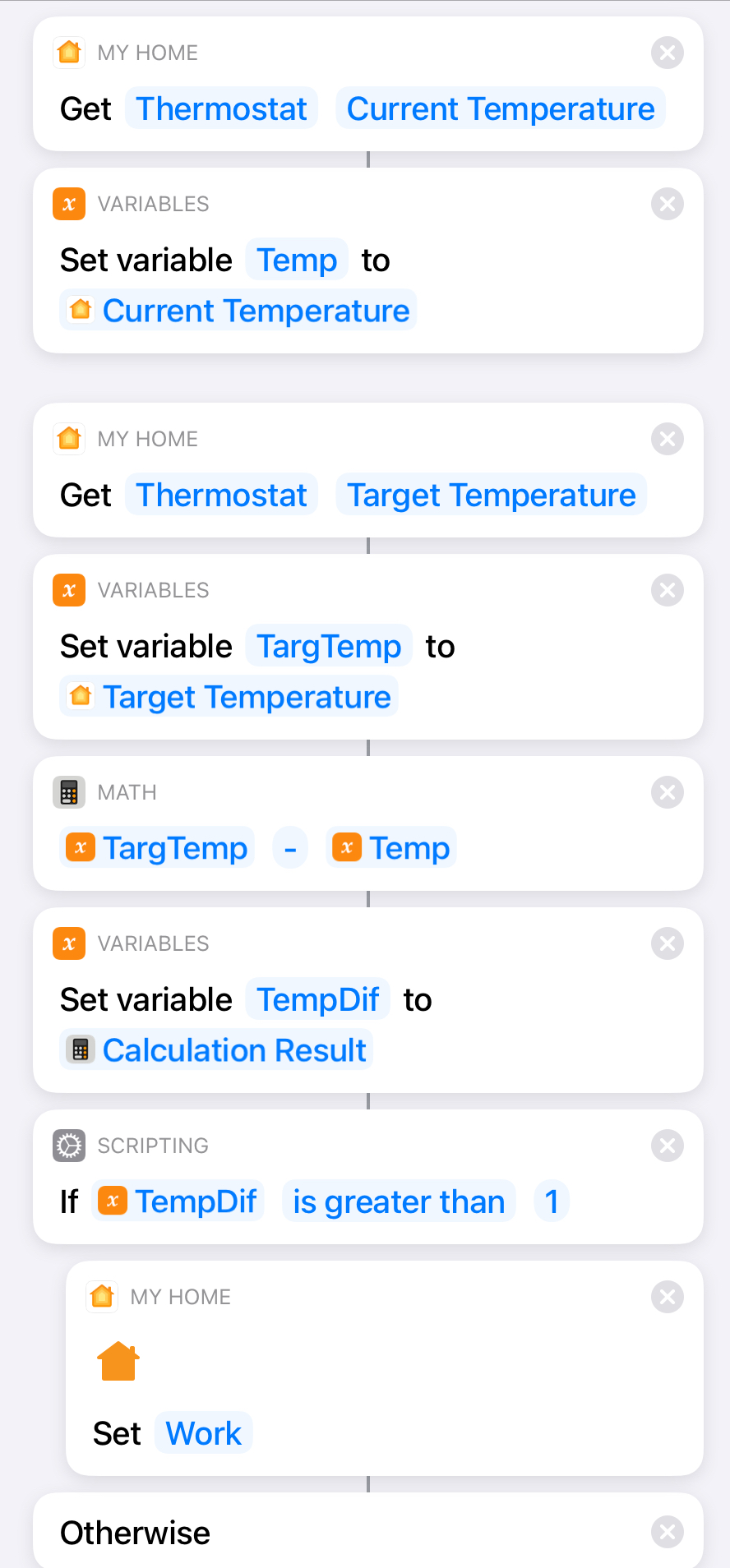

And looking at Home Assistant programming now (at a very cursory level) I don't see much there that's an improvement over Apple. The logging/debugging may be better, but the basic functionality is the same. For example I see no way to trigger based on something like "outdoor temperature is higher than indoor temperature". Same complaint as I have with Apple, that the system won't given me a proper programing language (with arithmetic, variables, and if/then), just a few ways to construct rules.
yeah, you can do that with home assistant. You likely were looking automations but you need to look at scripting/templating. Automations are usually shown as being very simple in examples since the most common use case is extremely basic stuff. But the automation triggers can be scripts, which would allow things like mathematical operators in conditionals.
with that said, are you sure you can’t do that in shortcuts? Here is one a made below showing a quick example of how you would be able to use math operators. I thought you just meant that’s it’s annoying to write these in the shortcuts app rather than a proper IDE

with that said, are you sure you can’t do that in shortcuts? Here is one a made below showing a quick example of how you would be able to use math operators. I thought you just meant that’s it’s annoying to write these in the shortcuts app rather than a proper IDEView attachment 960344
Are Shortcuts created like you did above "Automated" in the sense that they live on a device like an AppleTV and fire automatically as appropriate? In your example, sure, you can read the various data and decide to do something, but what's TRIGGERING when the script activates?
As far as I can tell all you have done is write a ShortCut that reads HomeKit data (and perhaps launches a HomeKit Scene) which is NOT the same thing as creating a HomeKit Automation.
Right now it seems that the best you can do is
(a) have the thing as a Shortcut that lives on your phone (meaning it does NOT live on the aTV, and is constrained by phone limitations and presence) and
(b) triggers via something like running every five minutes to see if the values involved have changed enough to trigger the script.
I know it sounds like I am endlessly whining, but the reason I am whining is that no-one involved in this space (including helpful amateurs like yourself) seems to be actually trying to do these things for real, meaning no-one sees how hopeless the tools are. In this case, for example, the point is not ONLY "read some variables and make decision", it's do that (read variables, make decision) IN THE CONTEXT OF HOME AUTOMATION -- which means in the context of being triggered by changes in the sensors of interest, and in the context of running on an always-on device (aTV or HomePod).
Yeah, I use shortcuts like this but I never had a need to do one with math operators so I wrote that just to test the concept.
For myself, the things I want to trigger on are me (or my family members) entering/leaving home, me entering rooms (aka triggered via motions sensor). So obviously those are well supported in homekit as activation triggers.
Temperature sensor based triggers do exist. I don't know if the HomeApp supports it as a trigger - but looking online there are many poeple doing it with the eve app. In case you didn't know, the Eve app (free) is used by a lot of people because it exposes the full range of homekit triggers available on an aTV while Apple has traditionally not fully exposed them all.
Going beyond HomekIt and back into Homeassistant - in home assistant everything is an automation trigger. If a 'device' sends an event to HomeAssistant - home assistant can trigger anything you want to write based off that event. I put device in quotes, because technically it doesn't even need to be a device. In homeAssistant, any plugin you install can send events as if it was a device. So if you didn't have an external temp monitor, you could install a plugin to pull local weather info from whatever weather service - and have temp change events pushed into HomeAssistant as if you were getting temp events pushed to you from an actual device.
