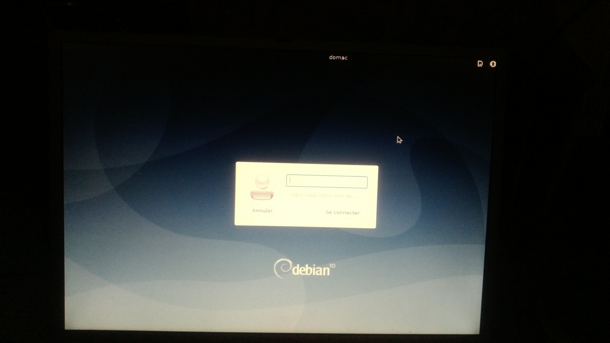

i got instaled demian, only for the desktop , i had no time yesterday
now when it boot it come to this...and when i fill up it go dark and come again asking me for login , again and again

Go to tty (ctrl-alt Function key)
Login as root with root password and then for example:

@Jeroen Diederen Why would you suggest he install lxdm? LightDM is perfectly working on Debian 10 and it's already in. That will just over-complicate things.
@Bouton888 What desktop did you install, if you did install one? Did you install sudo so you can bypass logging in as root all the time?
It might be a keymapping / pbuttonsd issue. On my powerbook i have to use FN+CTRL+ALT+F1 - F7 as by default the function keys handle brightness, volume, kb backlight etc. Using FN bypasses that.

yes i did not install the desktop yet, yes sudo is installed, i wanted to go directly on root to install the desktop
like i tried to say there are no desktop , but at login even if i enter the right login and password , it goes, and come again asking the same
It's not putting you into a desktop because you didn't install one yet. What else can it do?
If your PowerBook has an Fn key, you need to hold that when doing Ctrl + Alt + F1. Once you're in, do sudo apt install lxde or xfce4. Afterward reboot, and you should be able to get in.

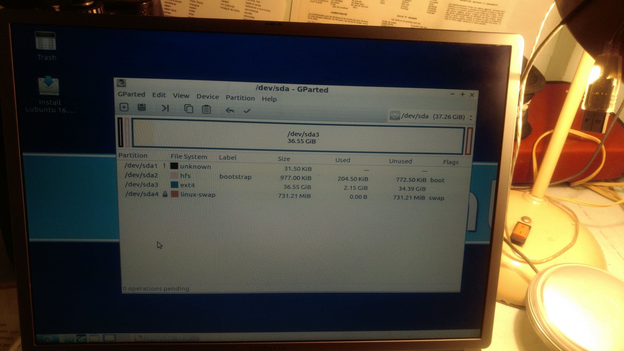

then i put the lubuntu cd in
[automerge]1578248365[/automerge]
but the titanium is only 40g disk so i install the lubuntu on a usb stick
[automerge]1578248415[/automerge]
but now it does boot any more and give me invalid file name

So you're trying to boot from the USB stick in Open Firmware? What command are you giving it? The PPC Linux Wiki has a section on booting from USB. Try what's there.
Lubuntu will fit on a 40gb HD. You don't need to overcomplicate things with a USB stick. As long as the HD doesn't have anything critical on it, I heavily suggest installing to disk.

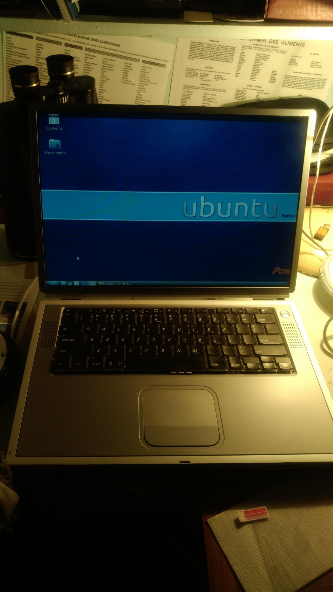

Thanks a lot, i finaly instaled Lubuntu on hard drive , will see how it work on this Mac, right now it has less then 1g ram, normaly on other computor , i use mostly Mint or Arch or Debian, I will anyway want to try on another hard drive the debian 10 soon and do the process all over again... witch one do you think fit best for this Mac Titanium?

Taking into account hardware compatibility, hardware capability, and ease-of-use, probably Lubuntu 12.04 (also available from @wicknix).
Of course, the decision is yours.
