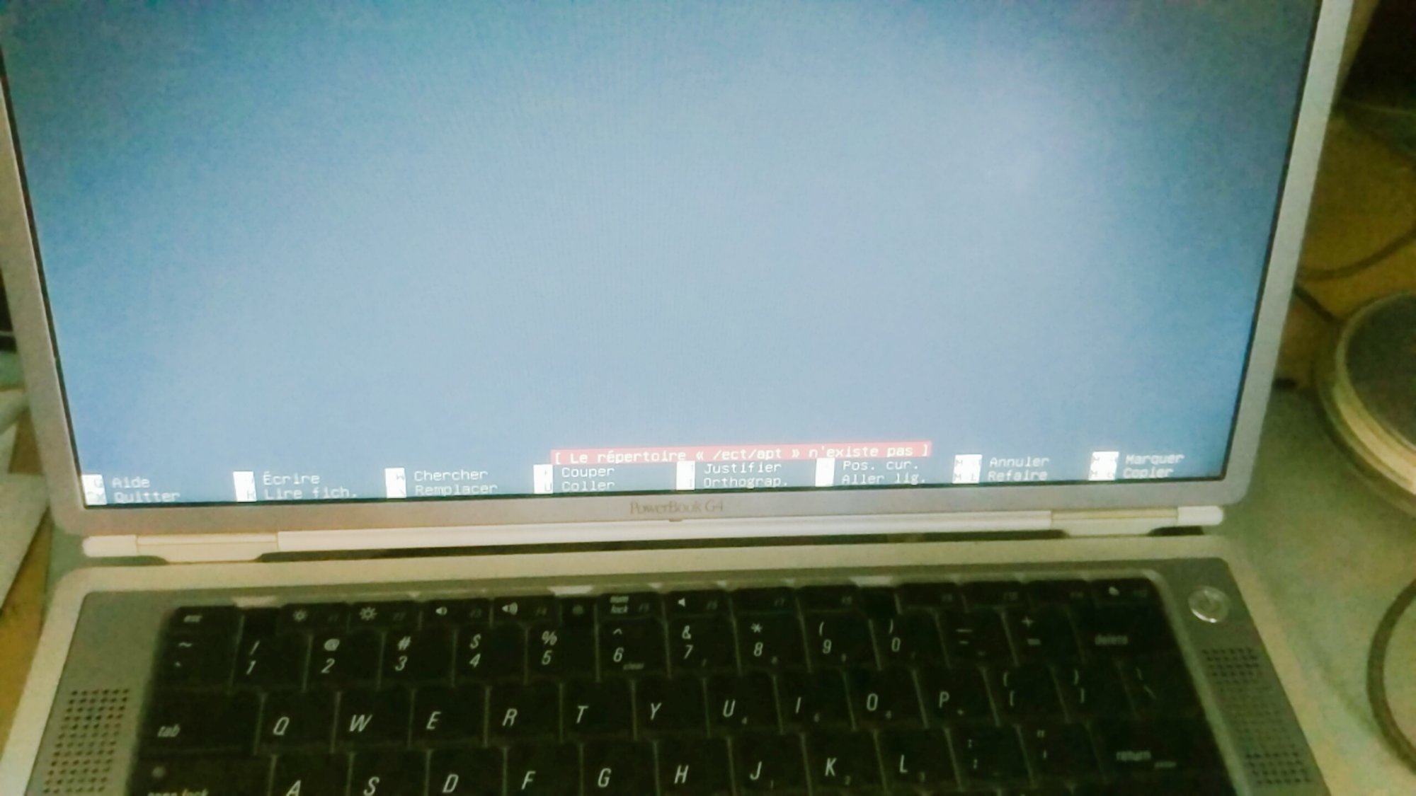

/etc/apt/sources.list is what i wrote with nano
[automerge]1577742986[/automerge]

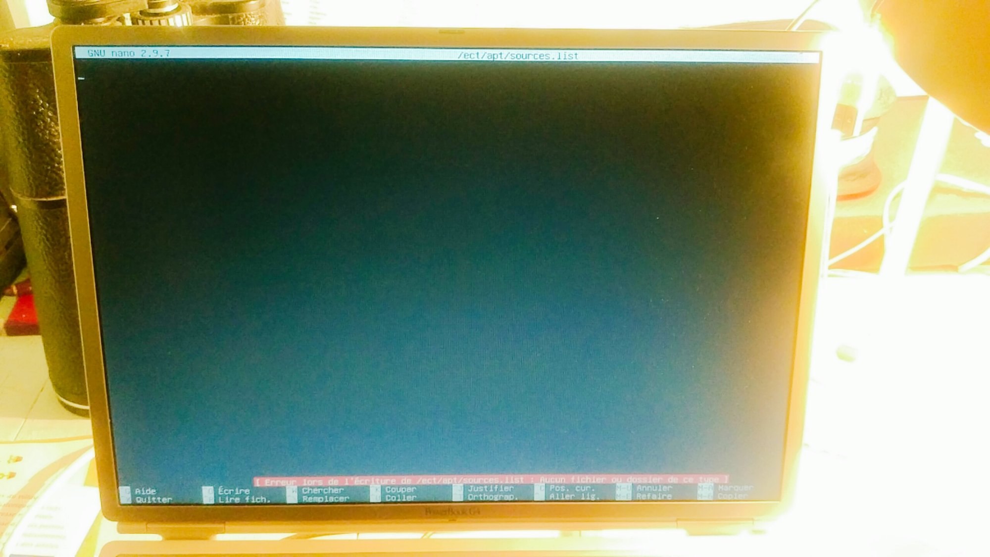

tap enter , it says /etc/apt/sources.list does not exist, do i have to create that ? how?

All I'm seeing in both images is "/ect/apt/sources.list". You don't see that?
This directory is an abbreviation of "etcetera", thus "etc". According to your two linked images, the only thing nano is reporting is "/ect/apt/sources.list". Everything in that string is fine, aside from "ect", in which the "c" is supposed to come after the "t", not the other way around.
As I recall, this same confusion happened to another member on this forum several weeks ago, and I've even entered the wrong string sometimes when trying to access said file. It's a common mistake.
But let's move on from this... On Debian 10, apt edit-sources will provide the same thing as nano /etc/apt/sources.list. Give that a try instead.

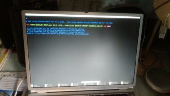

thanks for your patience, here we go, i got inside nano there are some blue line then green one and more blue line, shall i keep going i proceed with deleting and rewriting?

shall i delete and write this?
For Debian 10 (Buster)
deb http://snapshot.debian.org/archive/debian-ports/20190707T221412Z/ sid main
and then this?
Then run 'sudo nano /etc/apt/apt.conf.d/00aptitude', and add:
Acquire::Check-Valid-Until "false";
Now you can save with Ctrl + X ---> Y ---> Return

First, hold Ctrl + K to delete everything onscreen. Then, just enter in:
Afterward, do a Ctrl + X ---> Y ---> Enter to save.
When back at the CLI, do nano /etc/apt/apt.conf.d/00aptitude, and add:

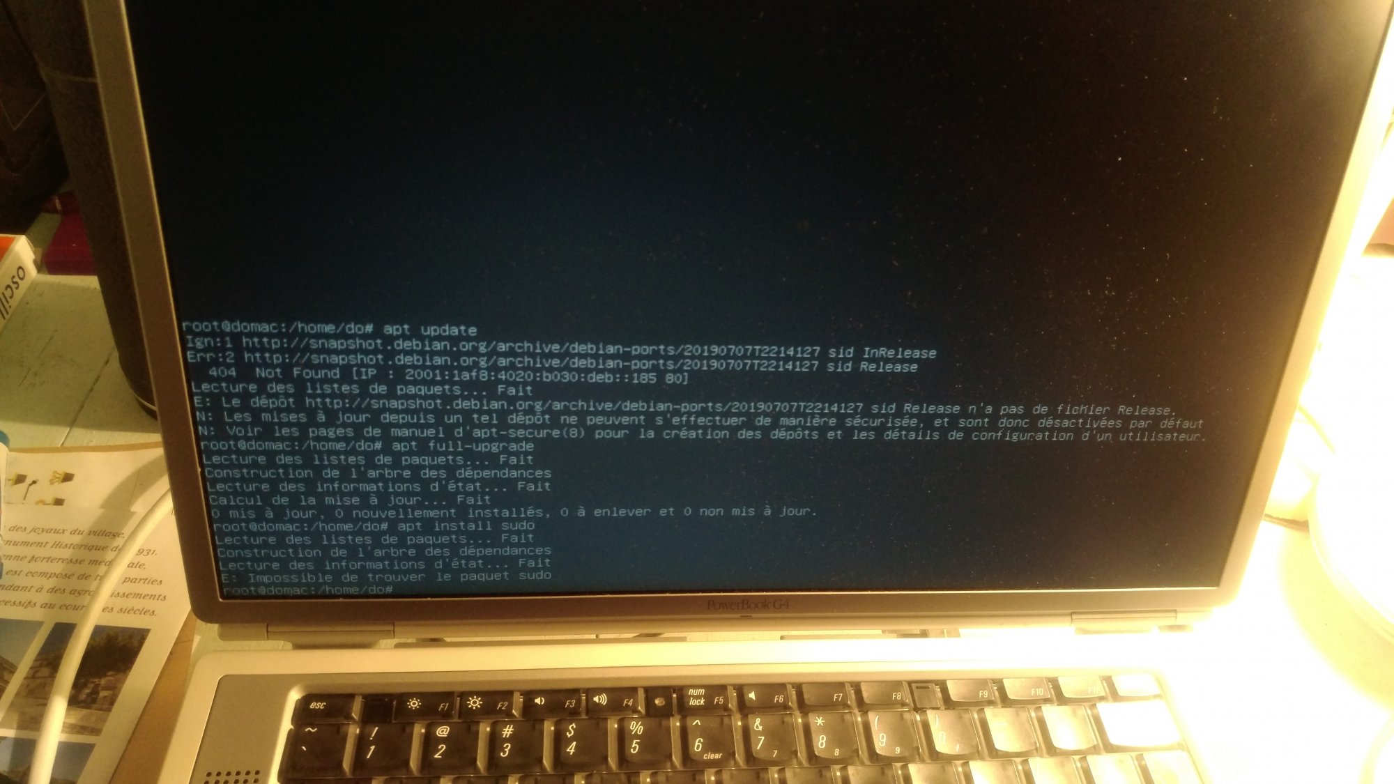

it says: there is not this kind of folder, in french "aucun fichier ou dossier de ce type"
i am not sure all was saves in nano
when i do Ctrl + X, comes the line edit, if i do shift Y it come back to command line
maybe i could try to reinstall this debian with other option?

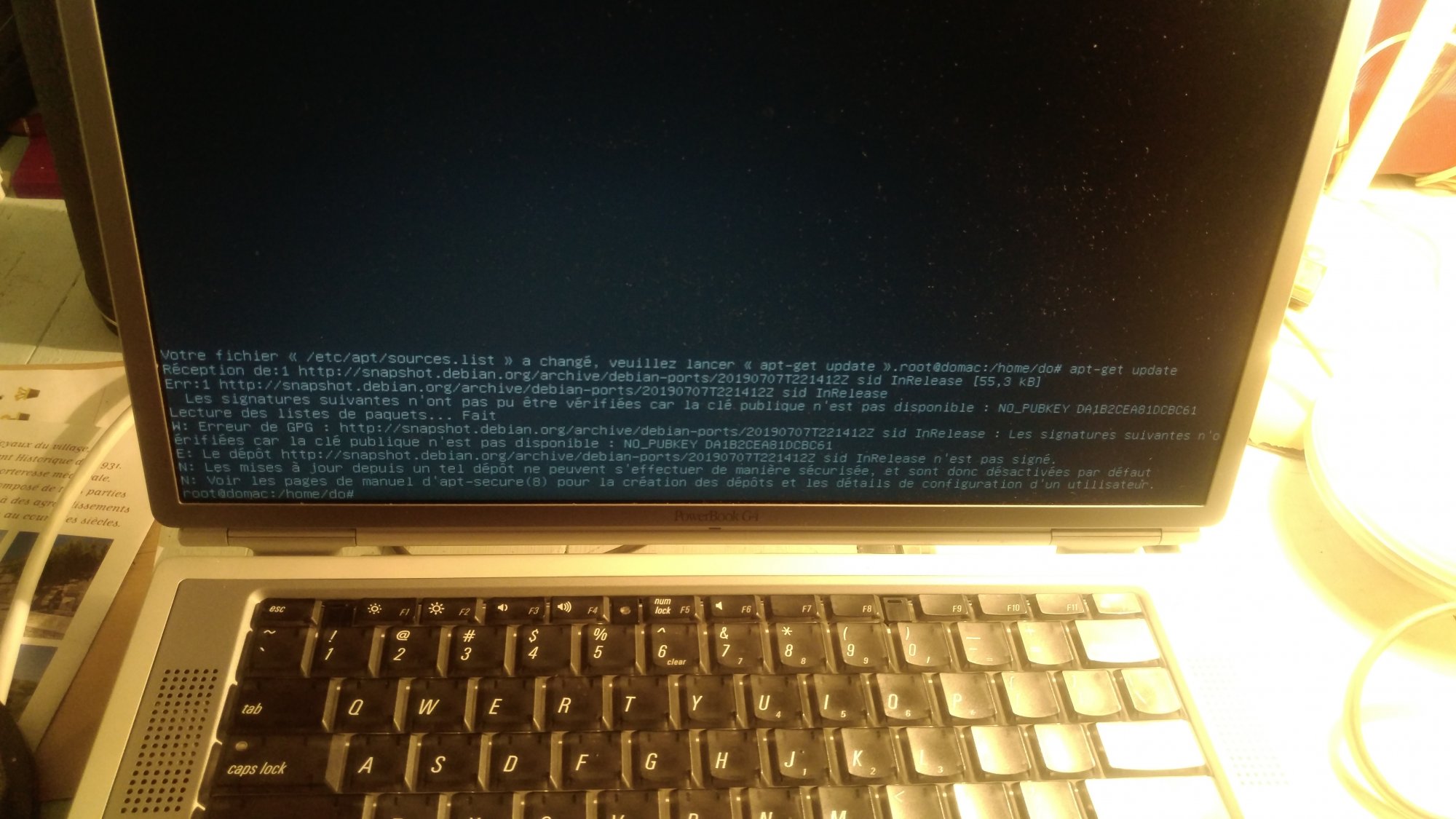

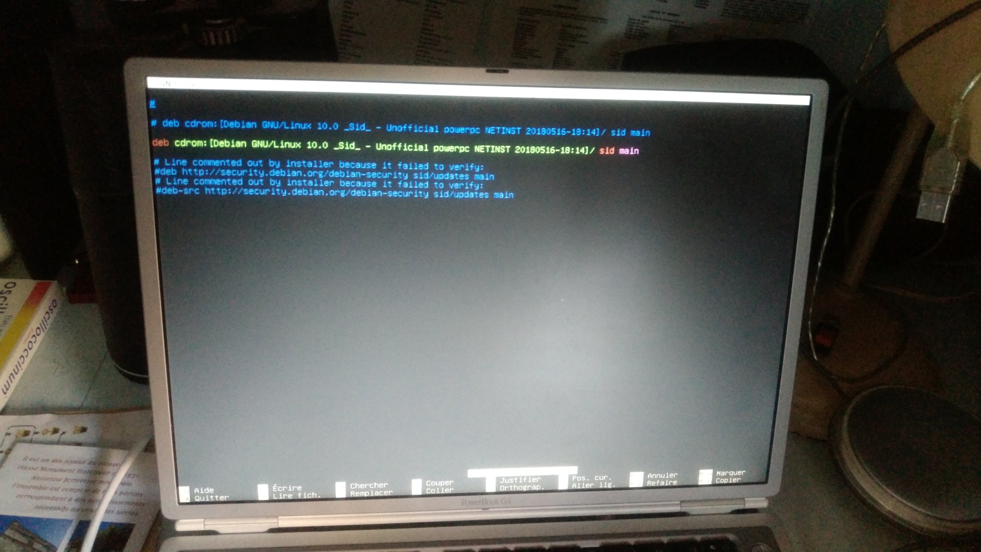

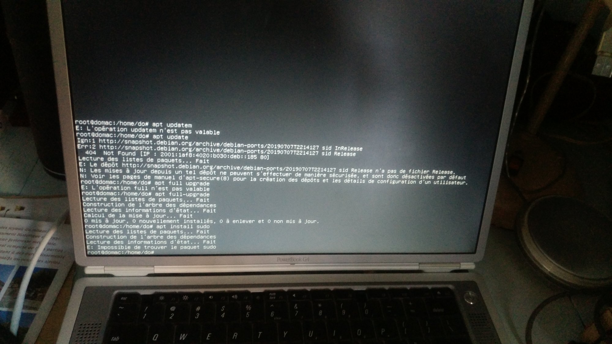

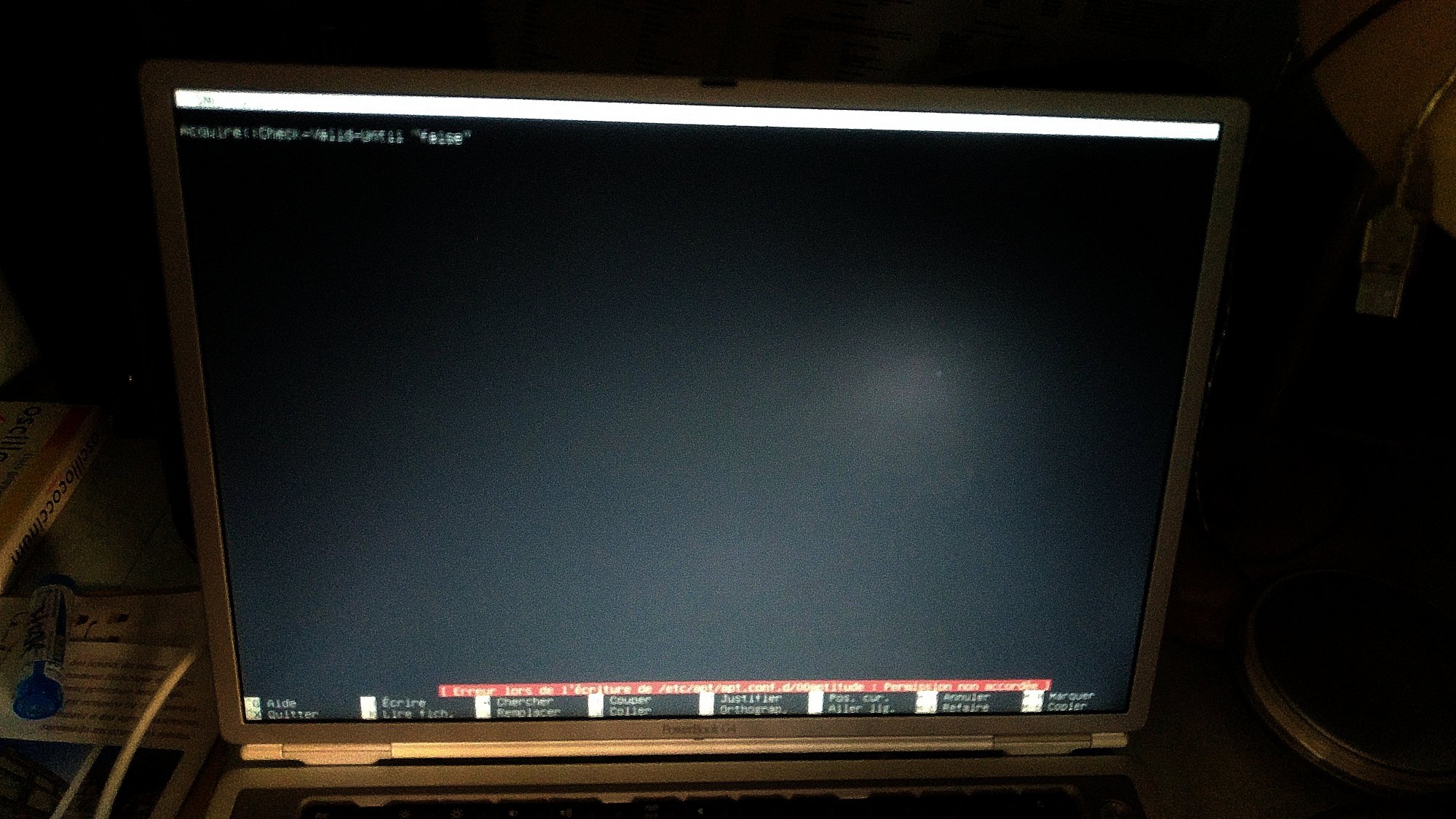

here is the last , i enter nano ,write, save
maybe is the deb http:// not working?
[automerge]1578041081[/automerge]

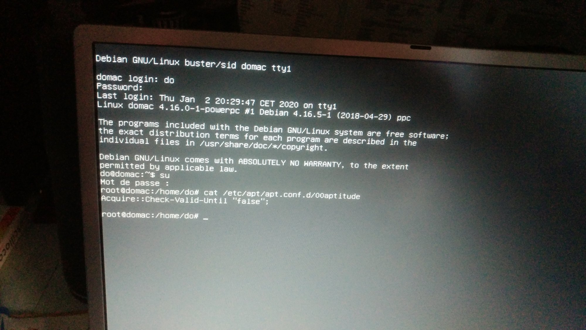

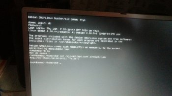

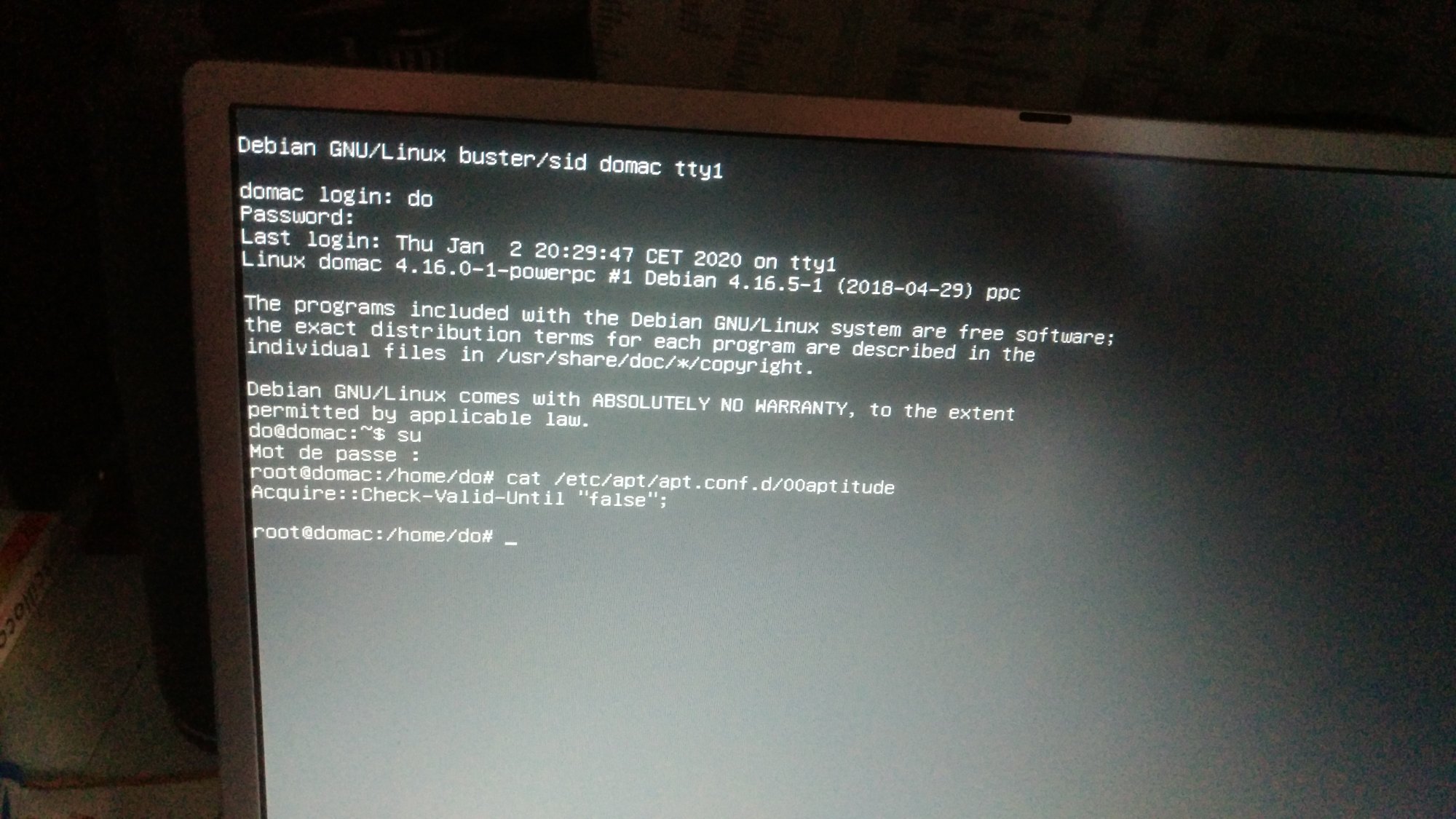

What does cat /etc/apt/apt.conf.d/00aptitude give back?
i edit sources..dis i make an other mistake?

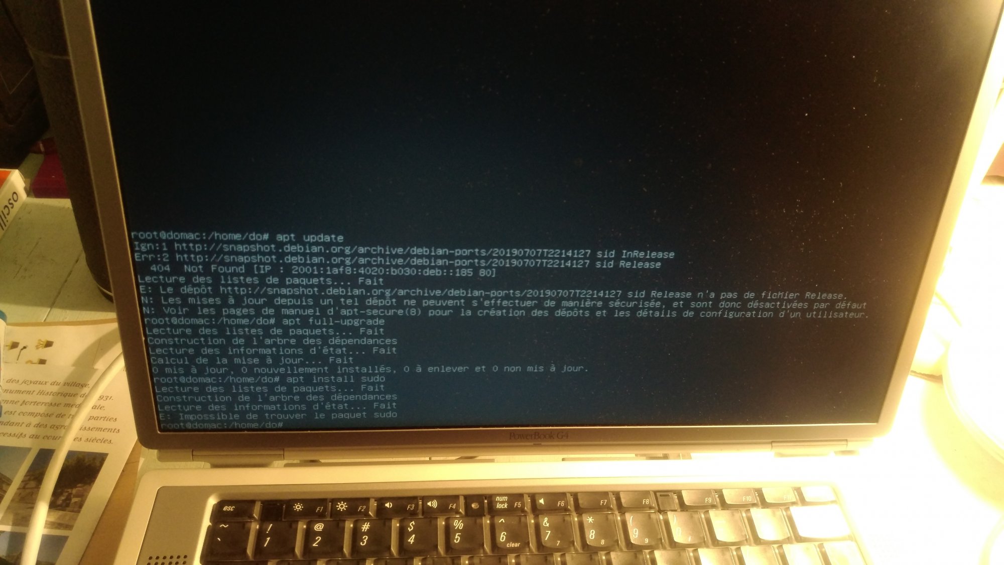

Ahh yes... now we come to the last configuration for Debian 10.
From the Wiki...
6. (For Debian 10 Only) Now, on another computer, download and copy this file to a fresh USB drive.
(http://ftp.us.debian.org/debian/poo...bian-ports-archive-keyring_2019.11.05_all.deb)
Insert this USB drive into your Debian 10 machine, then run 'sudo mount /dev/sdx1 /mnt'
('sdb1' if you have one HD, 'sdc1' if you have two HDs.)
Afterward, do 'cd /mnt', then 'sudo dpkg -i *.deb'. Then, update the repositories with 'sudo apt update', and then update your packages with 'sudo apt full-upgrade'. Select 'yes' when you're asked about upgrading services without restarting. Once it's finished installing, you're ready to get a desktop environment.

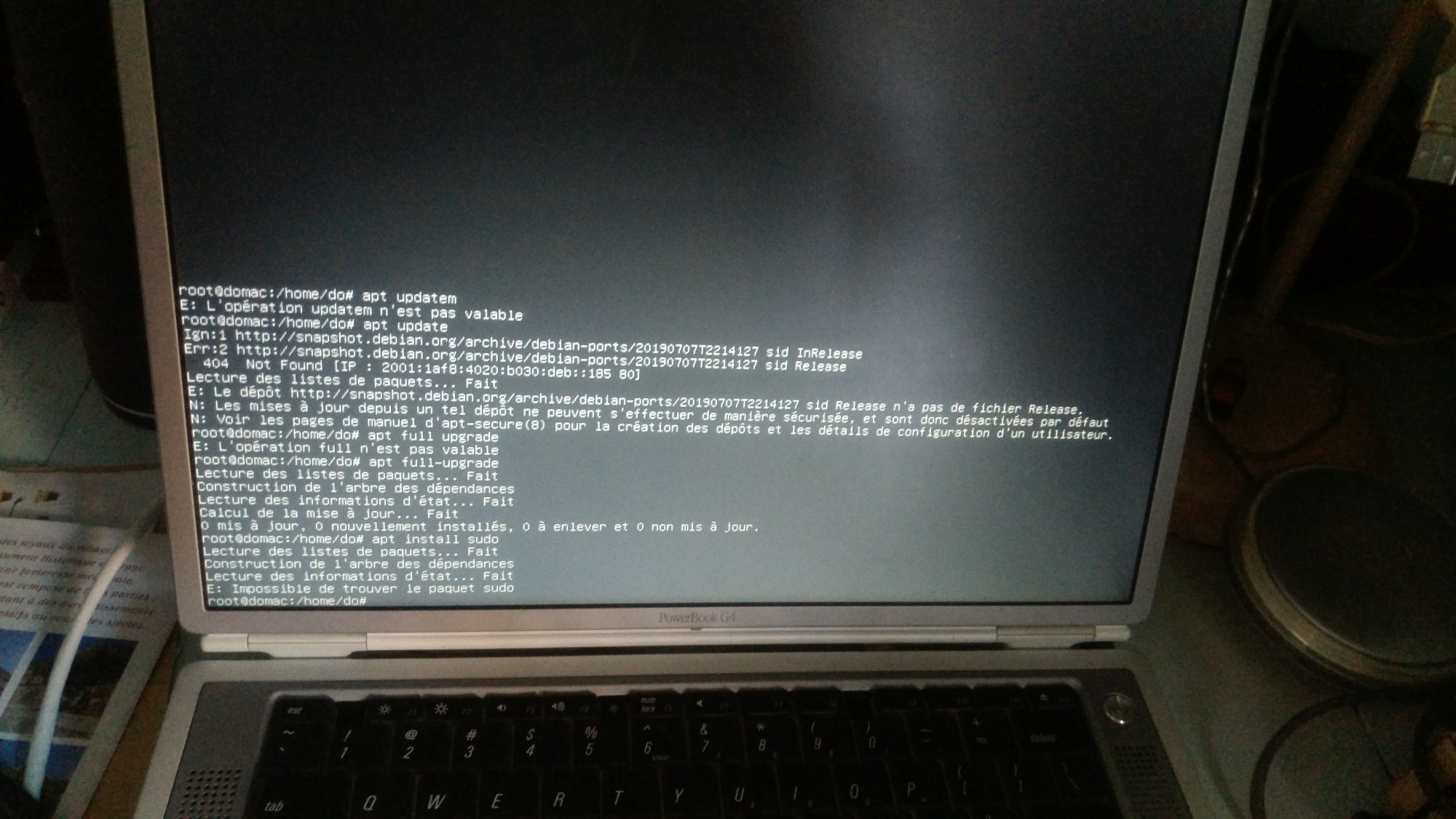

sudo does not work
