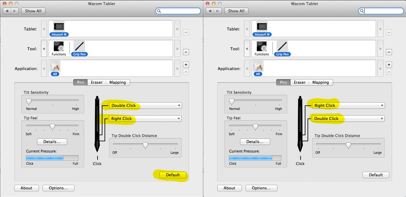

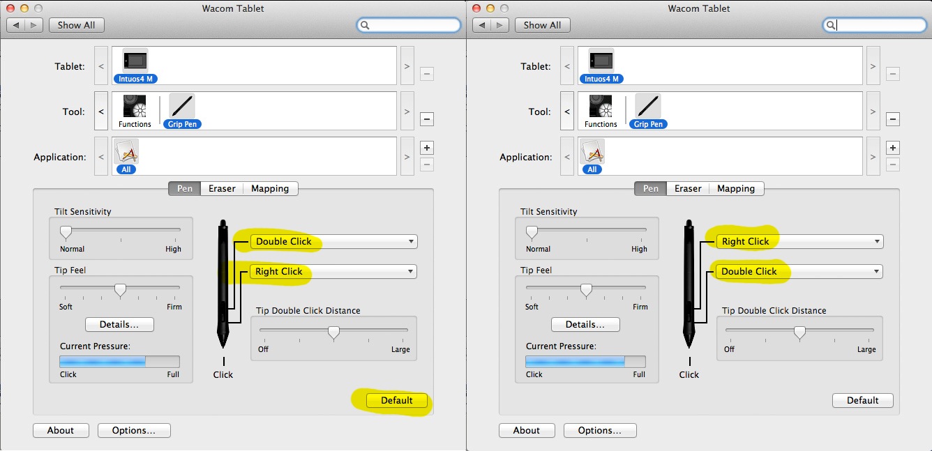

Found a solution to the double-click problem (well, it works for me, and I hope it works for anyone else who's had this problem).
Launch the 'System Preferences' Panel,
choose 'Wacom Tablet',
click on the 'Default' button - this will set the buttons as illustrated on the first panel.
you can then change the buttons and they should work fine - I personally use the button set up on the second panel.
As for accessing the dock during full screen mode, I think Wacom and Apple will need to sort this out, as it needs 2 separate movements to perform this: one swipe (on the trackpad) to take the cursor to the bottom of the screen, and a distinct separate downward swipe (again on the trackpad) to raise the dock. This is something that cannot really be replicated on the tablet.

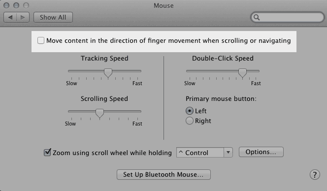

Don't know if it will work for you but I found that solution :
go to System Preferences > Mouse > and remove the tick from “Move content in the direction of finger movement when scrolling or navigating”.
