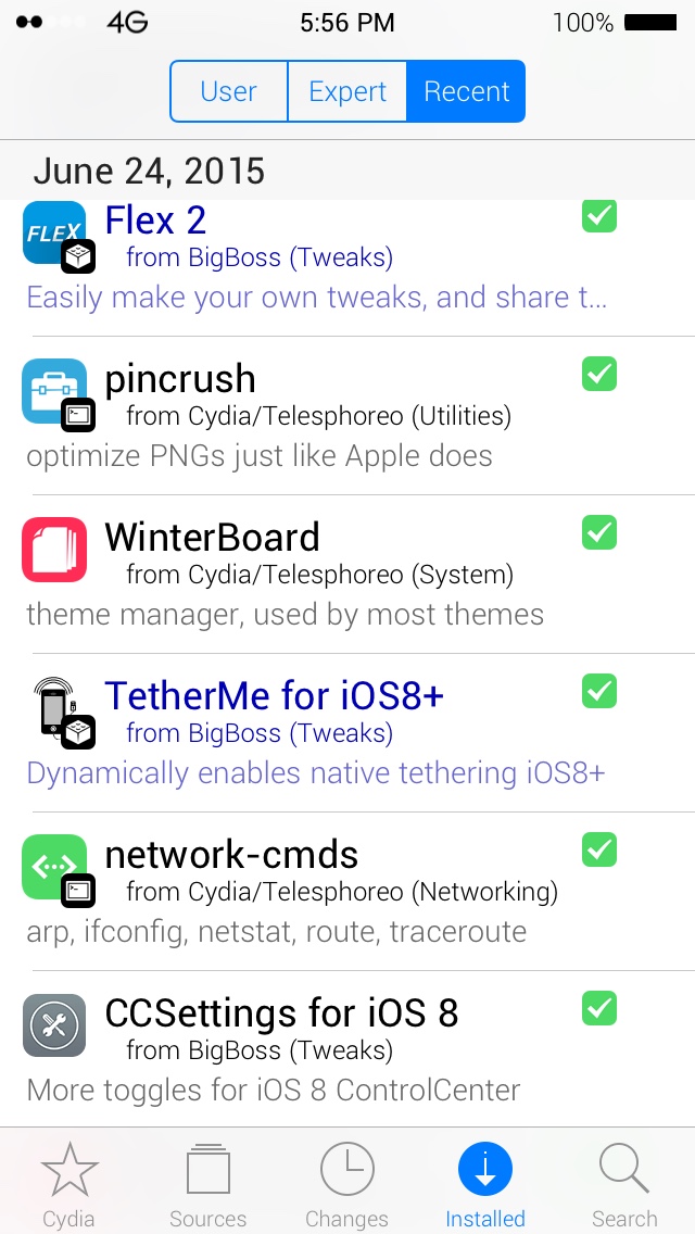

What's the dependency that I need to install? Never had to do that before.Taig 2.1 needed.
Tetherme and dependency installed.
Reinstall cydia substrate
Reboot.

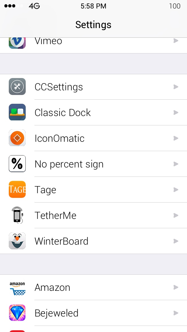

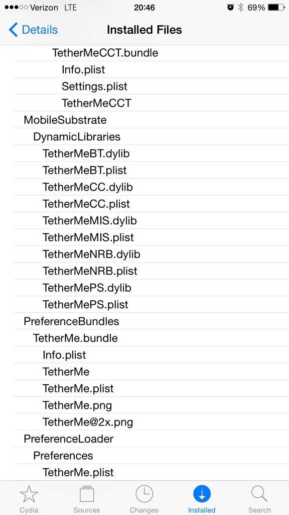

How would I know it's installed? Also I restored my 8.1.2 backup. Any chance settings from tether me stayed for the old iOS version?

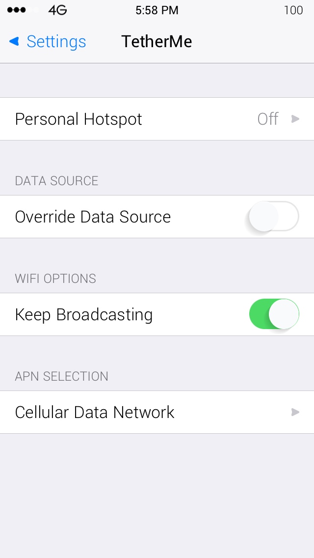

I'll be damned I got it working!!!
Reinstalled everything and the tether me options showed up. Enabled the hot spot in there and all was smooth sailing. Thanks for helping!What did you do to get it working?
