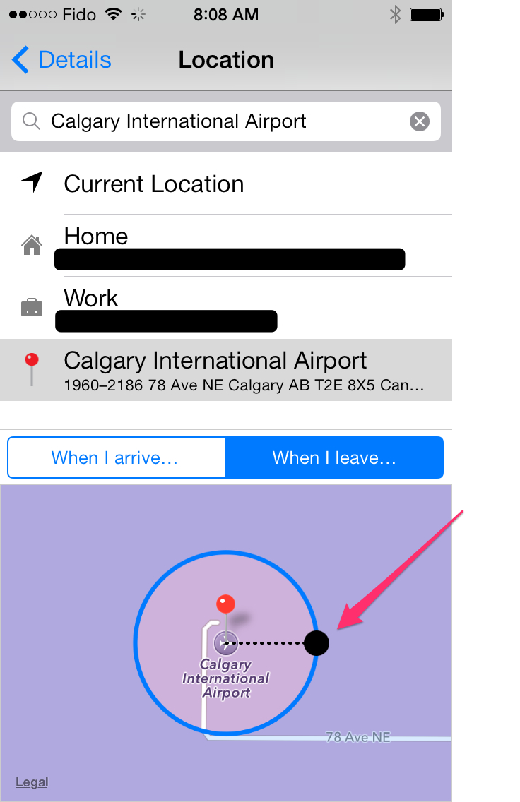

When you are setting up the reminder and click the switch "Remind me at a location" and then click on Location, the screen below shows up. You can then drag the black dot to make the radius smaller or larger.
Is your reminders app running in the background when your geofence reminder works? Mine is working like others, only when it's running in the background. If I close it I don't get them. And the radius is set to the smallest point...something like 326 feet.
Yes, when I double tap the home button I see my Reminders app is running in the background. I believe it has to in order for geofenced reminders to work.
