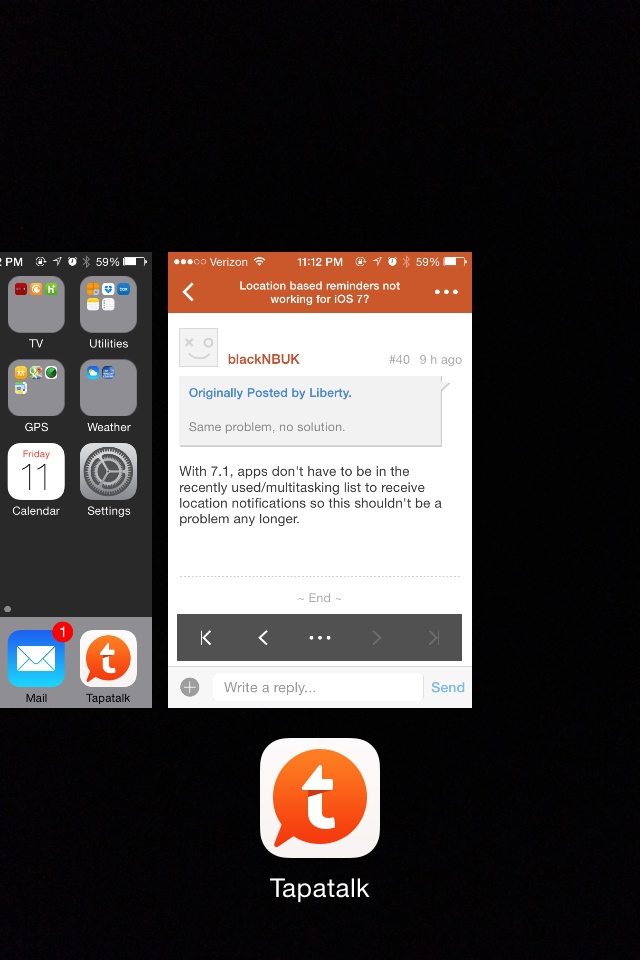

I don't know if this was resolved with 7.1 but it works fine for me without reminders running in the background.
Here is a screen shot. It's difficult to see but tapatalk is the only app I have running but if you zoom in you can see the GPS geofence icon due to a location based reminder.

Yeah, 7.1 resolved an issue that was in 7.0 relating to all of this.
