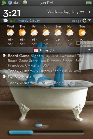

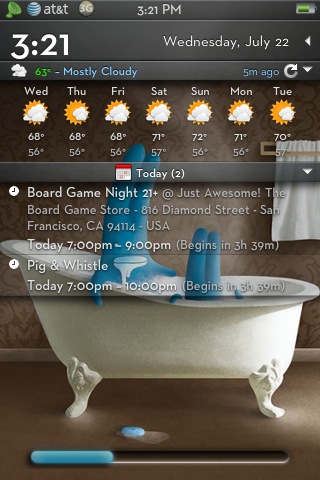

Do you want my code?
If you don't mind...it would definitely save me some time!
Config
I changed those three sections to false and it made no difference on my calendar display, date is still displayed.
Did I miss something ?
