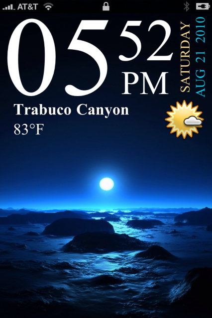

Hi Claude,
Thanks for adding the weather and the separate style sheet. I had a helluva time trying to get the rotated text correctly positioned - the "X" location varied depending on text length, which didn't make sense. I would also agrue that it's considerably hooter than 83 degree here, but WTFDIK.
Anyhow, I put the weather into my HTML file and it looks like this:
Thanks Claude and everyone else.

Hi Claude,

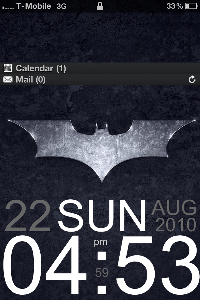

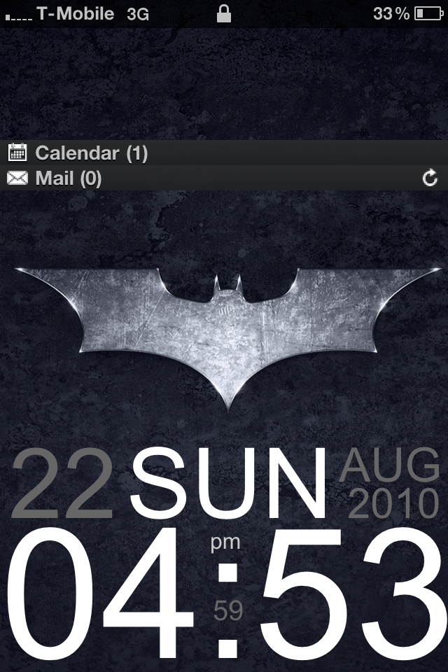

I love this thing!! Here is mine after tweaking it a little bit...
Is that LOCKINFO you're using to get the mail & notifications on the screen? If it is how do you force it to the BOTTOM half of the screen? It's always on top for me.
yes, somewere in the settings you can move the position were it will be
thats the lower you can go btw
In LOCKINFO settings? I looked but can't find it. Maybe it's my old eyes. I'll keep looking.
Thanks.
Thanks.
Settings>lockinfo>lockscreen>layout
There's a slider bar at the bottom for the position, slide it to the right to move the info downwards.
