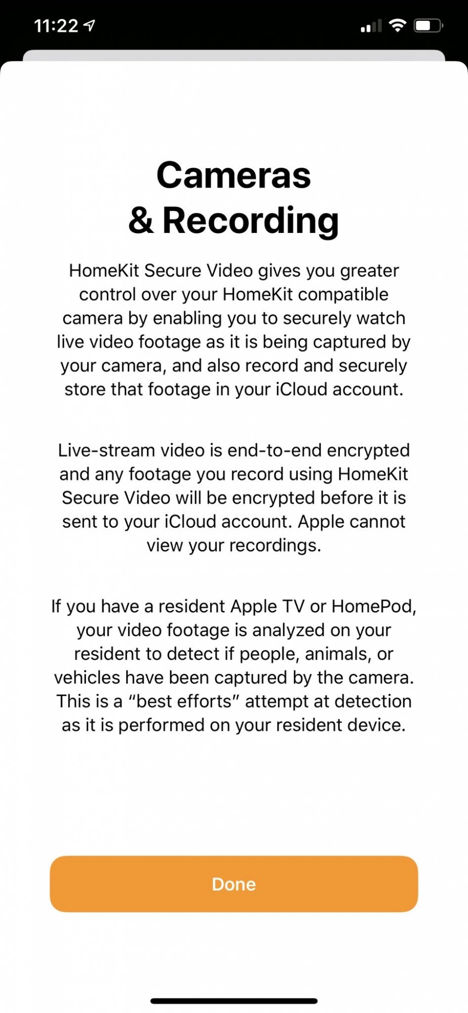

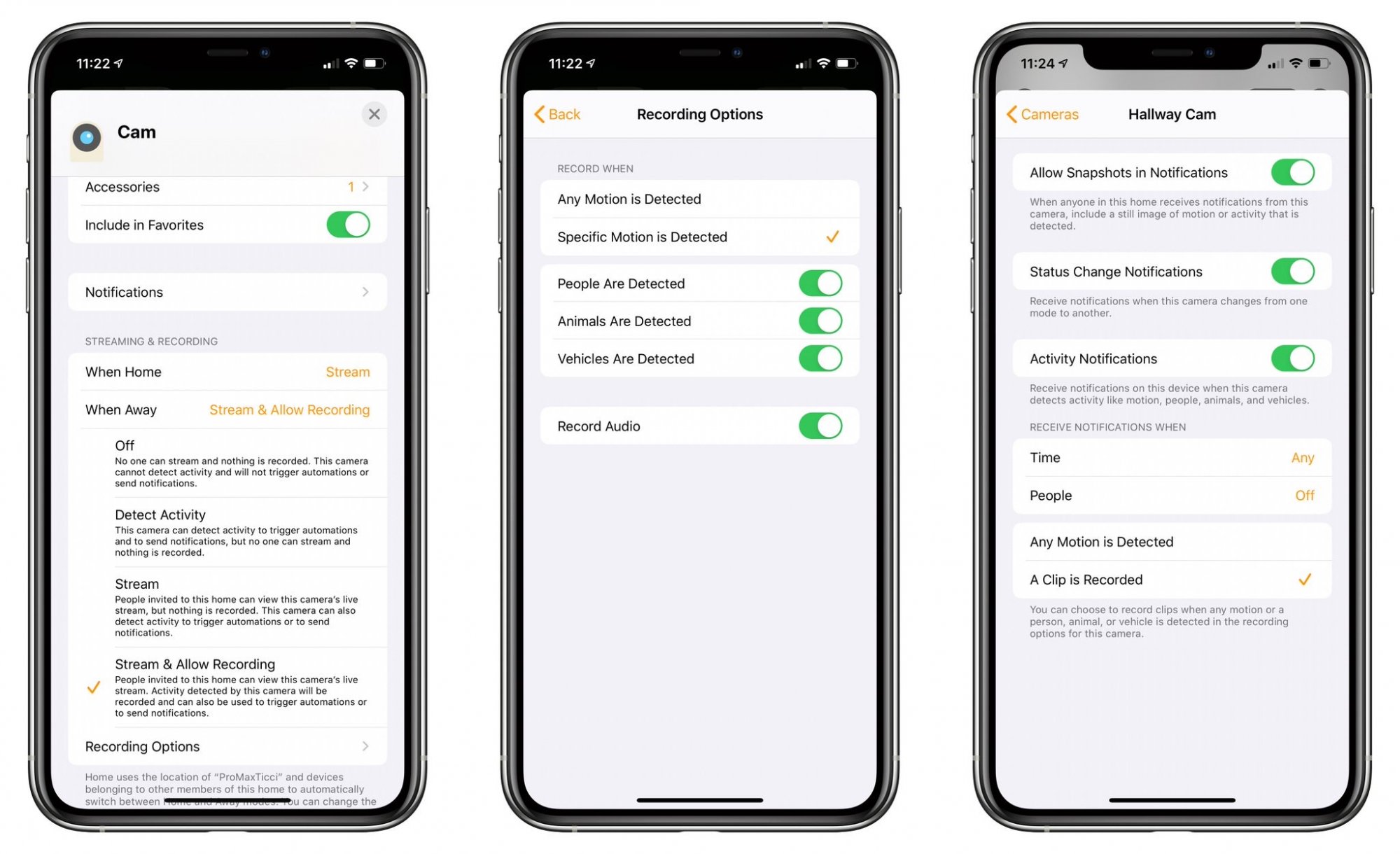

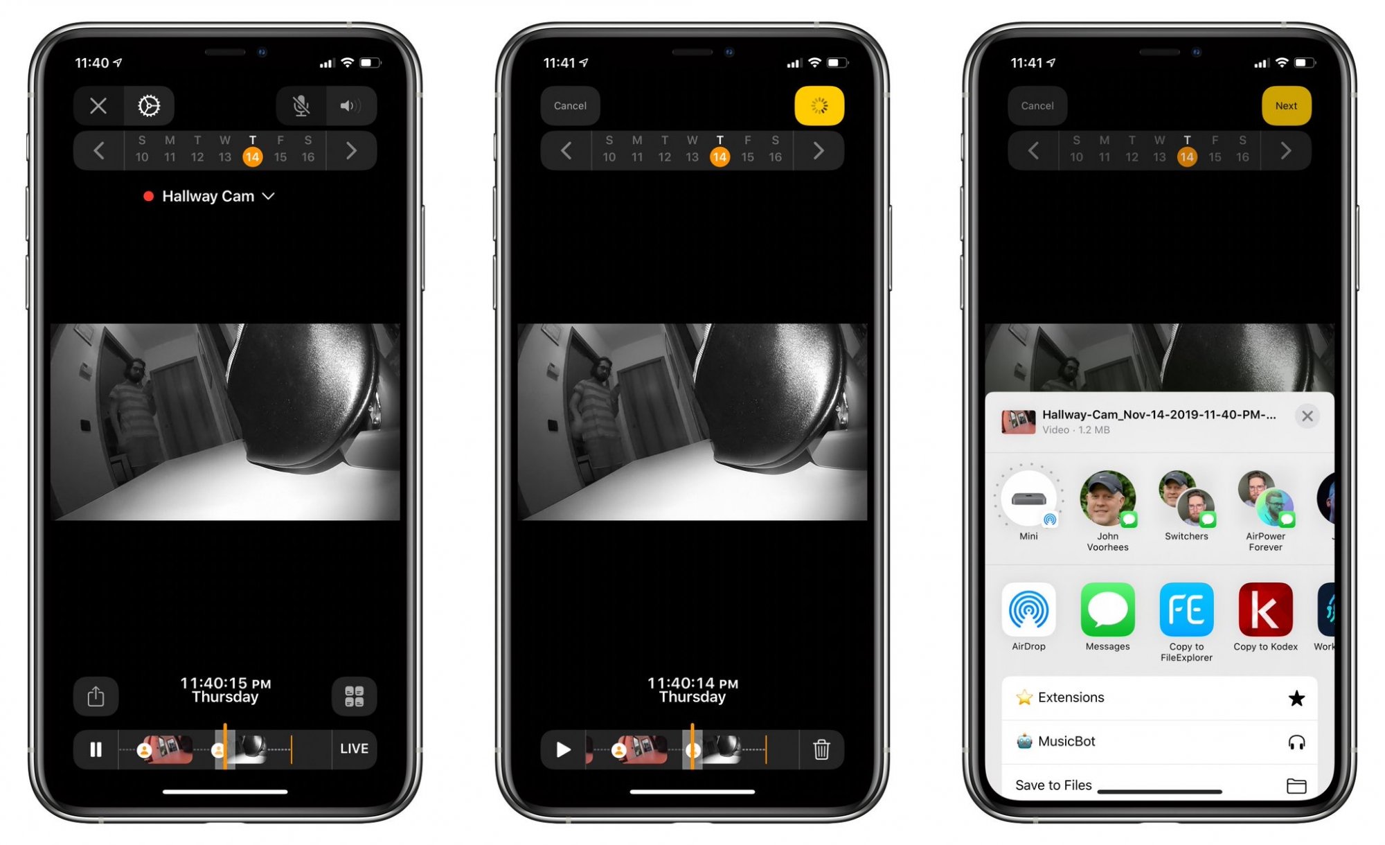

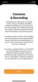

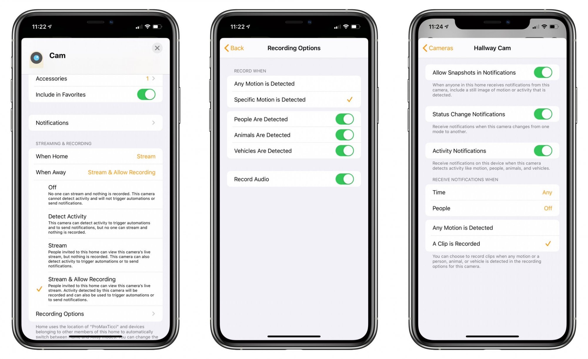

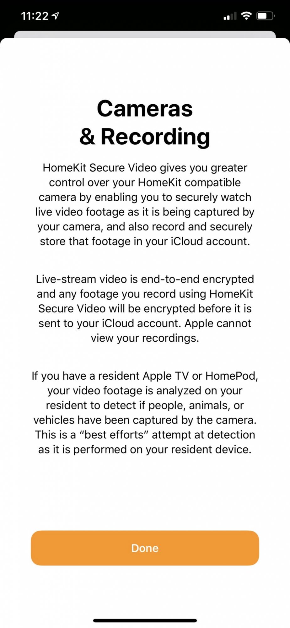

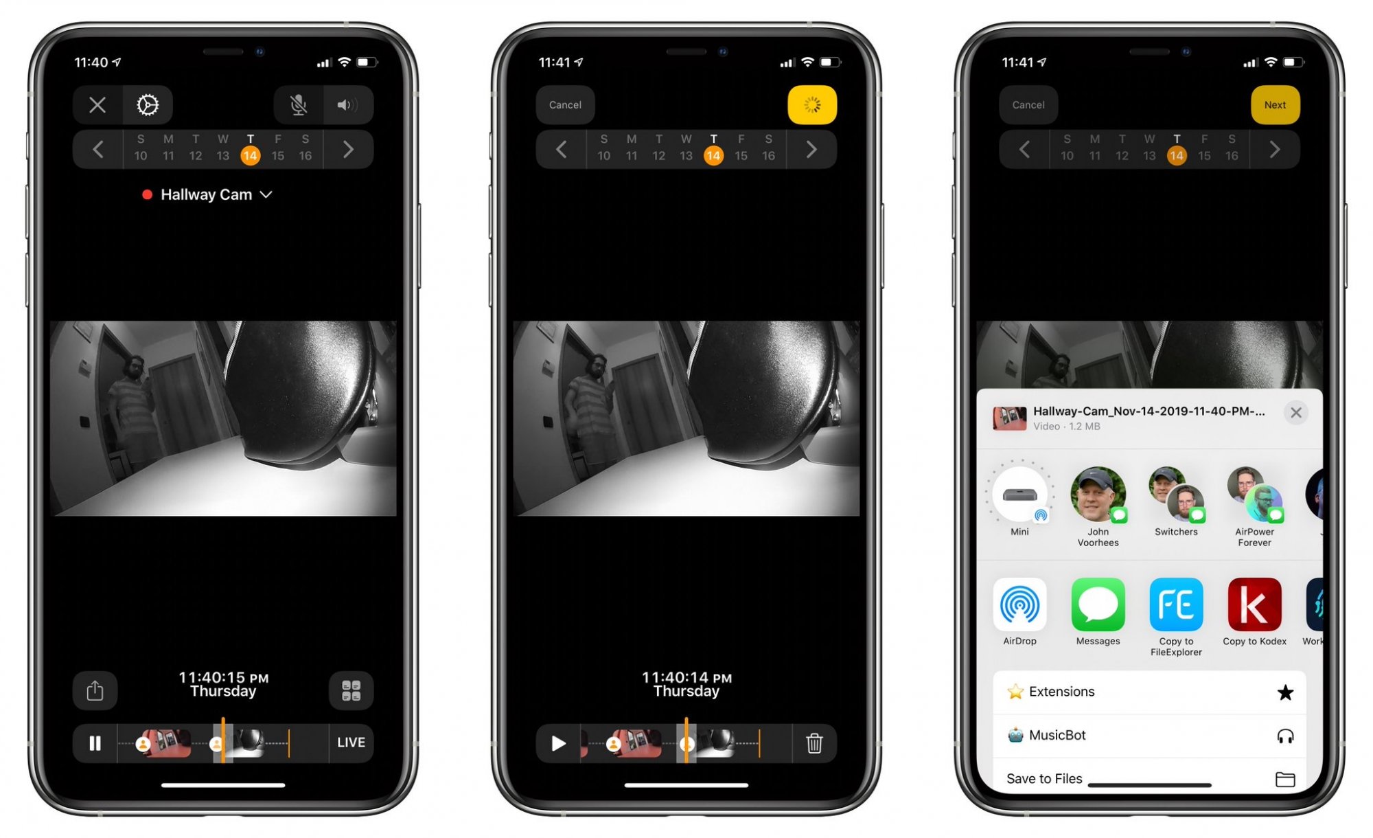

Some more images attached taken from Federico Viticci’s Twitter @viticci.
You definitely get some detection features for free that you’d normally have to pay a subscription for. But not seeing any way to set ‘Motion Zones’.

OK, now I’ve set up the streaming & RECORDING, the app is exposing the full interface. Scrubbing around clips is much smoother and easier than with the circle app.
The clips have little icons indicating what has been detected (ie a car). You can then select it and tap the share icon which very quickly brings up the share sheet. It is actually pretty neat.

works great but I have the option for record only for animals, people, and cars and to alert only on recordings but I'm getting blown up with push alerts from any movement through the windows. I'll have to do some digging.
This is neat, it’s a one way change apparently. Says you need to contact support to switch it back over to work with the Logi app.
Quite a few new useful features that come with the update. You can filter by person/animal/vehicle/general motion detection (though I wish I could record animals but not send motion notifications for them, I like to keep tabs on my cats but don’t need to know every time they walk by the camera). The biggest one is being able to control what happens when you’re home (Turn off, allow notifications only, allow streaming but not recording, and allow recording). You can also control the lights on the camera from Home. It also gives you handy little control tiles for the room that the camera is in as part of the motion notifications.
