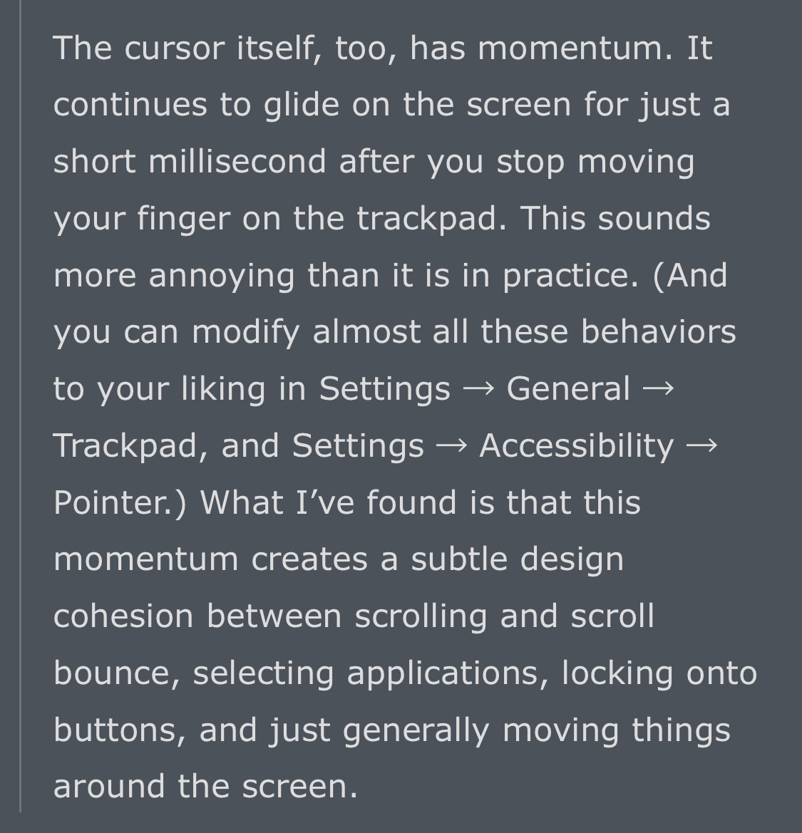

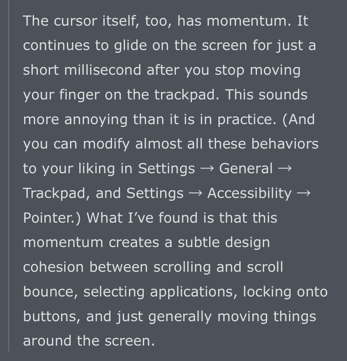

Is this perhaps what you all might be experiencing?
Im not sure if this is the same thing. You can scroll w two fingers, completely stop and only when you remove the two fingers again, it begins movement again even though the only action you did was now remove your fingers, and accelerates a brief scroll.

Stopping scrolling and removing your hand results in a slight continuation of scroll, which sounds like what you’re describing. I don’t think any particular setting can change this and could be a bug requiring future software release. I wonder if the magic keyboard folks are also having the same issue.
Yeah, that’s exactly it. Kinda ruins a lot of the trackpad functionality, which sucks because the rest is pretty great. This issue doesn’t happen at all with the Apple trackpad, so I’m assuming it won’t be an issue on the magic keyboard either. Seems like it’s a 3rd party problem.
Could be caused by the “Trackpad Inertia” setting found in Settings?
Unfortunately, that’s not it, that’s just referring to when you’re moving the cursor with one finger. Here’s a vid of the issue: . See how I scroll with two fingers, stop, but then it keeps going? That happens when I let go of the trackpad. Really annoying 🙁
