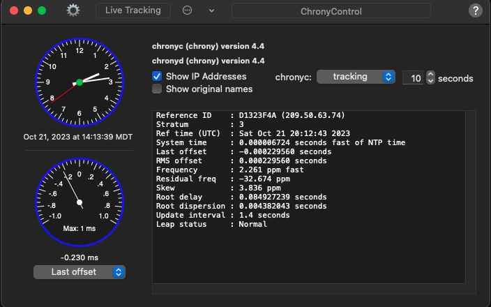

Chronycontrol works correctly on my Apple Silicon macs with Sonoma.
I have it working but it is really touchy. I had to open it from the macOS file. I must have a problem with other software loaded it does not like.
Trust me, there's nothing wrong with ChronyControl on macOS Sonoma on Apple Silicon.
Yes I have it running. However it does not load as I expect it too. There is an issue with My machine and CC's Config file. I had to load the software from the macOS, ChronyCrone File. If I try to load the utility from its icon it doesn't exactly lock up my computer but it continually cycles in and out. I am unable to restart normally and I physically have to reboot my machine. I have expectations on how software should run and at least on my machine ChronyCrone does not meet those standards. But it is running,

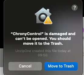

I found out that my favorite Zip opening software has a Mac version. "UnZip One". I used it to open ChronyContro's zip file and this is what it reported.

I have no idea why you can’t unzip Chronycontrol. I’ve just downloaded a copy of the installer to check and I can unzip it using either the built in unarchive tool or betterzip. Perhaps you have a bigger underlying issue you should be looking at, I don’t know.
I was reading about Chrony Control on a page talking about its installation. I have already found the configuration file is what is causing the problem. Trying to open this application normally invokes the configuration file and that causes the weirdness I looked at this webpage it isted what CC was loading on the Mac. I realized these were the files contained in the macOS folder. I installed each one separately a terminal window opened on each one indicating an successful installation. I clicked on the Chrony Control icon and it opened normally. I am not going to look a gift horse in the mouth. Whoops forgot to sync CC with the Apple time server. new screen shot.

Over the many years on macOS I learned, that more people know and work to "fix" macOS, bigger problem they cause. MacOS should simply work and if we have to do what you seem to be doing (I assume you are starting app from inside bundle), more troubles we get into.
1. MacOS DOES NOT need separate unzip program. For zip/unzip, just use Finder. Why? It works AND zip programs are major source of viruses and malware on any platform. So unless you REALLY need more complicated zip features (password protection seems the only common one), do not install any zip tool. Reputable sources of zip apps have been taken over by malware distributors and trusting them can get you in trouble. Minimize your profile here...
2. If program reports it is damaged, throw it away and download new archive from verified source. Not worth wasting time on this and again, it is possible malware is involved.
... I have seen this message few times when the app was OK, but macOS was declaring it malware or it was blocked by macOS for other reasons... Not sure how I fixed it in the end. It got complicated.
3. If program does not start from icon, do not start executable from within the bundle - delete and reinstall. Something is wrong with its settings/environment and it will likely not work right anyway. Installation did not proceed correctly?
If you cannot install the program - and it is suppose to work on your OS version - delete the file and treat/heal system first, then install again. Something is wrong and that is bigger problem than one app not running. Typical steps would be restart and if that does not work, reinstall macOS over the current system (non destructive), and if that does not work, backup data (which you should always do anyway), delete user and create new user (= old wipe and reinstall from fresh) - there is Apple description for this. And restore or install from scratch.
Overall, unless things go right with installation of all apps and things work normally, you will always fight with weird behavior more and more, and keep pulling your hair. It is best way to go mental, especially if you want robust system running 100% of time, as you do. Small weirdness has way of becoming large craziness.
I went this path of "fixing" app/problem few times and every time I wasted too much time before giving up and fixing system (reinstall usually) - life is too short, it was never worth it. Hope you'll get it running soon.

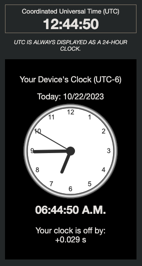

This is what Time.Gov showed about the MacStudio's clock after the computer had been been on standy for about 8 hours.

From Big Sur onwards, the way macOS synchronises the time has changed. If you leave your Mac asleep, occasionally, when it wakes up, the time will be far enough off that FT4/FT8 will not work properly. The native OS will bring the clock back in but it will take a while, it's not instant.

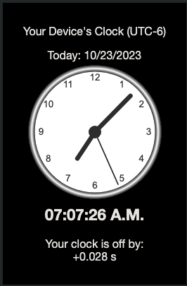

Yes I know all of this. Until I discovered Official US Time and its "Device Check" I did not have a handle on how accurate the clock is sync is maintained on at least with Sonoma, apparently this was not the case with macOS's that preceded this one, High Sierra being singled out. I come from the decades of living in the MicroSoft OS world. It's time keeping seemed to get worse as each successive OS waddled onto the stage.
My present clock sync.
Do you know how the web page calculates the offset? For me (in Australia) it is showing my clock in error by around 140mS.
I have always assumed that the sntp command gives a reasonable estimate - but I may well be wrong.
sntp commands give me:
sntp time.apple.com +0.002171 +/- 0.072773 time.apple.com 17.253.66.125
and similar values for other time servers.
So sntp gives a significantly different result to the NIST web page.
