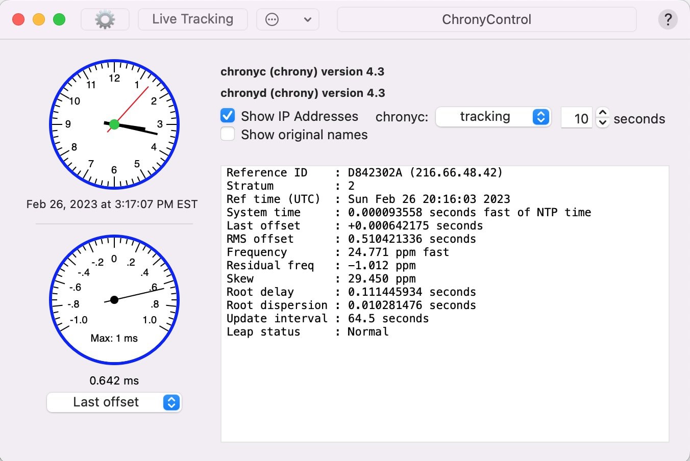

I am setting up my MacStudio to operate on the amatuer radio digital mode, FT-4, and FT-8. One of the requirements is precise time syncing. My Windows machines are awful in maintaining the precise time needed. There was a earlier thread about this subject on this issue and I seems the Mac has a similar issue. We are talking about fractions of a second needed for smooth packet exchanges. Chrony Control was suggested. I tried to load in on my Mac Studio and it locked up the Mac in a continual loop thing I had to physically turn the computer off, and restart to stop. Is there anything else. So Far I have not found a solution. The applications I have on My Windows machines are set to resync every couple of minutes, no doubt overkill but it does this in the background so why not.

I just tested ChronyControl v. 1.4.11 on my Mac Studio running Ventura and it seems to be working OK…but I don't know if there's something you're doing (settings etc.) that I'm not doing.
Were did you download ChronyControl from I tried it again and got the same result, and flickering locked up computer. I am running Sonoma 14.0. This is really disappointing ChronyControl seems to be the only thing out there.

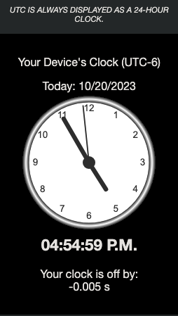

Curious question: how do you determine the offset that precisely?
The Time.Gov webpage does it for you.

I have a workable solution until Chrony Control is working with Sonoma.
I leave the Mac on the Apple time server and just uncheck the auto setting, set, and turn it back on. This is what I now have.

ChronyControl continues to run fine on my Intel Macs with macOS 14.0.
I am guessing that your problem is Apple silicon specific? And, guessing further, that the chronyd daemon is the problem. Can you get it running with Rosetta? Of course, these guesses may be wide of the mark.
This https://qso365.co.uk/2021/04/accura...c-running-macos-big-sur-for-ft8-ft4-and-wspr/ says it continues to run with Sonoma and Apple silicon.
