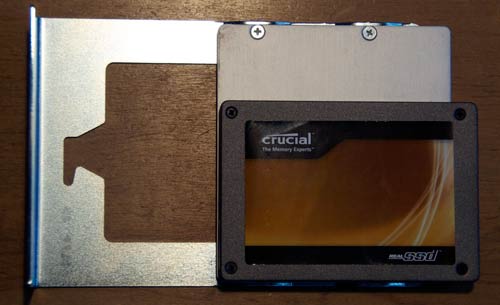

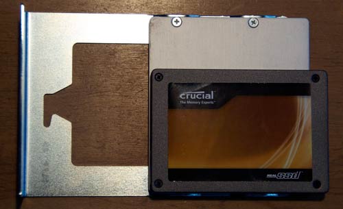

I sold 3 of the velociraptor adapter sleds. I don't have any more to sell,but I am trying to source some more. Here is what they look like with a ssd and a mac pro sled
to the moderators if I should not link this let me know. I am not quite sure how to post any photos on the site.
