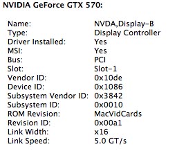

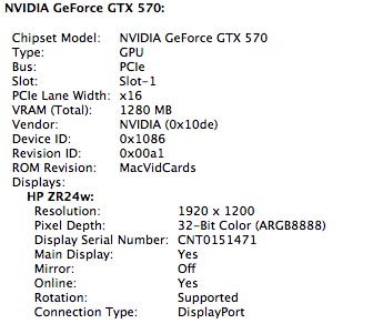

I have a Gigabyte (3 fan model) accelerated GTX570 in the classified section of this forum. It has been flashed by MVC, so it has a proper Macintosh boot screen. It was run in a 3,1 (2008) Mac Pro with good results. Let me know if you're interested.
Lou

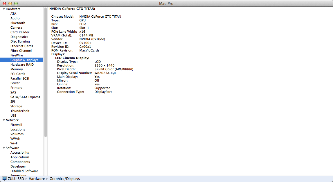

I have an over clocked GTX Titan flashed by MacVidCards. It has a boot screen, makes the 3,1 work much faster as far as graphics, and I have had no issues. I did have to buy an extra power supply.....but why don't you just get an officially compatible GTX 680 from EVGA? It just drops in, its power requirements are normal, and it will make your 3,1 perform much better. BTW, I know, we installed that card on a second 3,1 we own. We have a 3rd 3,1 running with the ATI Radeon HD 5770, and that one has no issued either with speed.
