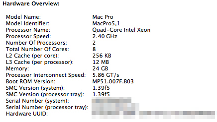

I'm really just reiterating what others suggested but hope this is specific enough to direct you to give some more details to help you with the issue(s). Screen shots are always helpful!
Take a look at the below screen shot (taken from google). Note that both the system and processor SMC version match. If you are telling us that your mac pros all have matching SMC's between system and processor then SMC mismatch is not the cause of the 100% full blast fan issue.
Just take note the below screen shot has the 2009 SMC version 1.39f5 (this mac pro was a 4,1 that got flashed to 5,1)
If you have true 2010/2012 model hardware then both SMC versions would be 1.39f11
