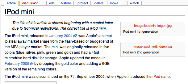

Other things are broken:
http://guides.macrumors.com/IPod_mini
notice the images... first letter needs to be capitalized.
