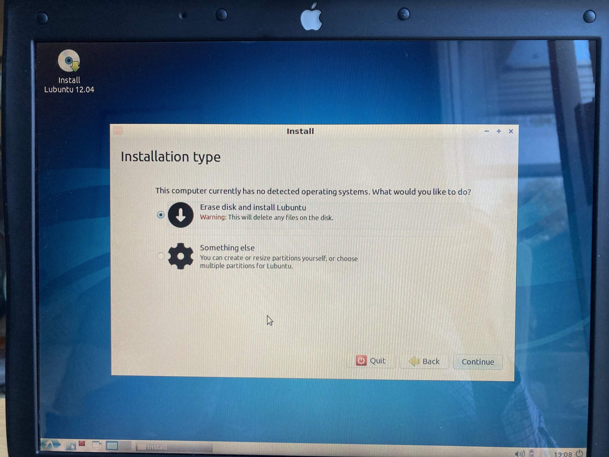

Well, following @Irontooth 's instructions above, I got the 12.04 remix V.2 CD to the desktop on my G4 Pismo 🙂
However, upon opening GParted to clear my Leopard partition and make space for installation, the whole drive (sda) was reported as unallocated, even though I could see Tiger and Leo in the file manager 🙁

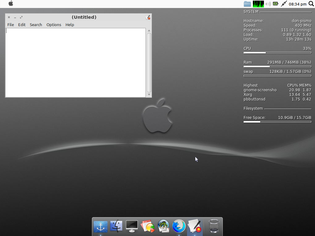

Oh yeah - I used a screenshot of my 2011 Macbook Pro running High Sierra to get a 'modern' Apple logo for the applications menu, and I have Catfish installed showing in the menubar, put the window widgets on the left side, and am using a desktop background that I've used over the years in Tiger.

Well, that was an interesting exercise in futility - my firewire DVD drive also refuses to boot Linux DVDs, even though I know it will boot anything else.
So, I booted to my iPartition DVD with no problem, using the Pismo's own drive, and zapped the Leopard partition.
I then booted to 12.04 V.2 remix CD, and tried to install...
Could it be that the OS9 drivers on the SSD for the Classic environment are throwing things out? or the SSD itself?
It is actually detected, mounted and I can see the files for Tiger in the file manager, but both GParted and the installer see the whole drive as unallocated.
I'm going to give up for now as I don't want to erase Tiger since it's working so well.

Strange. It might be an ssd thing now that I think about it. Had the same issue on my donated PowerBook which has an ssd in it. However, I did end up wiping the whole drive and it installed hassle free.

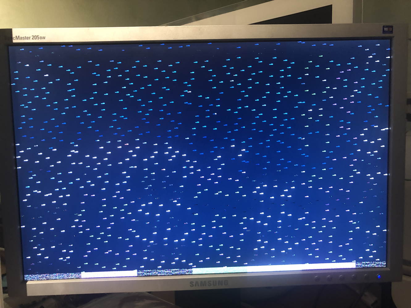

Im going crazy
7800GS (flashed PC) sometimes hanging on shut down
X800 not supported
Now i have a 6800 Ultra for my G5 and also no luck on Ubuntu (if I get this to work i will test Void)

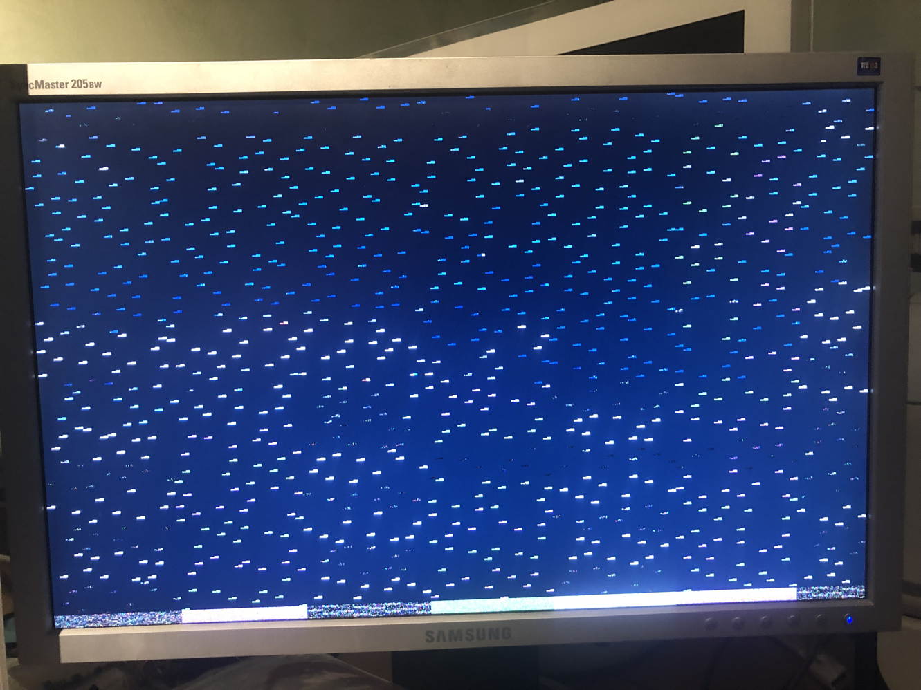

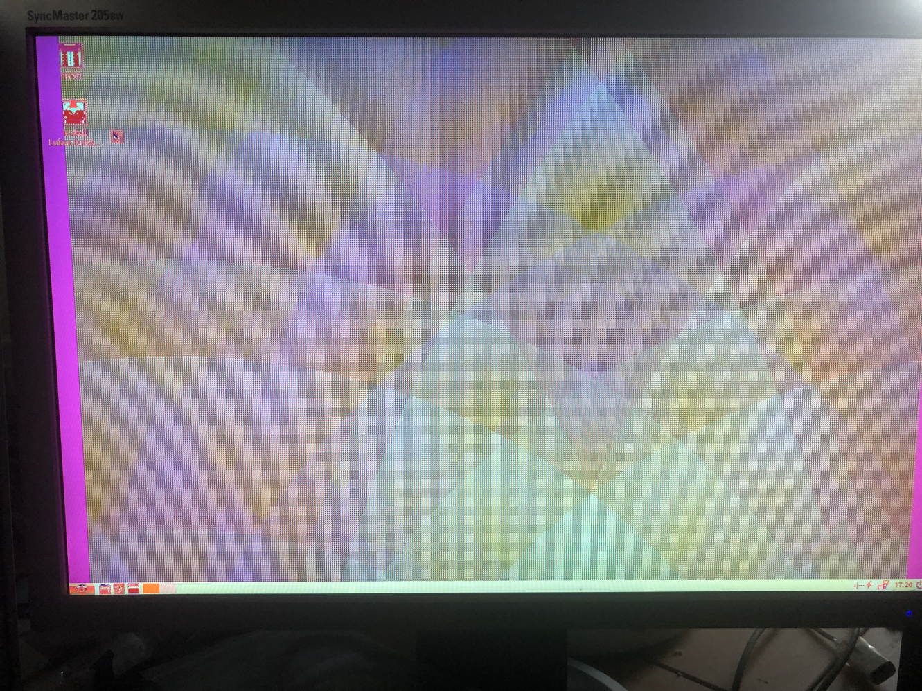

live video=TV-1:d video=TV-2:d video=offb😱ff nosplash I get this:

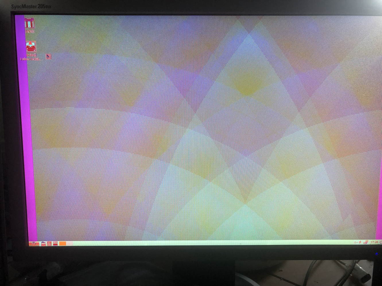

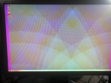

with nouveau.modeset=0 I will get a working screen but with wrong colors
Any suggestions?
@TsunamiOsx if i remember correctly the 6800 Ultra functioned well with Debian Wheezy, however needed a modified kernel to function on Debian Jessie. Much time has passed since then, but Linux on PPC still seems tricky with regards to getting graphic cards to behave as desired.
