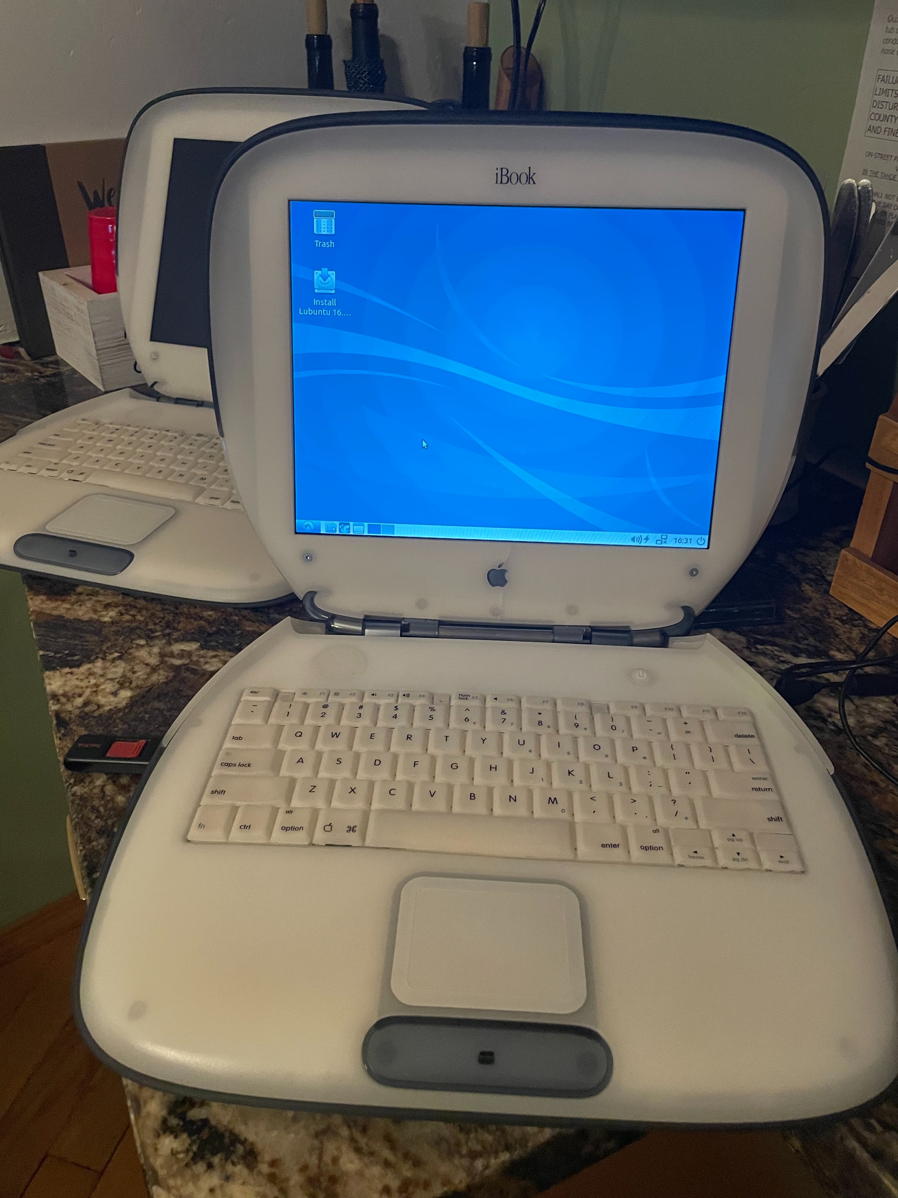

I saw many folks struggling to get USB booting to work, and I'm happy to report that I was able to write the 16.04 remix image to a USB drive using dd on modern macOS 14 and boot using the 2023 NEW probe-usb method on my iBook G3 clamshell. Here are my steps.
1. Download the 16.04 V2 remix ISO from here on your modern macOS machine
2. Plug your USB drive in and figure out which /dev/diskX device number is your thumb drive by running diskutil list
3. Run the following command, replacing X with your thumb drive's device number:
sudo dd if=~/Downloads/lubuntu-16.04-remix-v2-ppc.iso of=/dev/rdiskX bs=1
4. Plug the USB drive into your iBook
5. Boot your iBook and hold Command + Option + O + F to enter OpenFirmware
6. Run the following command (refer to the 2023 NEW Method guide):
probe-usb boot usb0/disk:2,\\:tbxi
7. Just hit enter to boot live and everything works (albeit quite slow!)
Of course, this will work on other Macs, just try usb0, usb1, etc or refer to the 2023 NEW Method guide's instructions to do it systematically. This is very similar to the guide I made to install Mac OS X Tiger on iBooks, basically the same steps. Enjoy!

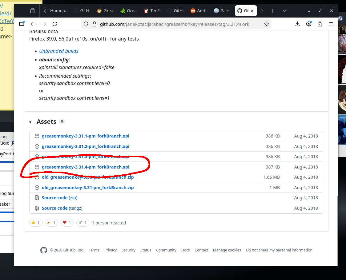

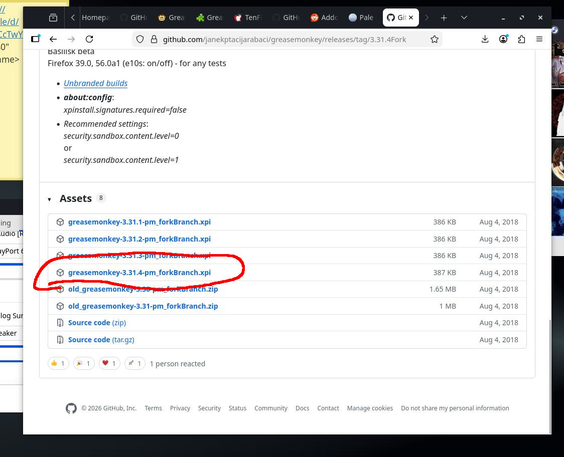

Thanks for that but, I have been trying to get Greasemonkey to utilize Youtube for my G4 sunflower but without success. What I need is instructions as how to proceed.
Thank you but, when I go Palemoon - Greasemonkey- Git site I cant find any way of downloading Greasemonkey. No download available, nothing. I don't get it at all.

It’s been a few years since i used it. Things may have changed, but the Hyperion guys seem to have it working yet. Did you go in to viewtubes settings (the hamburger menu next to the play button) and make the proper adjustments as shown in the screenshot? Did you install mozplugger and/or browser-plugin-vlc? Did you change the user agent override for youtube to a mobile UA?
Yay, thanks for that, I reset the options in the hamburger menu. Fantastic.

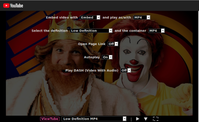

Also is there a way to save all the viewtube specs. Whenever I turn off the comp and I have to start all over again and now I cant play any youtube videos?
It should remember your settings. However, if i recall correctly, Arctic Fox by default is set to “private browsing” mode by default. Go in to preferences and set it to remember history, enable cookies, etc. Then your viewtube settings should be saved between reboots.

Thanks for that but I can't seem to get back to a working youtube/Viewtube. Try as I might even reinstalled Lubuntu Remix and gone through all the requirements ie. Mozplugger - Greasemonkey - Viewtube - Viewtube script and the Viewtube settings. I just cant get Viewtube to play, tried many times without success. I must be missing something. It was working perfectly the first time. Working now .. complete new re-install and used whole disk, following Wicknix's instructions.
