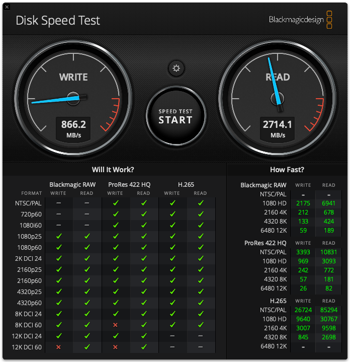

The performance of the drive is disappointing:
Especially compared to the internal SSD which I expected to be much slower:

Performance on a 2019 Intel iMac is about the same.
What have I done wrong here, or is that the best I can expect?

I've tried three different Thunderbolt cables with the same result. That particular Samsung drive and Orico enclosure were recommended as an external boot drive for a M2 Mac mini to improve performance. In that environment BlackMagic read and write speeds were both about 2700 MB/s.
Perhaps it's an M1 Problem. And, yes, there are reports of slow read/write speeds with external drives on M1 based Macs.

However, it still doesn't explain why my write speed suffers so when using the exact same drive, enclosure and hub that he has.

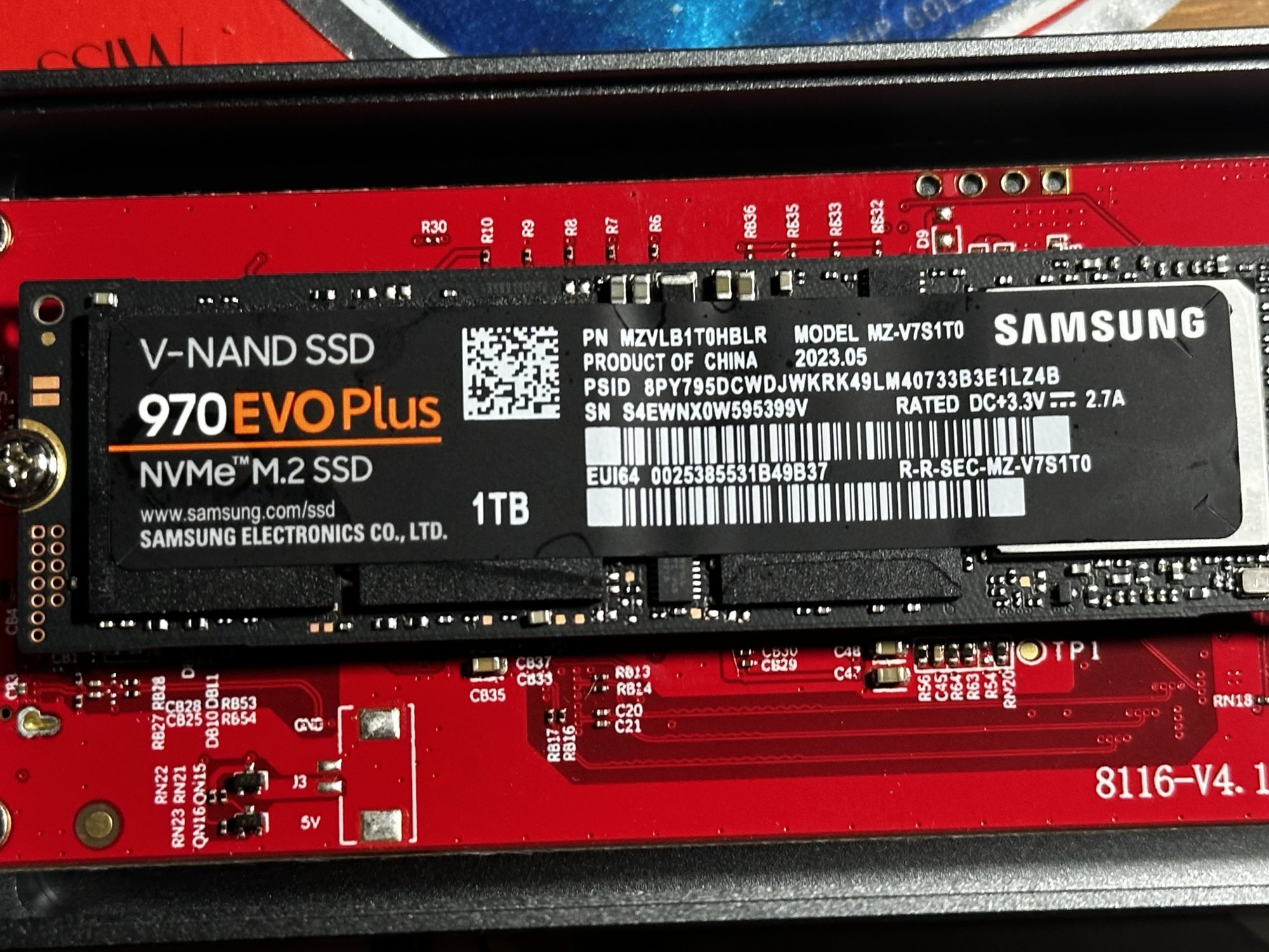

I have the older version: MZVLB1T0HBLR. But it performs poorly with my M1 MBA. But it also performed poorly with an Intel iMac; so it's apparently not chip incompatibility.
I'm now completely baffled.
Another thing that confuses me:
The part number on my drive is the old version (MZVLB1T0HBLR), but the manufacture date of 2023.05 is quite some time after Samsung supposedly changed the part number to MZVL21T0HBLU.
