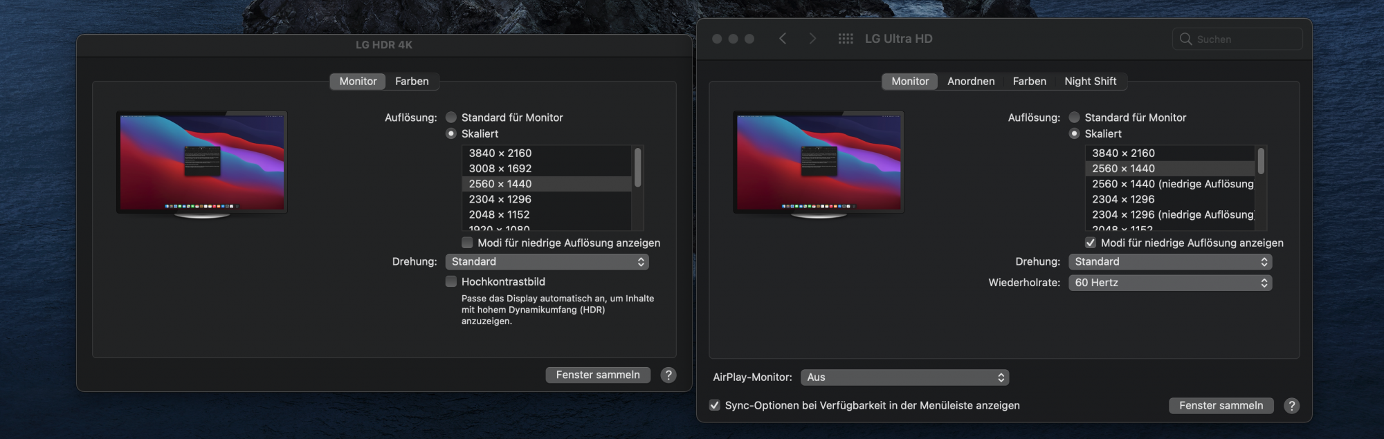

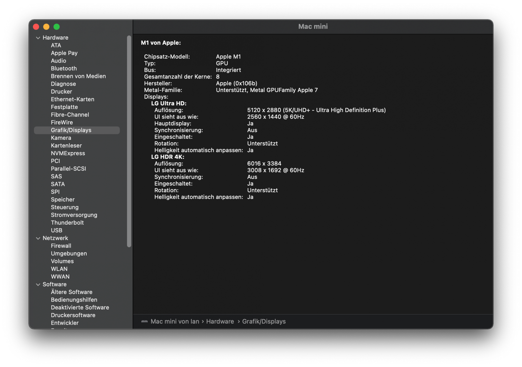

I just received my new M1 Mac mini but I have some strange issues with my monitors.
Since I have two LG 4k displays, I have to run one over USB C -> Displayport and one via HDMI.
Somehow it's showing a different resolution on both of them.

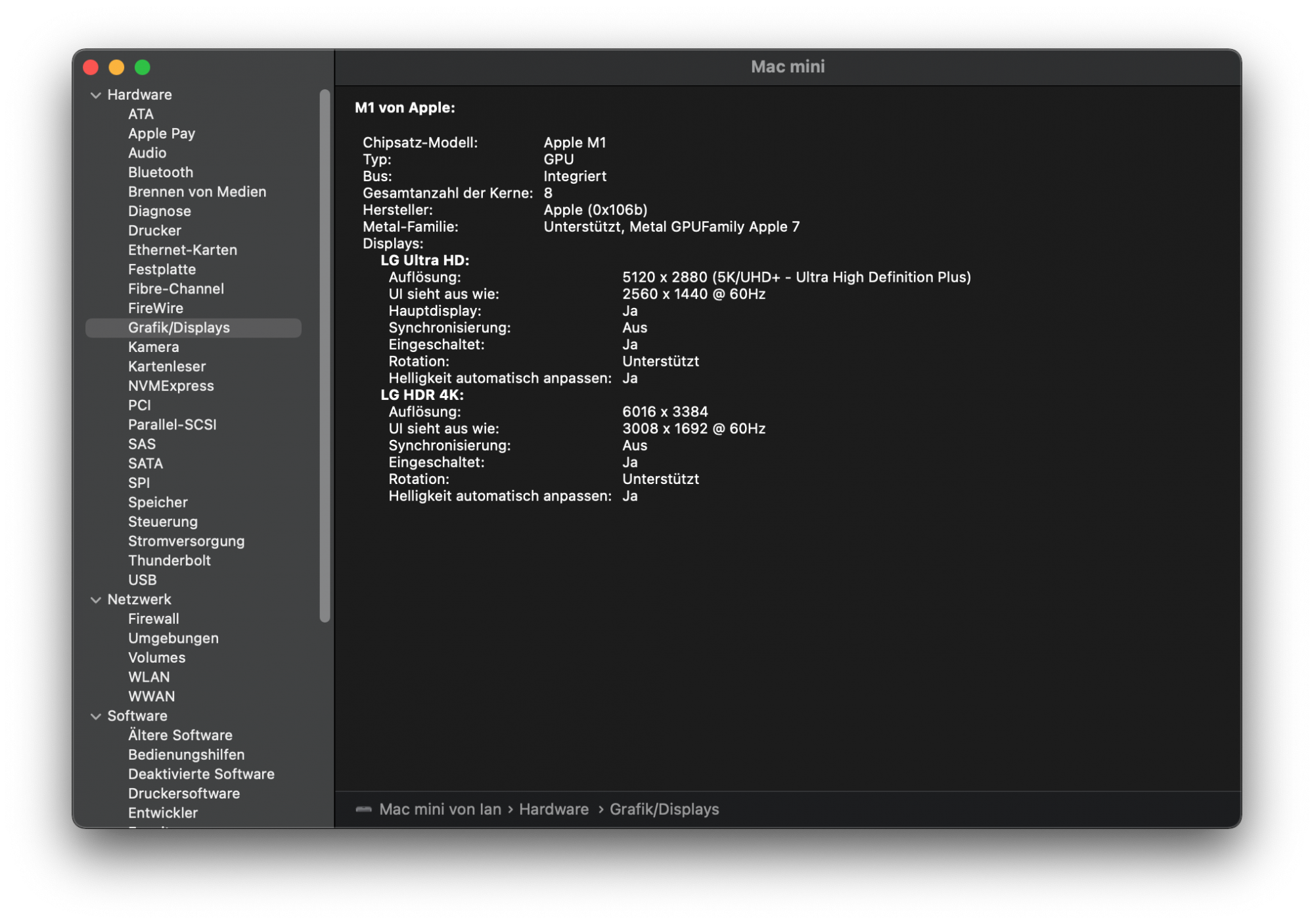

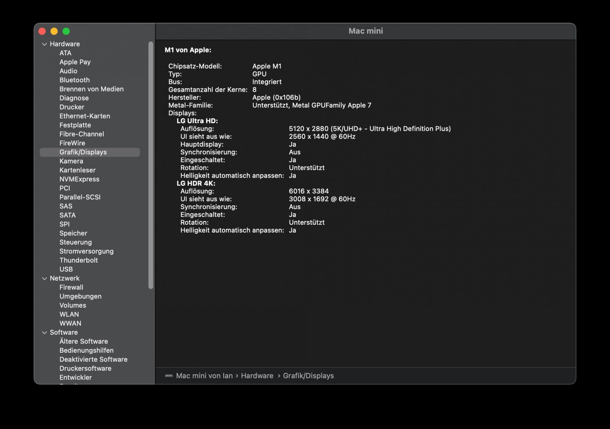

I'd like them to be in scaled 3008 x 1692 mode, but It's only visible on the second screen, which is plugged in to a USB C to Displayport cable.
And the system report shows a completely different resolution for them as well.
Does anyone have an idea?

yep, it's high speed capable.
I have the same resolution with my 4k LG display via HDMI. Max 2560x1440 in HiDPI.
Meanwhile via thunderbolt/usb-c I can have 3008x1692.
I think it depends by the limit of the HDMI port of the Mac Mini M1, it is HDMI 2.0 and not 2.1.
But the physical resolution is the same, so I don't think it's related to HDMI 2.0 vs 2.1
it is correct but as you well know to get the resolution of 3008x1692 in HiDIP what apple does is to scale to 6016x3384 and then divide it by 2. So this scaled resolution in my opinion exceeds that supported by HDMI 2.0.
I know it's strange because even the 2560x1440 HiDPI resolution exceeds but at the moment it's the only reason I've found reading the other posts.
I hope there is a way to fix this, since 2560x1440 is too large for me, I'd prefer having more space

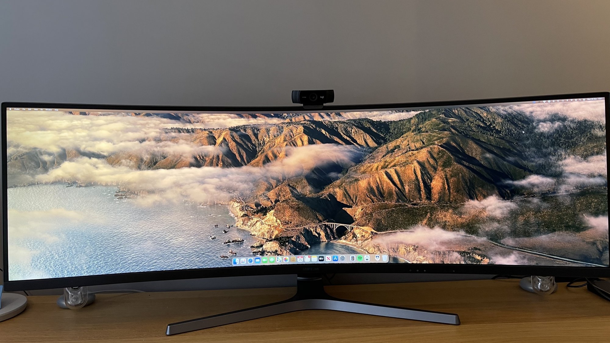

I have a 2018 Mini running 5220x1440 using a single DP cable on a Samsung ultra wide C49

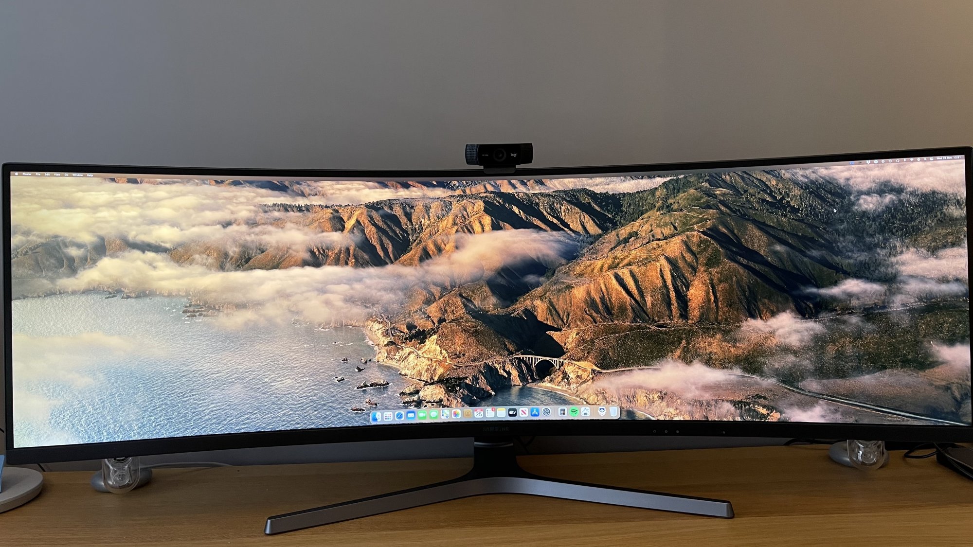

Today my M1 Mini arrived. I unplugged my 2018 Mini and plugged the same cables into the M1. It took me over an hour just to get any picture at all!
I have a Samsung 49” ultrawide.
To fix the issue I set the DisplayPort settings on the monitor to V1.2 and changed the refresh rate to 60. Now I get 5220x1440 on a M1 Mini with 1 DisplayPort cable.
Reactions: ivanwi11iams

Identical.
A couple of abnormalities though - I try and sort them over the coming days....
  1. On the M1 the resolution shows as “5220x1440 low resolution”. On the intel it shows as “5220x1440”. I can see absolutely no difference whatsoever.
  2. After switching users or after a reboot the display settings page shows as lower resolution although it clearly isn’t. It’s still 5220x1440. Pressing CTRL on the display page shows the “detect displays” menu and sometimes it’s shows 5220x1440 and sometimes it doesn’t but as I’ve said before it is definitely in 5220x1440 all the time.
My question is what is the difference between “5220x1440” and “5220x1440 low resolution”. They look identical to me.

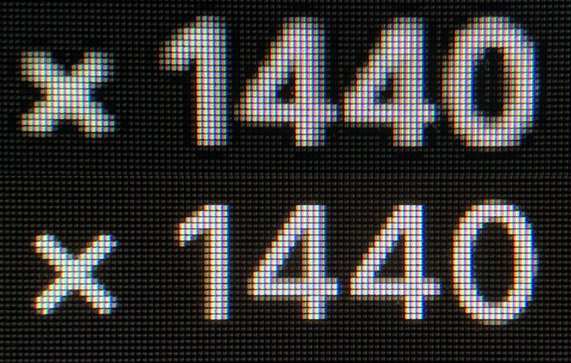

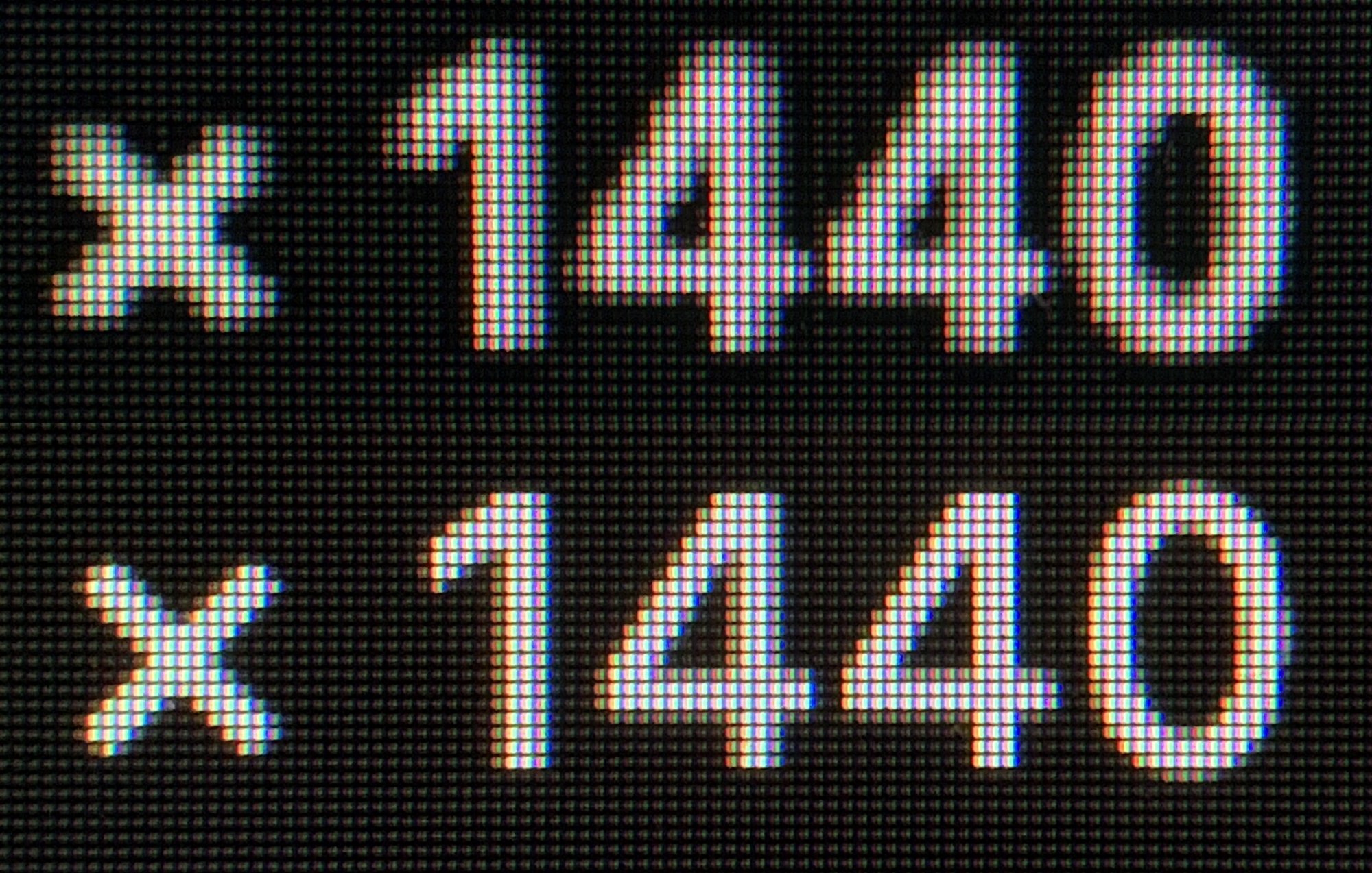

I'm running an LG 27" 5k, and when I click between the 2560x1440 and 2560x1440 (low resolution), I definitely see a difference in the quality.
it's the pixel density that's been referred to. The 5k LG has a ppi of 217.57, whereas the Samsung C49 has 88 (from Toms Hardware site).
If you don't see a difference, then send the data to your screen in low resolution mode. That'll save processor cycles.
