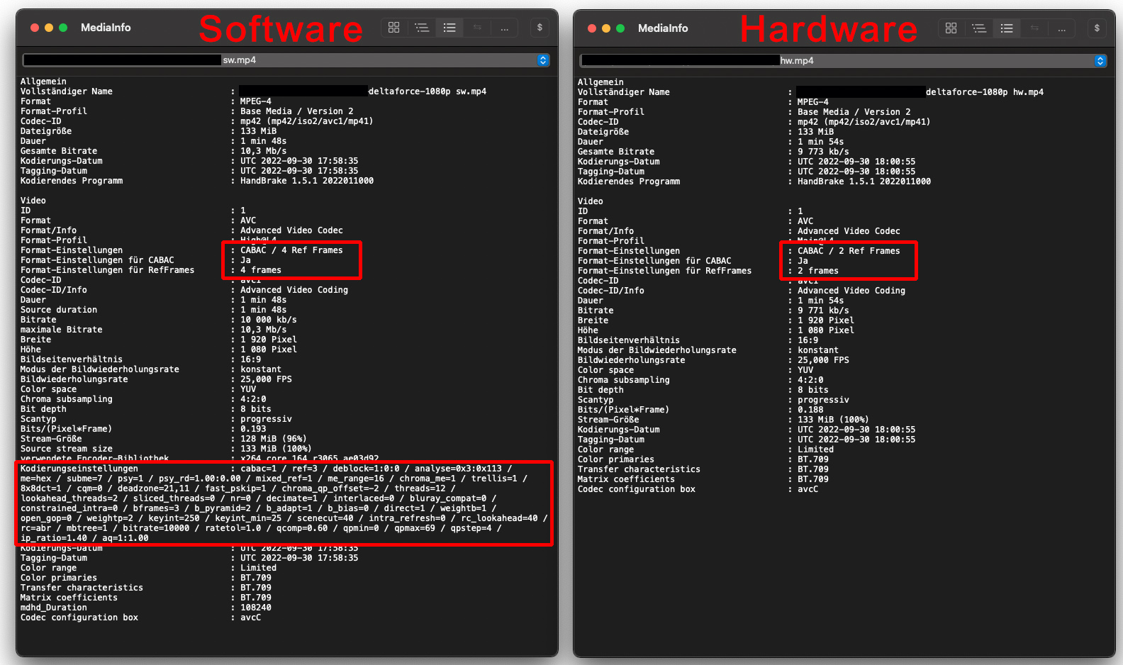

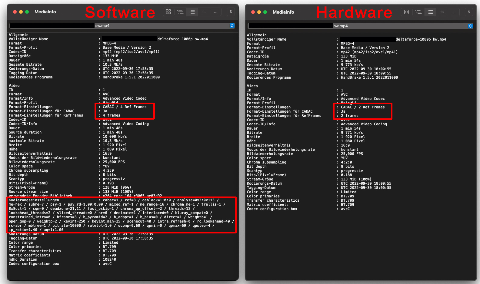

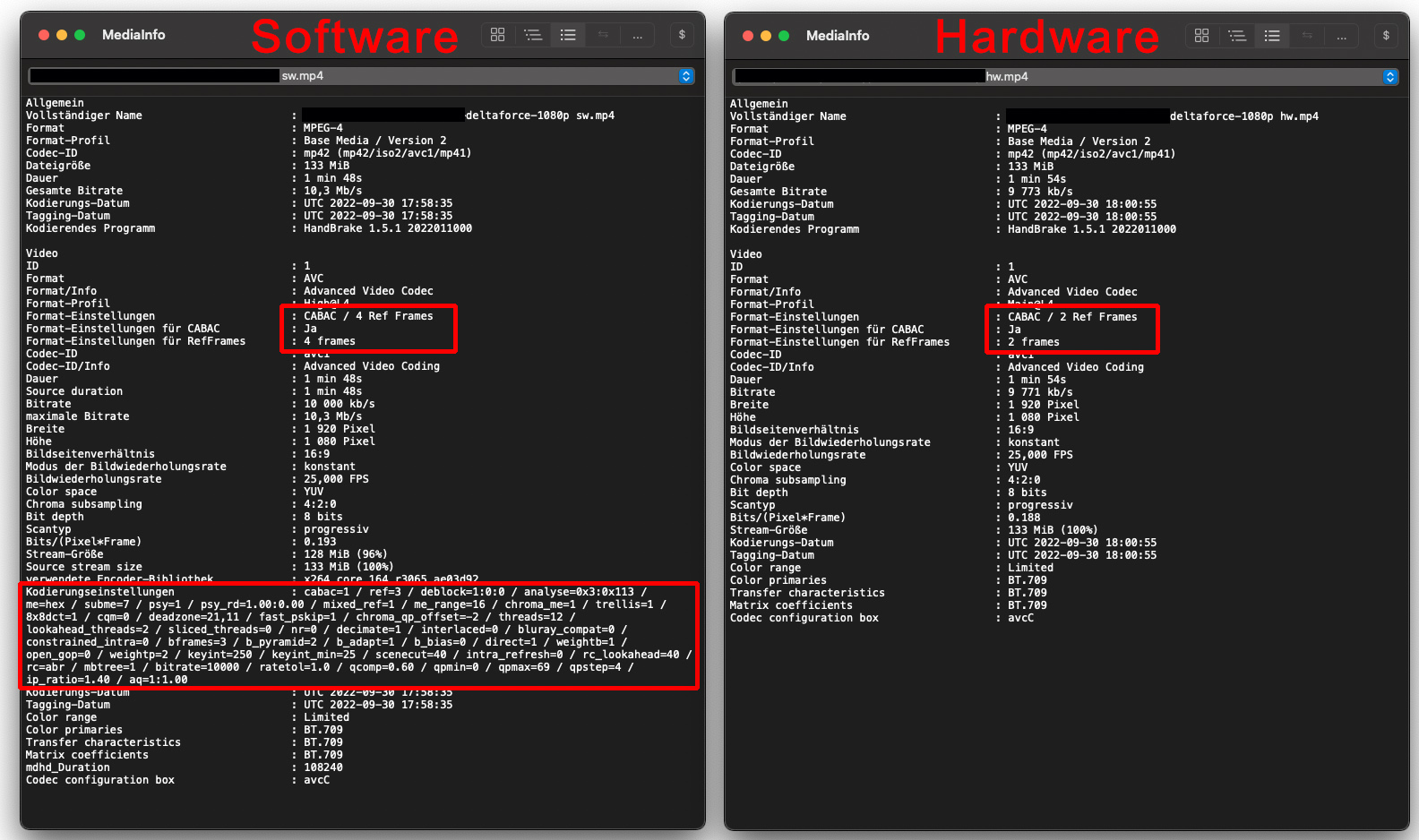

Because the hardware encoder is using completely different settings for example RefFrames

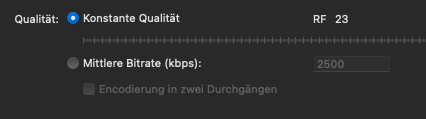

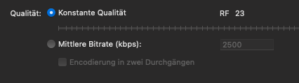

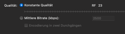

did you work with quality or bitrate settings?
RF (software) and CQ (hardware) are also different.
both with 10000 kbps bitrate:
yes, I played around to get similar qualities from both but non-scientifically. Just with my eyeballs 🙂
