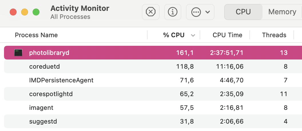

Have you looked at Activity Monitor? My M3 is only getting hot there when the same 5-6 processes go crazy every day and I have to force quit them three times. I thought it's a Beta thing, but maybe it's more iMac related. It's not even warm if this isn't happening.
Looks like this and it happens without doing anything. Every time I looked for those when I not get warned by a menu bar app they all have 0.0% CPU usage.
That's the Photos app scanning your library for faces and other items you can search for in the app. The process is essentially always running but should only use start doing heavy loads once the computer is idle and not doing other tasks. If you have a large photo library the scanning can take weeks, with more time needed each time new photos are added.

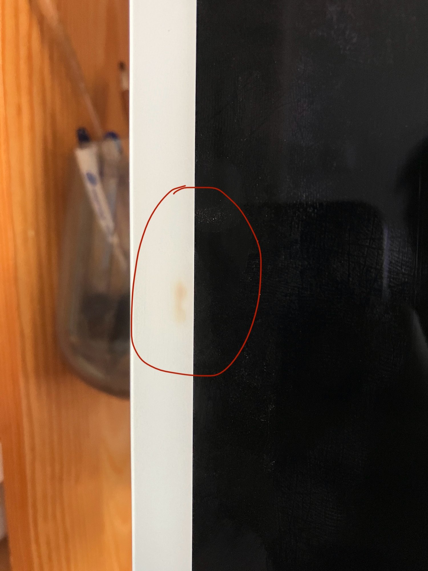

I'm also a victim of this issue. I've been using my iMac for 2.5 years before this issue occurred.
10 minutes ago, my screen blacked out and it is now completely dead.
The answer given by Joptap62 on Apple's forum under this thread is fairly accurate.
"The problem, apparently, lies in a cable that also powers the LCD...this cable (of the FFC/FPC type or Flat Flexible Cable / Flexible Printed Circuit), it has to sustain a very high voltage (around 50V) to power the LCD (this despite the iMac's power supply being 15.9V), and it heats up a lot!"
What happens next is that the rim becomes super hot when the iMac is switched on regardless of the brightness of the screen. There's a burn mark at the rim and I believe there's a short circuit inside. The screen now dies after 3 weeks.
I hope that Apple can offer a service program on this issue. My previous iMac lasts for 5 years before a hard disk failure.
I do look at Activity Monitor if things are getting hot. Looks to me like your photo library is syncing and your spotlight is indexing. None of that is specific to the iMac, trust me.

Is this the left of the screen when facing it or the right? Upper left or top corner. The picture looks confusing to me.
Left of the screen. The left rim above the burn mark is super hot and the burn mark is the hottest spot.
The right side of the screen is at room temperature.
Got it. I took my Temp Measuring thing and measured the temperature on my iMac M3. It's been on constantly for the last 3 hours. The temperature is 85F on the left side. I also measured the top left corner area, it registered 87F at the hottest point. Along the very top of the screen its up to 88 then cools back down. Now I have sensitivity to brightness on computer screens so I keep my display a little bit more than halfway point. Anything brighter hurts my eyes. So it's about 55% brightness. Maybe thats why the temperature is not so hot.

I'm not sure about the M3 since no one has taken it apart to compare the components. For the M1, I have zero confidence many will last 3-5 years. Sooner or later it will fail since it doesn't look like a component defect, but rather a design defect.
Related explanation from Apple Community forums.
The explanation I was given was as follows:
In terms of circuitry, everything seems to be working properly.
The problem, apparently, lies in a cable that also powers the LCD, which is located on one of the tops of the screen, and which, in order to be replaced, requires detaching the screen glass from the LCD itself, which is a very sensitive operation and almost impossible to carry out without damaging the LCD.
So the only option is to replace the entire LCD (LCD+main boards+screen glass).
Also, according to the technician's explanation, this cable (of the FFC/FPC type or Flat Flexible Cable / Flexible Printed Circuit), it has to sustain a very high voltage (around 50V) to power the LCD (this despite the iMac's power supply being 15.9V), and it heats up a lot!
So, what happens after a while (in this case after about 2 years) is that it starts to burn out and degrade at the connector, to the point where it lets the signals leak between the various connectors and short-circuits some of them, which ends up causing those lines that we are all unfortunately familiar with.
The level of brightness makes a fundamental contribution to this problem. Thus, the higher the brightness used, the sooner the problem occurs.
This is easily understood by measuring the difference in temperature at the top of the screen when it is at its lowest brightness level, compared to when it is at its highest. It's quite a big difference!
When it's at its lowest brightness, it's practically room temperature; when it's at its highest, you can almost "fry an egg"!
I think that as soon as Apple recognizes that there is a problem with these computers, the first thing it will do is make a change to the OS that reduces the maximum brightness limit allowed (to less than 500 nits). Time will tell...
