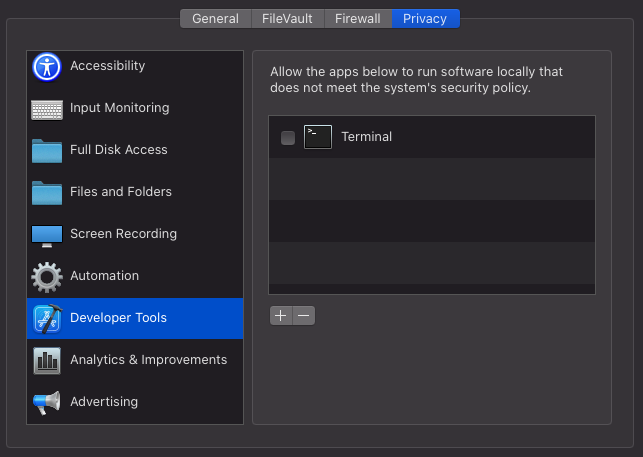

SOLVED.
My replication steps only work when my terminal emulator (iTerm/Terminal) was in added in "Developer Tools" section of Security & Privacy settings in macOS.
Removed them and I could not longer replicate.
This looks to be a bug in codesign/watchdogd/adhoc signatures. Where you remove the terminal from dev tools, you can see the signature check is performed and all is well.
If you have terminal in the "developer tools" category, certain tools (like the ones I describe in my post, ruby/pip), cause the OS to panic on reboot, as something ends up hanging.
Described further here: https://sigpipe.macromates.com/2020/macos-catalina-slow-by-design/

The problem with removing the terminal from dev tools is now every command line tool needs to be signed. That can be a pain. I haven’t had any kernel panics that I can attribute to being in the dev tools section of privacy. I hope Apple can track down your panic issue and fix it.

So actually it doesn’t have to be signed.
it’s running an OSCP check, but signature isn’t required. It’s more a Gatekeeper check for know malware.
Execution slow down is only on first run then cached.
So not a big deal.

I bet you have your terminal added as a "Developer Tool" under System Preferences -> Security & Privacy
I'll be the first unfortunate to volunteer that this fix does NOT work for me. I'm also an iTerm2 user, but it was never listed in the Developer Tools list. I get watchdog kernel panics almost every time the laptop goes to sleep for more than 4 hours.
