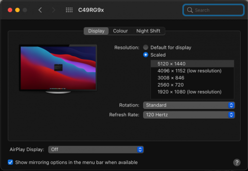

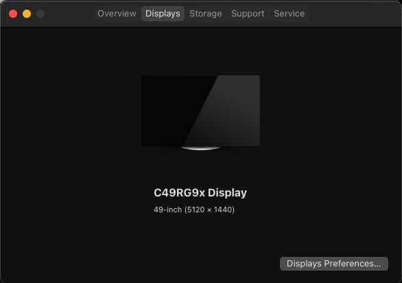

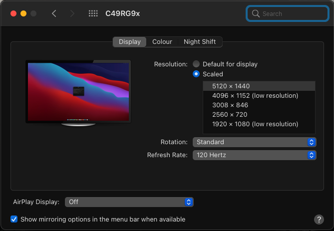

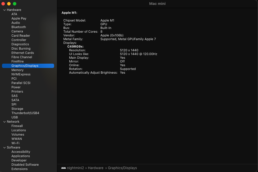

Just got my Samsung C49, hooked it up via TB3->DP Adapter + DP cable (all rated for 8K60Hz) - booted up into macOS - was automatically set to 5120x1440 - only had to switch from 60 to 120Hz in the dropdown menu, didn't do anything else.
After first shutdown behaved a bit flaky, but after setting the DP-Version "down" to 1.2 everything worked nicely (even though 5120x1440@120HZ is supposed to need about 26Gbit and DP 1.2 only delivers about 17Gbit it's working without hiccups...
When set to 60Hz I can also choose HDR in Display settings

today I upgraded my Samsung's firmware to Version 1007.2 - immediately lost all issues. Screen wakes up as intended even when running 5120x1440 @ 120Hz @ DP 1.4. For fun 5120x1440@100Hz@ DP1.4 WITH HDR works as well ! Firmware-Upgrade taken from here:
Hope it works in general
