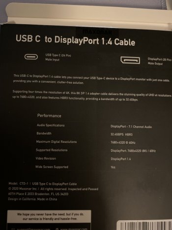

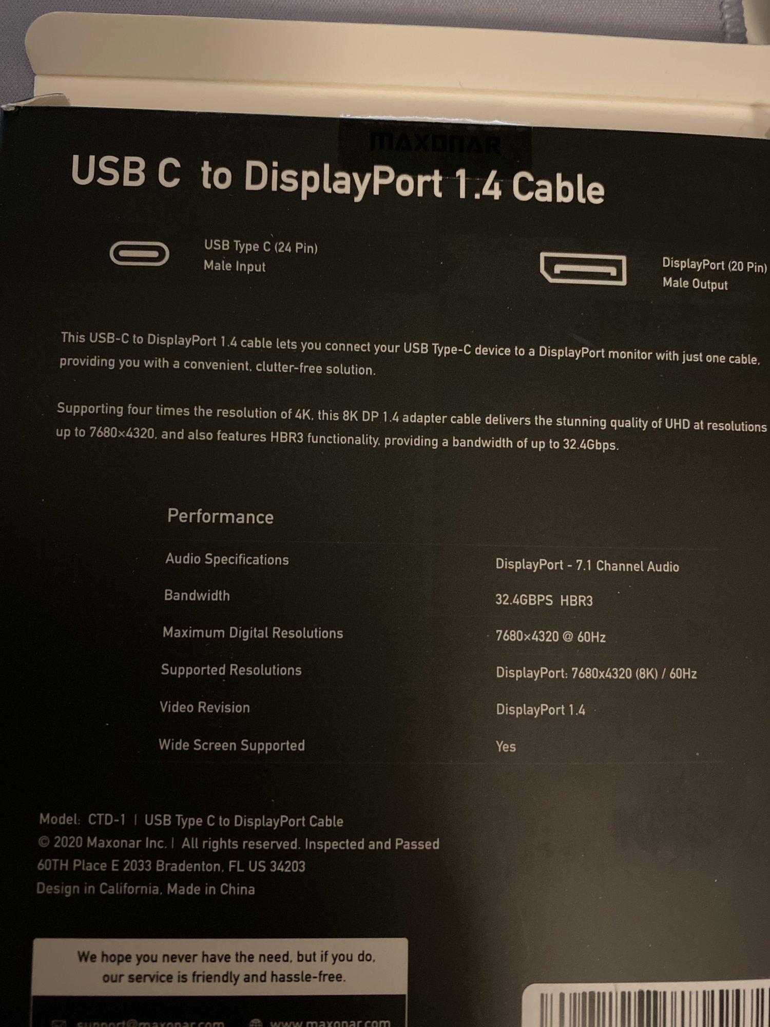

Yep as Jeff, does not work with 2 cables I got from Amazon too. One said 8k but no go.
not spending £50 for the moshi cable
I used this one
