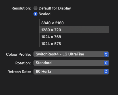

I just purchased the M1 mini and it does not support two LG UF 4K monitors despite Apple's website at least implying that it does. The Siig adapter did not work. Apple suggested I buy the Belkin adapter it sells. Didn't work either. Now I was just told the only way the HDMI port will work if the monitor has an HDMI port, i.e. no adapter.
Did you make sure to use a USB-C cable and NOT a Thunderbolt cable? That was my first issue with the Siig adapter, but there will be missing resolutions once you get the display to come on.
@ Simcoxjt -> How were you able to get both monitors running @ 2304x1296? My second (Connected to the Siig) jumps right over the resolution you are using. I'm stuck with either 1280*720 (super blurry) or 3840*2160 (so small the content is impossible to see). My primary is connected @ 1920*1080, but I have a wide range of options to choose from, working just fine.

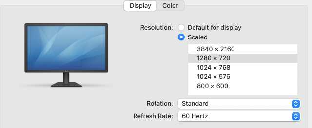

I'm on the 11.3 Public Beta and running 2x LG 4k Ultra Fine Displays, same setup as you I believe, on an M1 Mac mini
I only got it working once I found a way to roll back to 11.0.1, it seems display resolutions for some HDMI and USB-C connected displays is still an issue. It was broken by 11.1, not fixed in 11.2, and looking like it won't be fixed in 11.3. The issue isn't even isolated to those using M1 macs or those using adapters. It just seems that 4k or >4k monitors that don't use Thunderbolt are likely to be missing resolutions or their native resolution isn't detected properly.

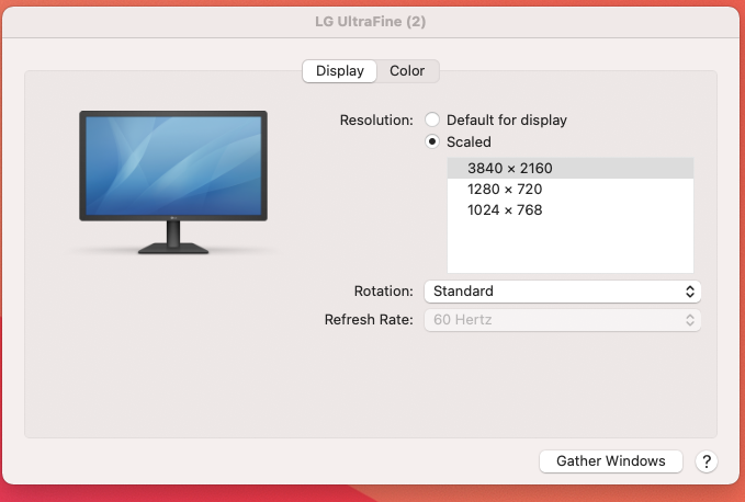

11.3 Beta 7, still no change to available resolutions. Anyone able to engineer a workaround for this yet?
Super odd that the second display, via this setup can easily display 3840 x 2180 all the way down to 1024 x 768, but is missing so many of the key ones in the middle. I wonder where in the software this disconnect lives and if this is even on the radar/roadmap to be addressed since the situation seems unique to these "Siig USB-C to HDMI adapter" setups.

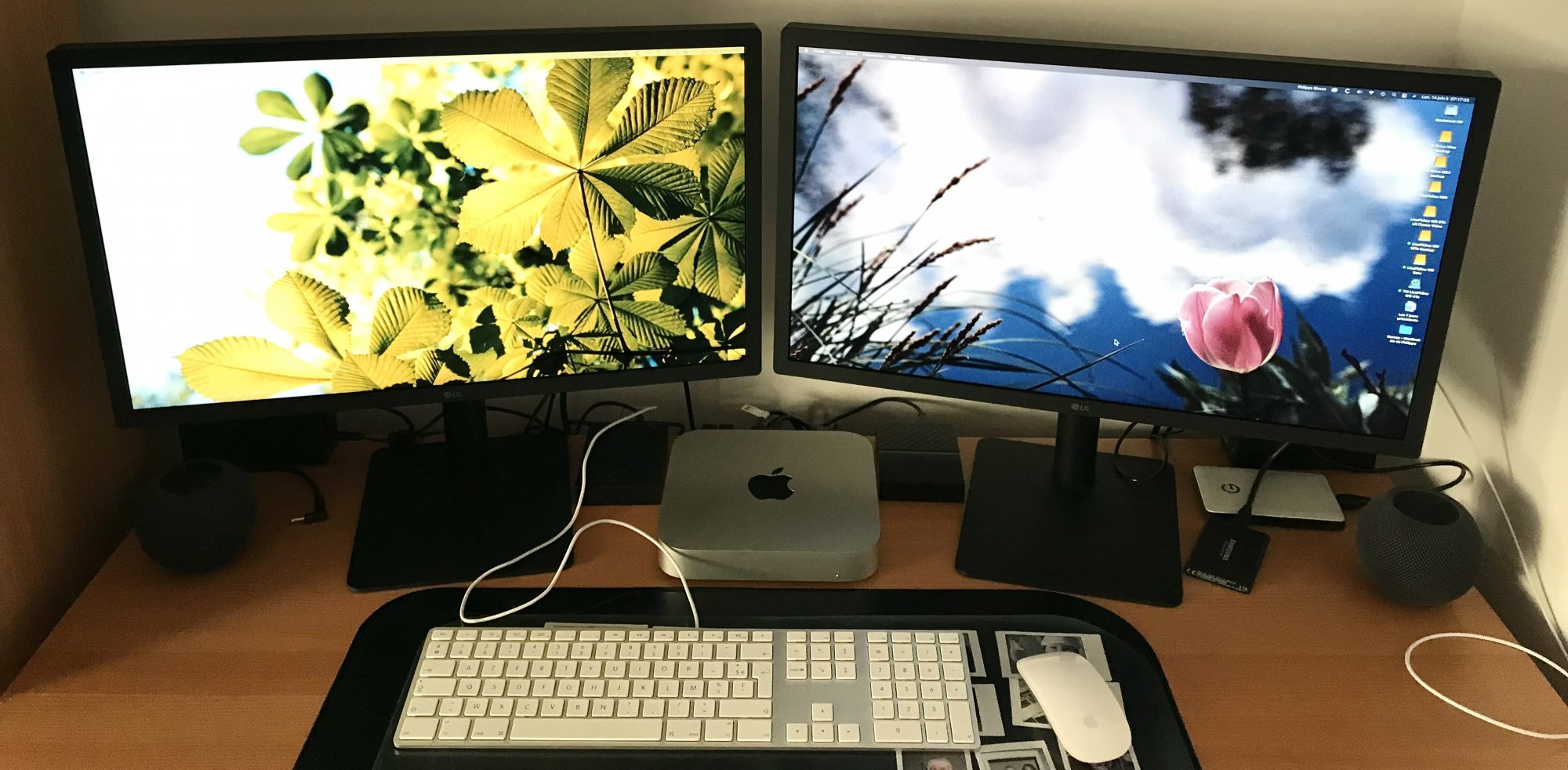

So this is my setup : Mac mini M1 16GB 1TB + dual LG Ultrafine 24'' for Mac 24MD4KL-B.
It was quite difficult to make them run together in HiDPI mode.
Right here I am emulating 218 dpi with a working resolution of 2304 x 1296 (virtual resolution is 4608 x 2592) on both monitors
Everything is super sharp (texts and images)
So what to I need ?
An active adaptor from Club3D : HDMI to USB-C. Around 50€ in Europe.
Then set as primary monitor in preference plane the Ultrafine connected to Thunderbolt 3 with the Thunderbolt 3 cable included with the LG.
Last set as secondary monitor the one connected to HDMI to USB-C adaptor with the USB-C cable included with the LG
Like that preference plane will give access to HiDPI (scaled mode) for both monitors. And it will remember it.
Then enjoy dual 4K 24" with your Mac mini M1.

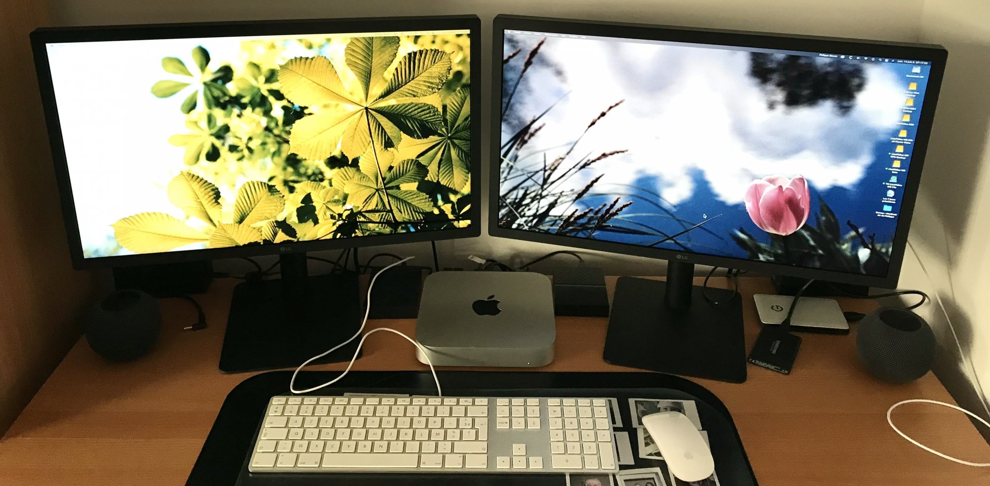

So what to I need ?
