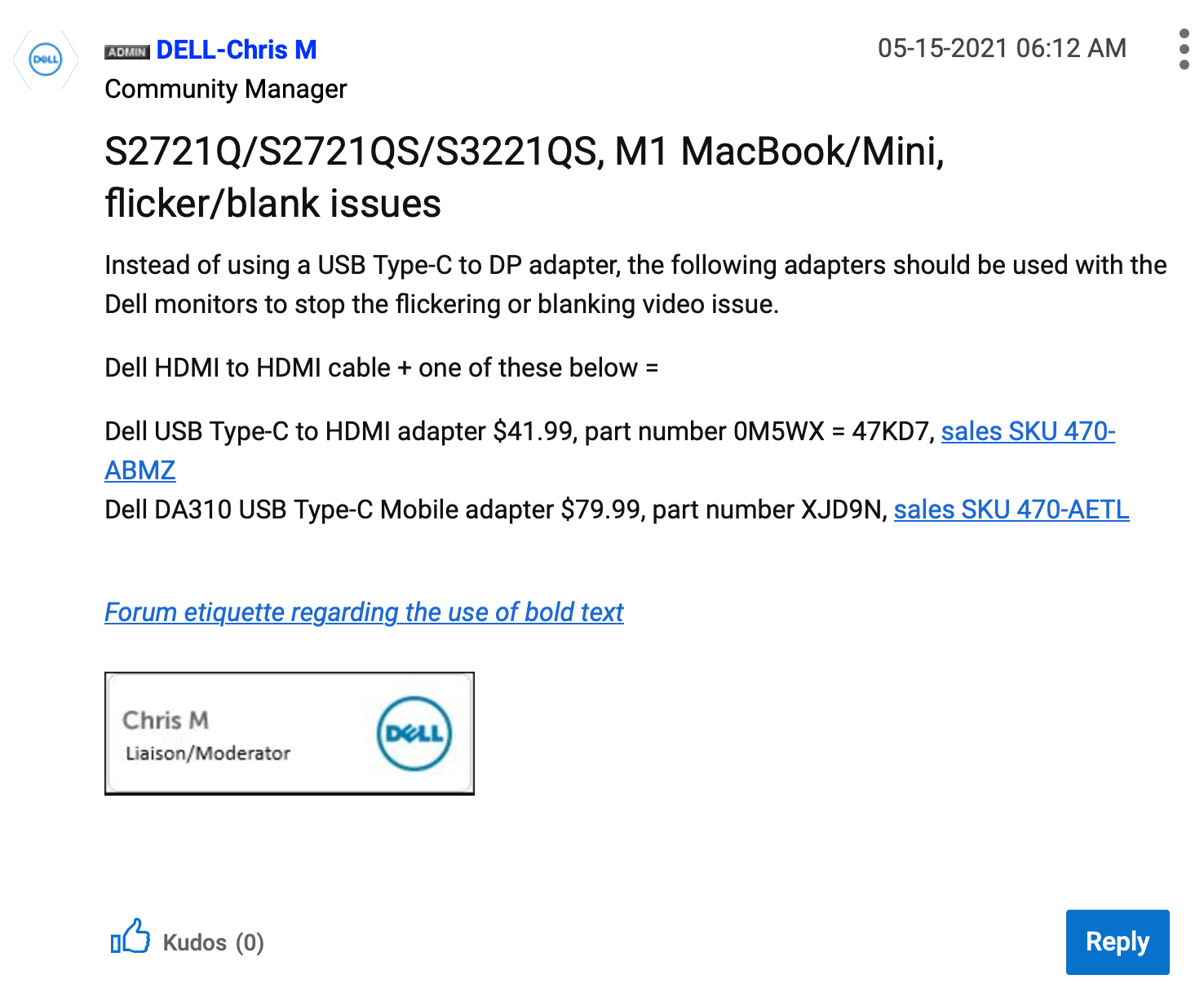

This is what I've found from Dell.
I really didn't think it would take me another extra 150€ on top of the Monitor just to use it properly ... Should have went with something else/more expensive to avoid this.
Tried a lot of stuff, ordering this adapter is the last resort. I will let you guys know how it goes.
