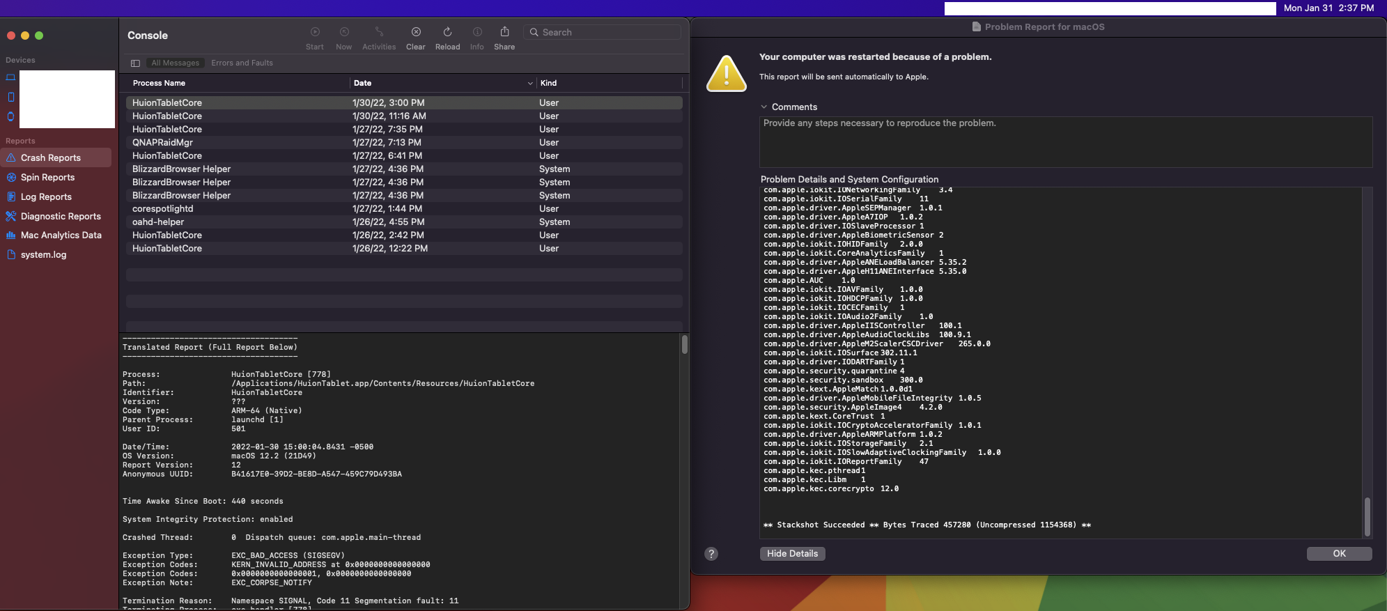

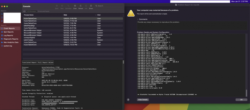

Just got a pink screen crash and yet nothing showed up on the console. The console is useless for this issue.
