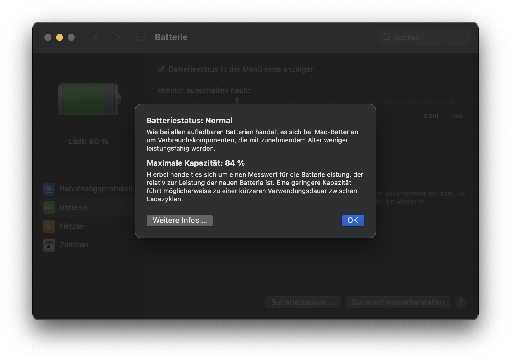

Hi, I've bought my new MacBook Air M1 at the end of November. I've now taken a look at battery health, and it says it is at a maximum capacity of 84%. Since Feb. 2021 I've been using AlDente at 79% because I mostly use the mac attached to a monitor and powered.
How can this happen, and is it normal?

I would say that isn't normal. Do you know how many charge cycles it has? You can find this using the System Information application. Normally accessed by using About This Mac and then the System Report button. Go to the power item in the left side list.
My battery has a cycle count of 40 and I'm still showing 100% on Apple's Battery Health system setting. Using the actual battery full charge ÷ design capacity, I'm down to 96.8%. I've had this M1 MacBook Air since launch day in November 2020.

Yeah, I've just looked at it and I'm at 45 cycles.
Battery condition information:
Number of cycles: 45
Condition: Good
Maximum capacity: 84

I would take that to the closest Apple Store to have it looked at. 84% after nine months and 45 cycles does not seem normal at all.

The battery is supposed to last about 1000 cycles. The capacity is way too low for only 45 cycles. Have Apple take a look and they will probably replace the battery as defective.

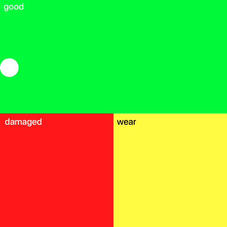

Final Update:
I have brought the Mac into an Apple Store. They ran their diagnose and showed some kind of graph like this:
As seen the battery is on a quick drop.
They say, they would usually only replace the battery, when it is in the red area. But as the genius himself saw the quite quick drop he said they could send it in for a free replacement.
The Mac arrived yesterday back home and it has been all good.
