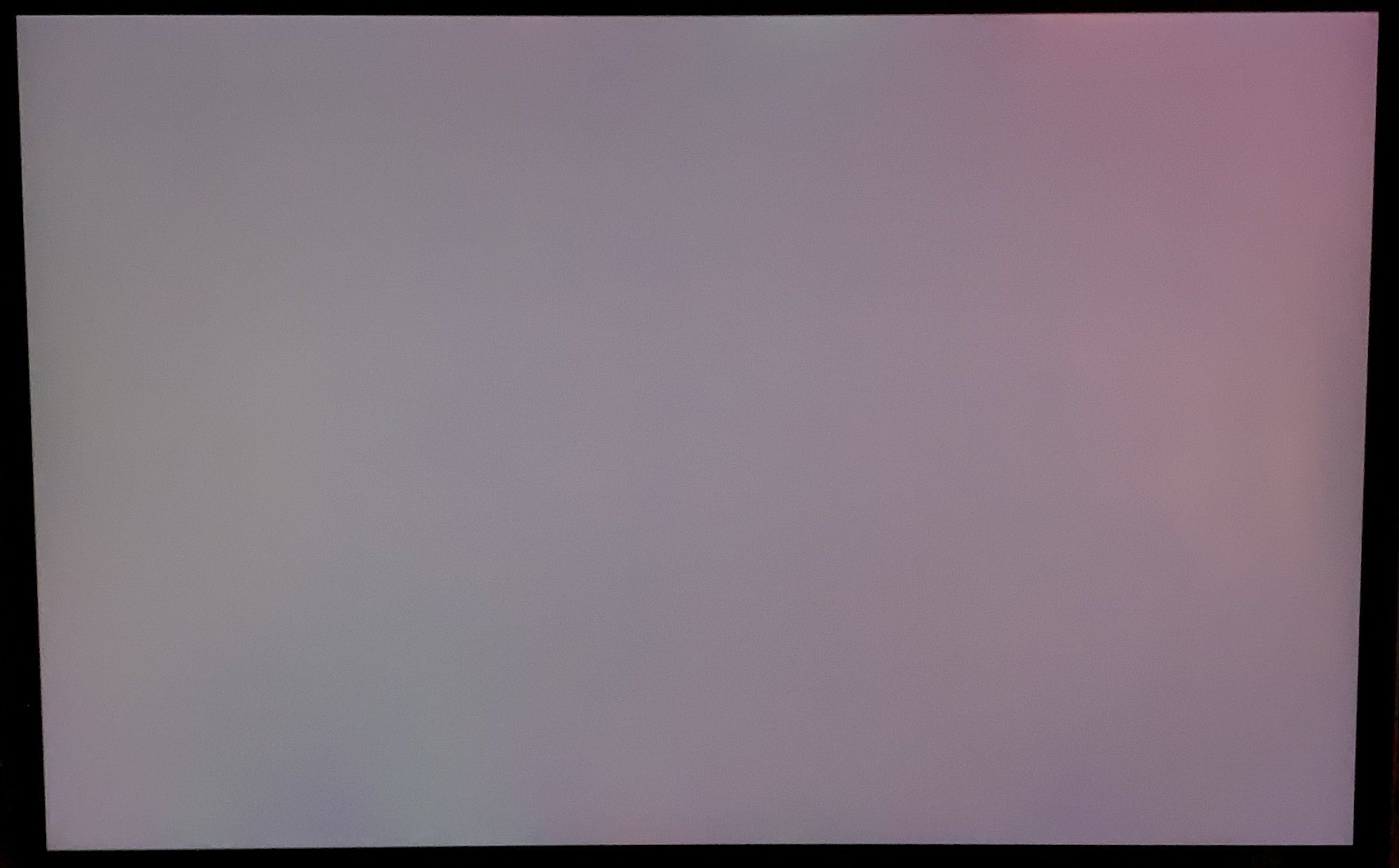

I realized that something is wrong when I got it - then I tested it and found out that the display has the red glow at the right side (and more green at the left).
While surfing etc. no - it does bother at all. But while working with photos/illustrations and while watching movies I do see it.
In my unit that red tint on the right just shops up in black or near black image viewed in dark room or with dim lights and high display brightness. So far nowhere else.

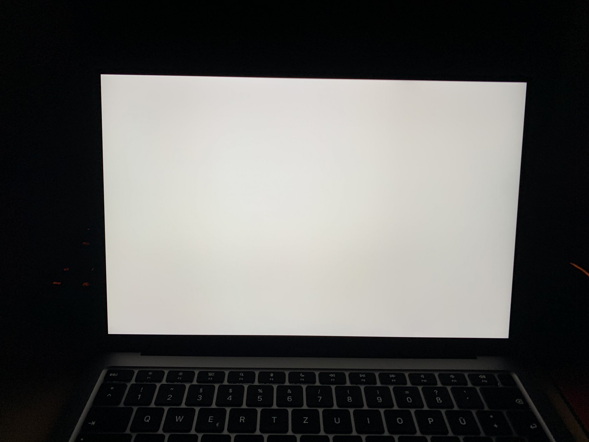

I can also confirm a red glow on the right side of this MBA panel. I can see it in a dim room with the brightness at 70%+.
That sounds pretty common issue. I wonder if anyone actually has MBA M1 that does not have this glow when checking this way? I had MBP 13" 2019 and it did not have this red glow but otherwise I think my MBA has more even screen than my MBP had in brighter images. Contrast ratio is hugely better in MBP.

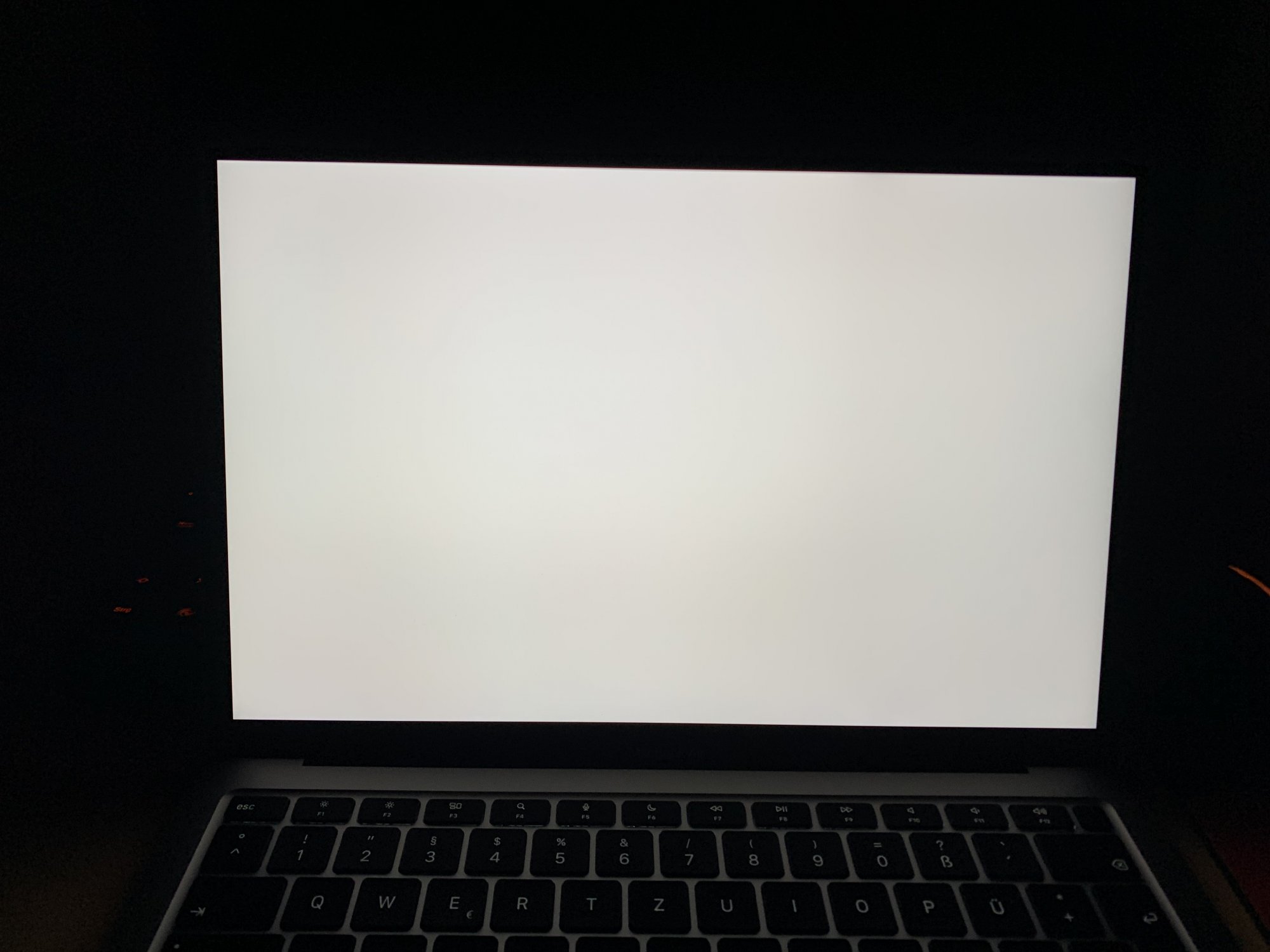

My black and white screen...

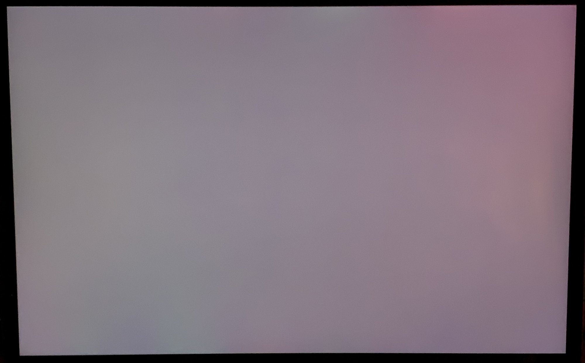

I’m still wondering what this glow is. Because if you look at all the images in this thread and if you adjust the brightness of the pictures every red glow looks the same and everyone has this small white part at F4.
So this is no typical bleeding or anything like that. If you look at IPS gaming monitors every monitor from the exact same model has different bleeding.
The MacBook Air model on the other side seems to be made this way. Also if I turn the screen around and view it from different angles the red appears everywhere. Could it be that when the panel is coated the process starts at the left side and ends at the right side? So like if you spray with an airbrush you will have most of the paint at the end of your move.
Looks pretty idential to my MBA M1. Thanks for posting your photos! These are valuable information for all confused with this issue whether they have a faulty unit or if this is a feature.

I'm also leaning to that it must be coating or similar causing it. It cannot be just few faulty units as they seem so idential. If it was some odd fault, there would be some variation how it shows but these are all just too identical for that.
And I agree too that white and bright images are pretty much perfect in uniformity in MBA, even better than my MBP 13" 2019 was even that one had perfect black image uniformity and higher contrast ratio. This is one of the reasons I'm leaning on keeping my MBA. Also I'm considering MBP M1 probably is soon obsolete model likely because there is just so little difference to MBA to justify the price difference.
