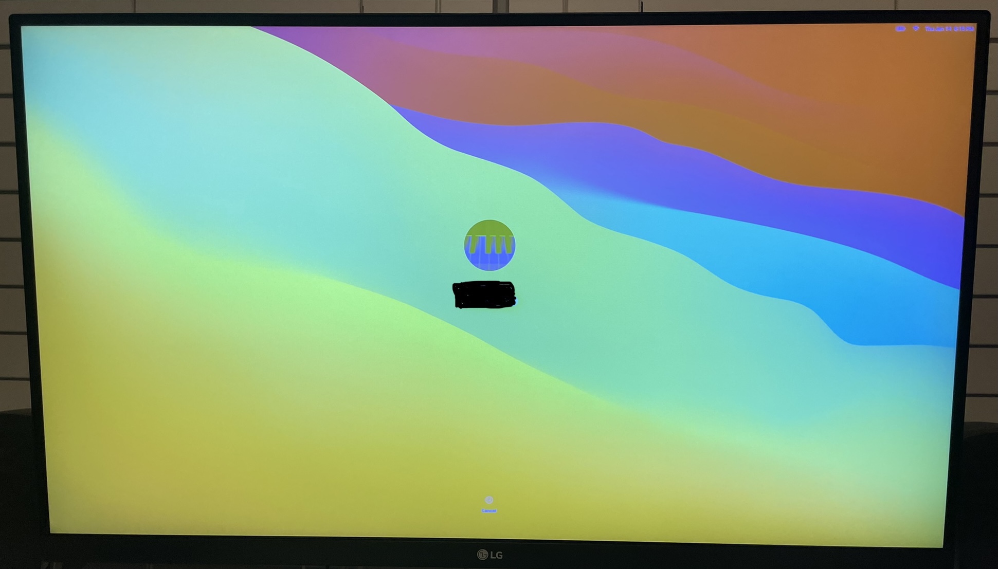

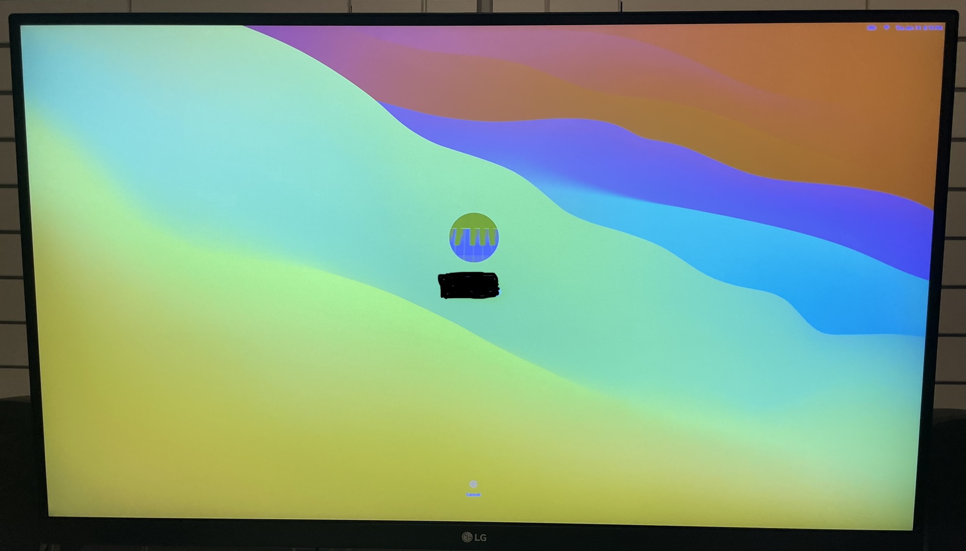

I get this yellow tinted screen with the Apple av adapter and en external monitor after letting the machine sit for awhile.
Exactly that yellow screen with mij apple multiport adapter A2119
