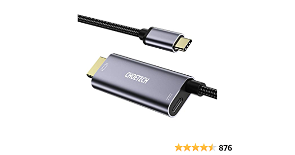

I'm using "CHOETECH Type-C to HDMI Adapter 6FT 60W PD Powering Cable Thunderbolt 3 (4K@60Hz)"
