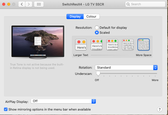

I want atleast HiDPI 1440p or to be able to set my text size in 4k to be abit bigger. I'm not getting the "Larger Text ---- More Space" options as shown in the pictures below.

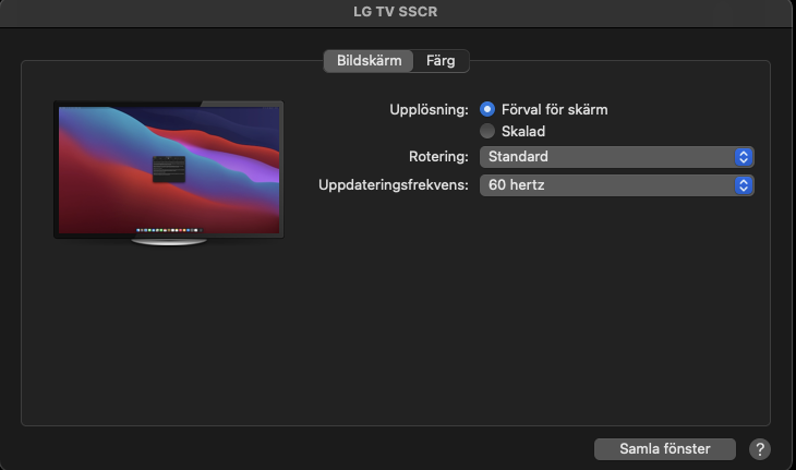

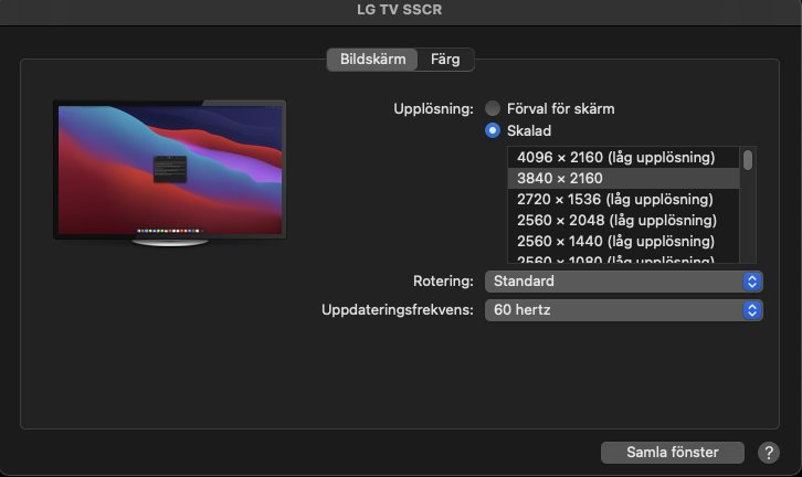

This is how it looks like when I'm trying to change resolution;
(Its in Swedish but you'll understand anyways)

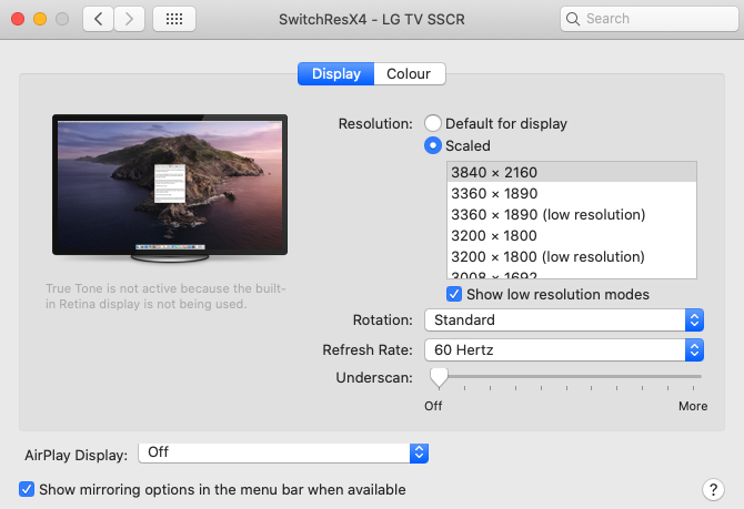

And this is how another person sees his resolutions using the same monitor but another Macbook, not the M1:
So even though we are using the same monitor, using the same HDMI connection, we get different options regarding scaling and resolutions. The only different thing is I'm having the M1 macbook.
