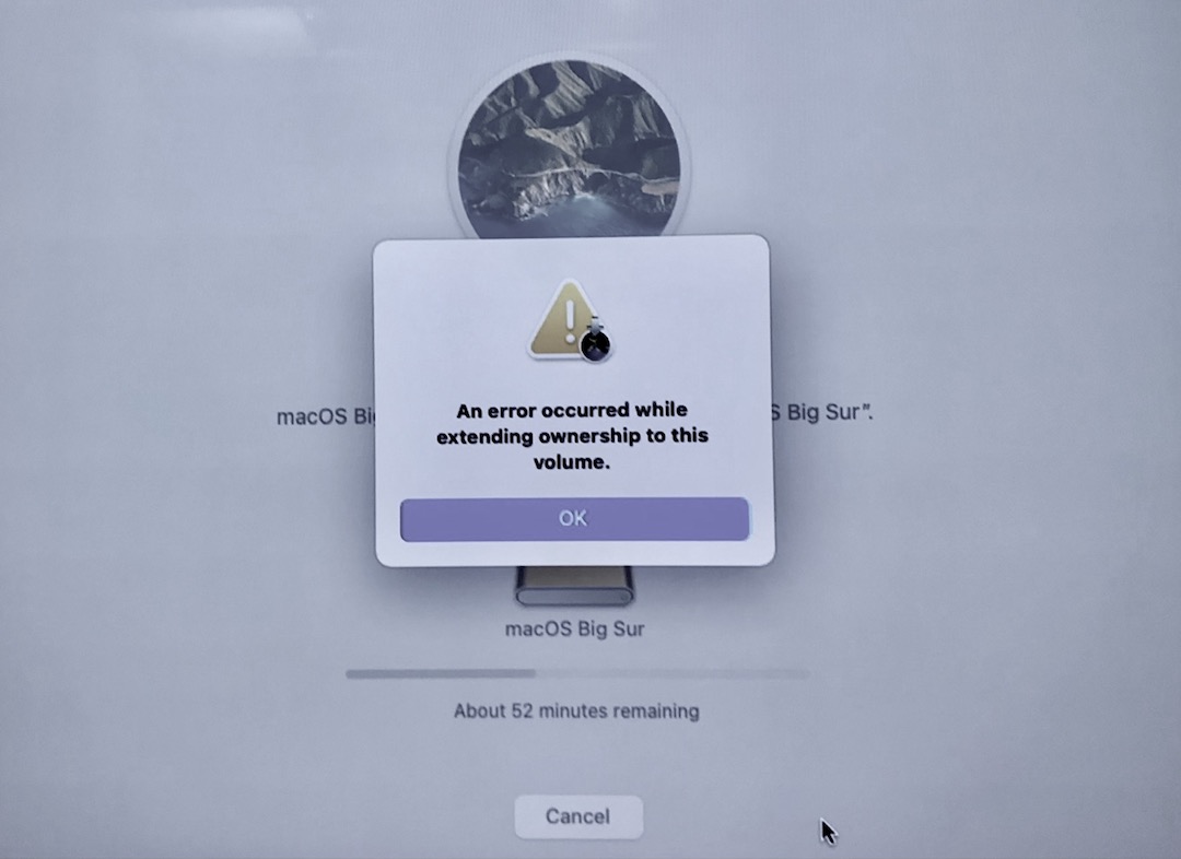

I have tried everything under the sun but so far nothing has worked. I even contacted Apple directly but they had no clue. I was able to install 11.01 on the external, but when I try to boot into it I can't get past the login screen. I tried every admin username I have ever used but it rejects them all. So I tried to install 11.1 on the external and it always gives me a "An error occurred while extending ownership to this volume". It always happens at the same place in the install process, with 52 minutes to go. Very frustrating because this same external drive worked flawlessly with a intel Mac mini. I really wanted to keep this M1 but it looks like I might have to return it. Not being able to boot into an external is a deal breaker.

You’ve done erase/install in recovery mode? I can still switch to external fine, but I get a download error for 11.1 update with nothing 3rd-party installed. I might go to recovery to reinstall-update it.

It allowed me to install 11.01 in recovery, but not 11.1.
Are we sure it's an enclosure issue?
It never occurred to me that my USB drive might be the problem. I’ll have to dig up another unused USB drive and see if that works better. I’m using an OWC USB 3.0 Envoy with a repurposed Apple SSD from an upgraded Mac Pro. It is a special version of the OWC Envoy designed to only work with Apple’s modified NVME SSDs.
I have tried two other USB drives. None are bootable with the M1.
Apple has a Configurator app that is supposed to help with the installation that I will try later.
I was unable to update the external to 11.1 because of a recurring download failure in System Preferences, but reinstalling Big Sur in recovery worked so that it is now on 11.1.
