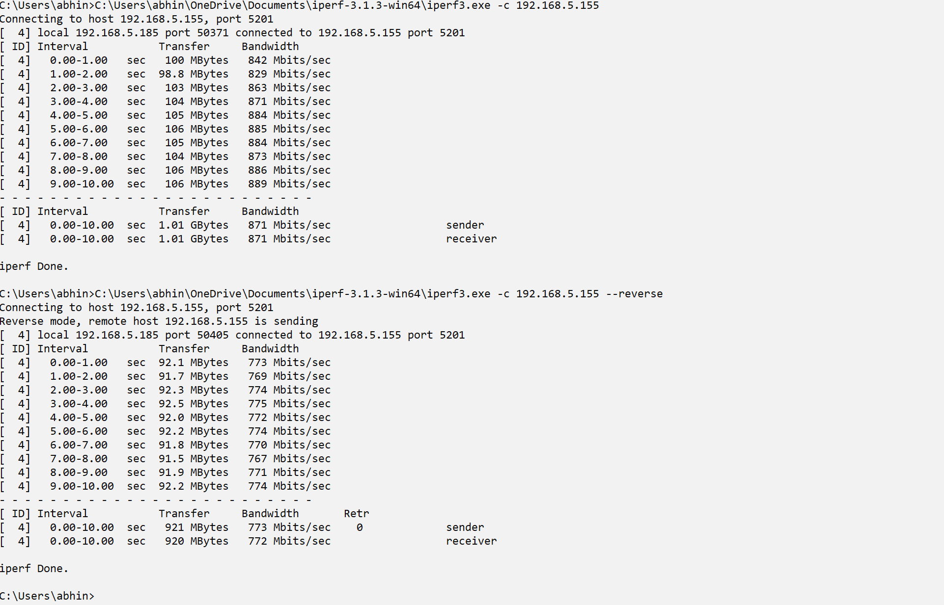

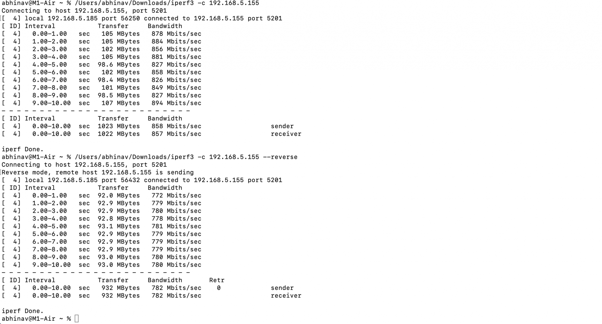

I am getting pretty much the same speed on the M1 as on a windows i5 10th gen system with the same USB setup
(i.e. ethernet adapter via Multiport -> Hub)
A direct connection between the eth adapter and MBA (via a USB C-> USB A cable) yields slightly faster results i.e. around 925-950 mbps . I am guessing the 50-80 mbps loss with the chained connection is on account of overheads at either the Apple adapter (which is also driving a 4k60 monitor) or the TP Link USB hub (which has several other peripherals)

Looks like you have not gotten a reverse connection. There is a space between -- and reverse in your command line.
Right - thanks for spotting the typo ..
The adapter seems to be behaving the same regardless of M1 or windows x64..
(It's Connected via the same chain in both scenarios)
See screenshots below
