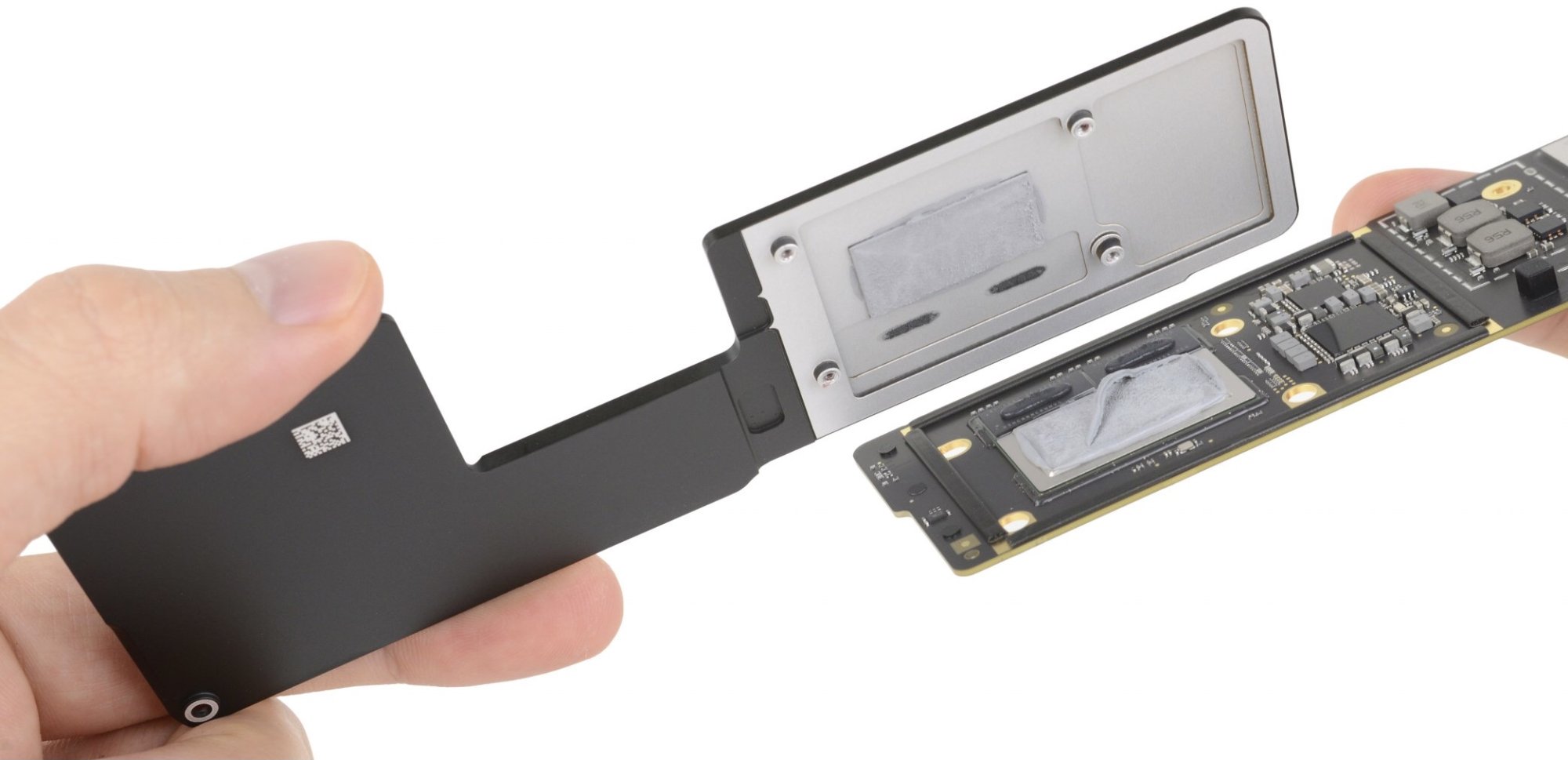

This is what the heatsink looks like for the fanless M1 Air:
photo from iFixit

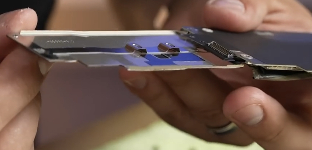

And this is what the heatsink looks like on the fanless M2 Air:
photo from Max Tech (YouTube)
Clearly the amount of thermal mass of the M1 heatsink is several times greater than that of the M2.
It is disappointing that Apple chose to reduce the heatsink thermal mass between the old Air design and new Air design. The M2 and M1 produce a similar amount of heat at ~20 watts.

Maybe. But what an incredibly small trade-off it would have been to increase the heatsink thermal mass to a similar size as the M1 heatsink. It looks to me like it would have fit; or at worst added 1mm or less to the thickness of the case.
I realize people care a lot about thickness on the Air, but I am having a hard time imagining making this engineering choice. I love fanless designs (my 2015 12” MacBook is a prized possession), and appreciate the trade-offs necessary; but there had to be a way to engineer in a tiny amount more thermal mass here.

What an increased thermal mass does in a fanless design is regulate the temperature over a period of time. So instead of shooting up to the thermal limit in 30 seconds, it takes much longer. So you might have several minutes of full performance before performance must be reduced. This can have a substantial effect on your work throughout the day if you ever run sustained processes (video/photo/compiling/etc).
So it’s not about just dropping the temp; it’s about smoothing out the temperature curve.
I completely agree that Apple employs top notch engineers. But their thermal designs have not always been up to snuff; and there is nothing wrong with being critical when this happens. That’s how we get them to improve their future products.
