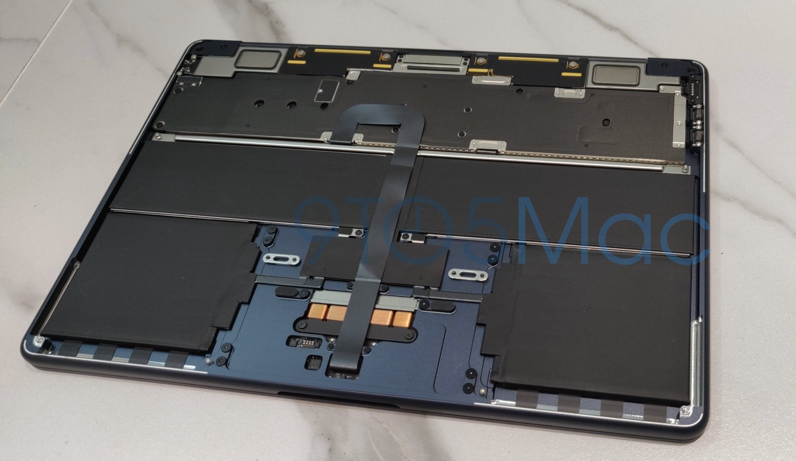

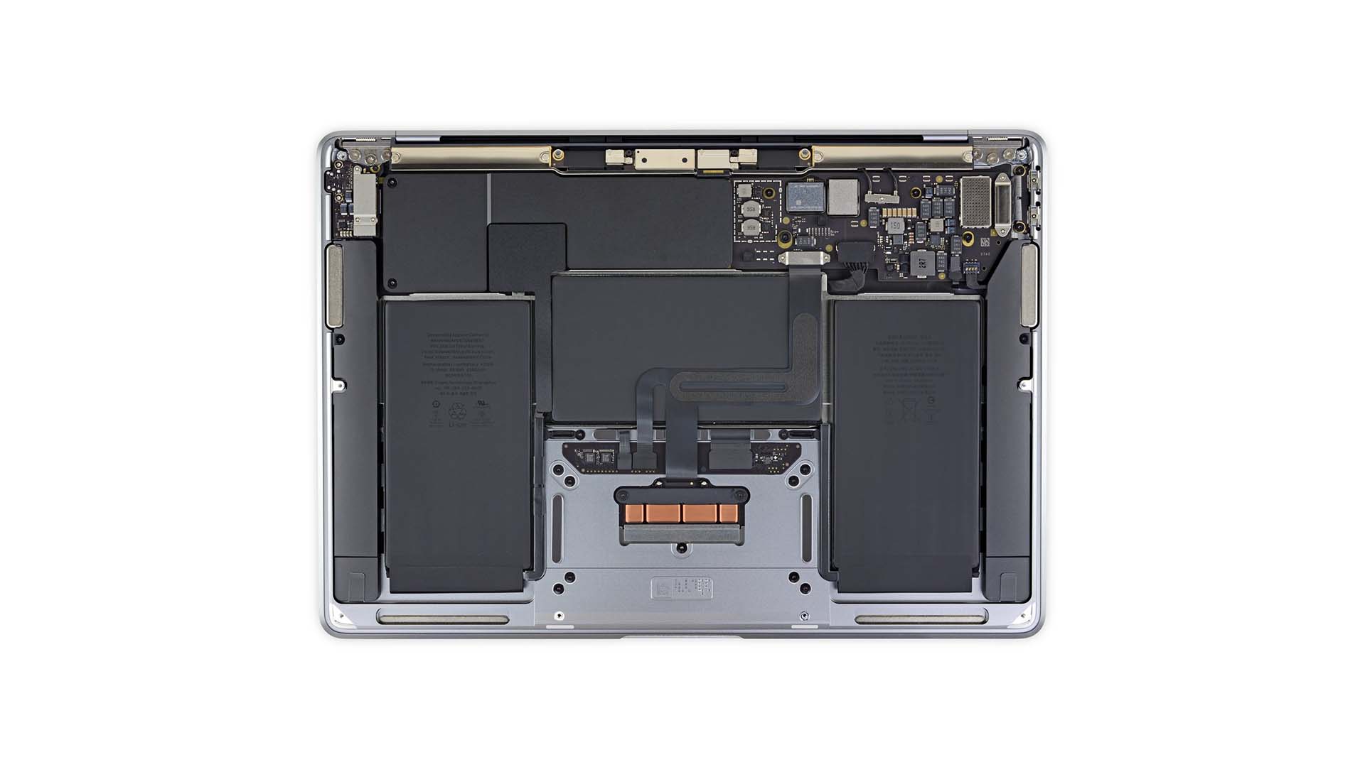

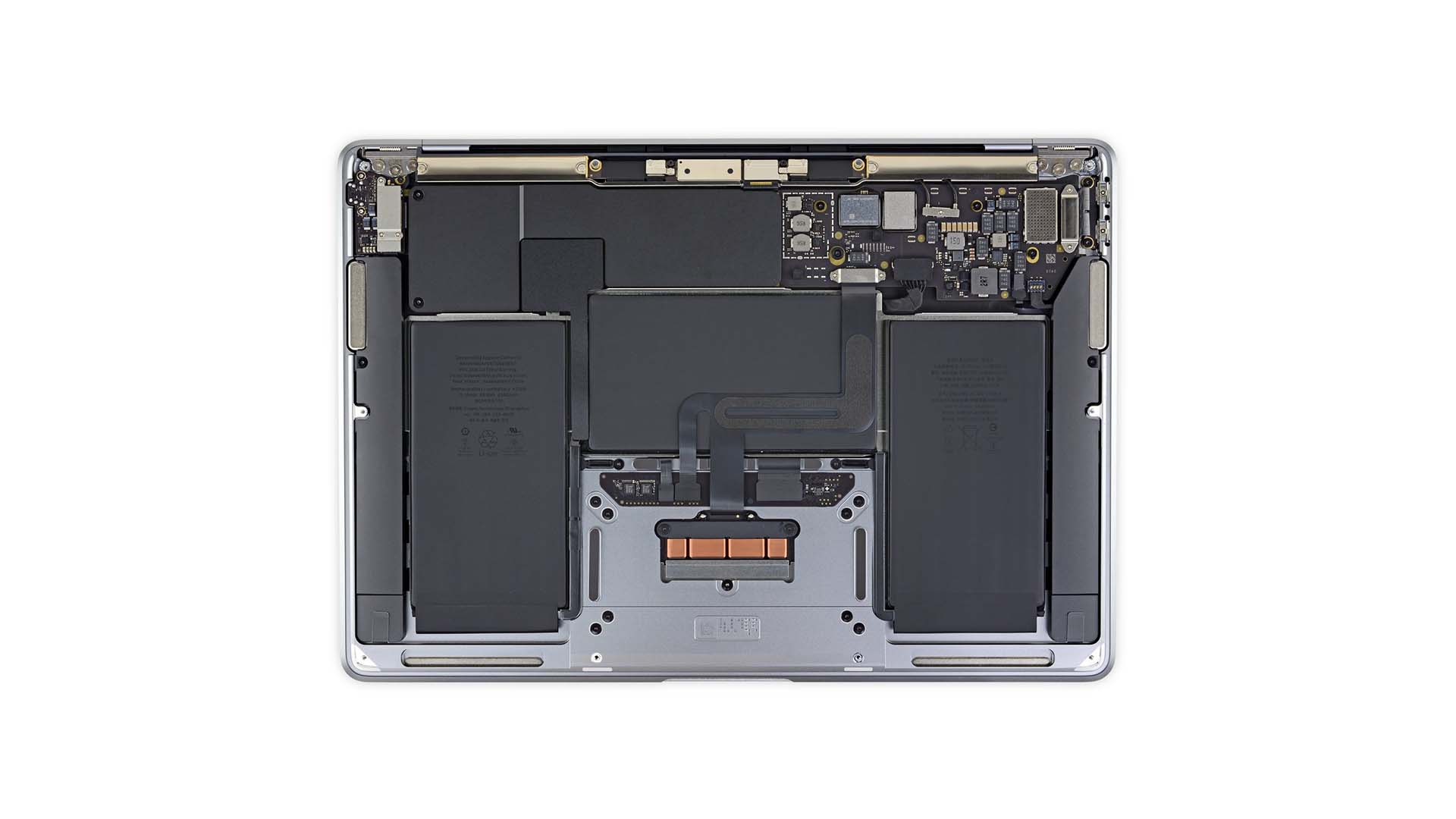

Could you point us to these photos? Would like to see how it differs.
M1 Air
M2 Air

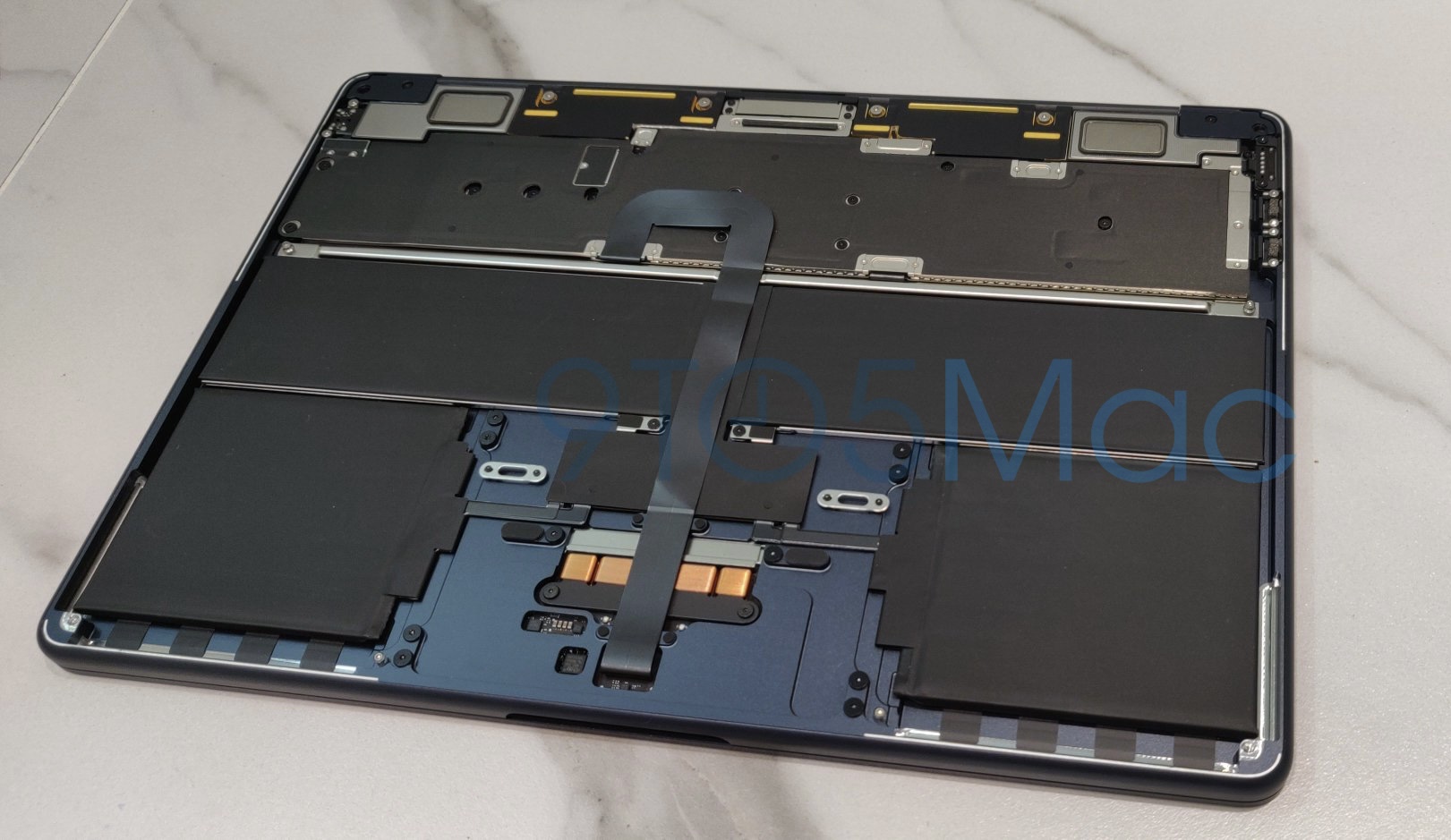

I wonder if these reviewers are under NDA constrains to not further remove the plastic cover? From this shot it is hard to guess where exactly the M2 chip is; if it is near center with the four screw holes, wouldn't that trackpad cable directly underneath be a problem?
Absolutely they’ll be under NDA not to open it up whereas independent reviews with purchased units will have no such constraints.
As for the trackpad cable that is seemingly an odd design choice. Obviously it’ll have a thermal rating and Apple must be certain that this will not be exceeded otherwise they wouldn’t have routed it there. But yeah it does look somewhat incongruous.
There are more photos here - https://9to5mac.com/2022/07/13/exclusive-m2-macbook-air-internals-in-hands-on-photos/
what is the problem with trackpad? heat?
No problem really. More my incorrect assumptions than anything. If you look at the internals of the M2 Air you can see that the trackpad ribbon cable runs over what I thought was the surface of the heatsink. In actuality it’s well insulated and while it’ll warm up under load (along with everything else) from what I can see there will not be any heat-related issues caused by this design.
But it is still an odd choice to position the trackpad cable crossing exactly where the M2 chip "cover" is. Even if insulation is sufficient, there are cooler places on the board for that cable to cross, so at the end this is creating unnecessary potential heat build up into the cable. We are going to get heatwaves soon so every degree counts.
