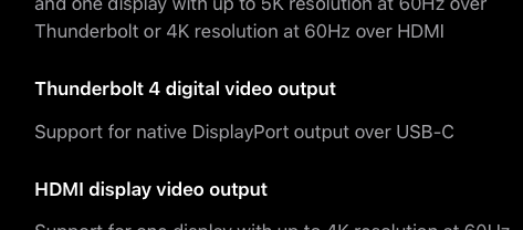

The Apple Website states the M2 Mac Mini supports "Native Displayport output via USB-C".
An Apple support document states to connect a Displayport monitor to the M2 Mac Mini, you should do so using a USB-C to Displayport adapter cable: https://support.apple.com/en-au/guide/mac-mini/apd8e4fbbb97/mac

1) Apple does state USB-C to Native Displayport support on their website, and I am connecting it right.
2) My Mac Mini M2 isn't showing signal via the USB-C to DisplayPort cable to their own monitor.

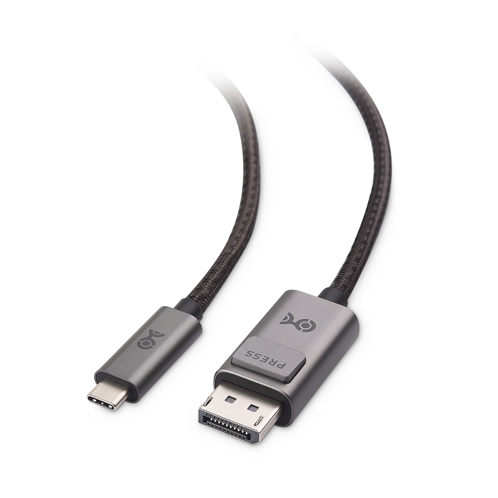

While the StarTech.com cable works, I'm a big fan of Cable Matters cables for active cables because they offer good support and are only manufacturer I've seen offer firmware updates on their websites for display cables. For example, I just did a firmware update on a usb-c to hdmi 2.0 active cable that has a chip inside cable to fix an issue I was having. Only downside was I needed a had to have a friend do it since the firmware software requires windows. I know not to try VMs for firmware updates after bricking a couple devices.
Here is a USB to DisplayPort 1.4 cable that advertises 144Mhz @ 4K:

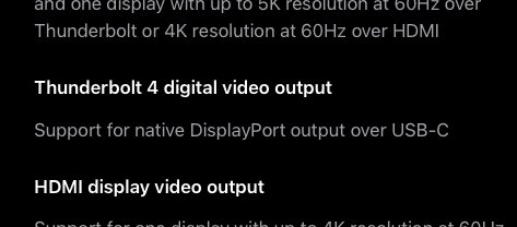

I bought a third USB-C to DP cable and that one works reliably (a CableMatters one).
I guess it was spotty cables. Weird that it worked fine with my HP notebook or that using DP1.2/DP1.1 didn't help. I don't think signal integrity was the issue. Maybe the wiring was wrong somehow and that prevented my Mac from negotiating with the display? Maybe the display engines on M1 are more flexible with non-standard cabling and that's why some M1's can drive displays that M2 and M3 Macs fail to drive.
I also bought a USB-C to HDMI with the famous VMM7100 chipset and that works perfectly as well (after flashing with the custom firmware from the big thread). Only con is that I don't have VRR.

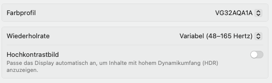

I have @ MBA M2:
the Asus 32"Monitor connected via USB-C -> DP Cable and variable Refresh Rate 48-165hz and HDR avail.
Get a quality Cable and check the Monitor for AMD FreeSync Premium Pro.
DRM is also no Problem and i get full Resolution on Safari for Prime or Netflix.
