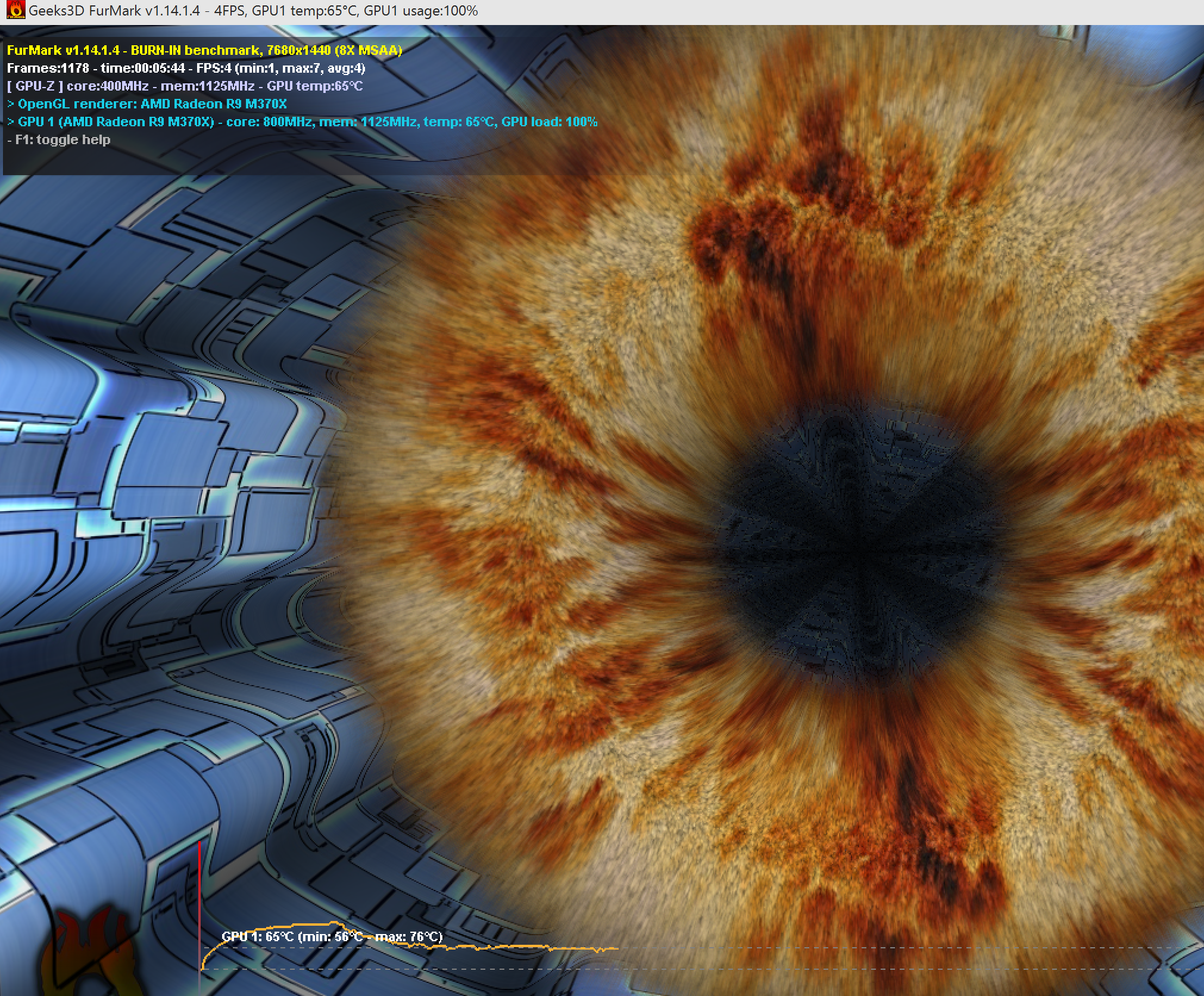

For those of you who already have your machines, have you noticed the m370x throttling a lot? I ran furmark using bootcamp in Windows 10 preview, and about 2 minutes in, the GPU core speed drops from 800mhz to 400mhz and remains like that for the duration of the test. The top temperature was 76 degrees, which doesnt seem like it's high. After the initial climb to 76, and throttling down to 400mhz, the GPU remained at around 65 degrees without climbing back up again.
Has anyone experienced anything like this? I know Macs aren't gaming machines, but with my old 2012 with the 650M, i used to game for hours on end without noticeable throttling, so this is concerning.
P.S. this is for a CTO 2.5/1TB.

Furmark is useless as no game will run gpu like that. Get MSI Afterburner or GPU-Z and enable logging and then play an intensive game like Crysis 3 or Witcher 3 for 30 minutes and report back on the speed and temps.
Furmark will ALWAYS throttle up and down, even on machines built for Windows. Not a reliable indicator of actual performance at all.

Like what others said, Furmark is a stress-test and no games will run like Furmark. Furmark is essentially like Prime95 - just for stress testing and not much real world apps will run like them.
You don't even reach throttle temps. You need to rename furmark.exe to something else if you want to test gpu cooling because the GPU driver detects furmark.exe and throttles even before any temps would require it.
It is more accurate to just use games or 3Dmark.

You will find that it's not just the thermals, but also the fact that the Apple power supply just can't feed enough current to the laptop, this will also induce throttling.
Furmark and a GPU some accelerated BOINC apps have a lot in common... I've never killed a card with furmark nor the 1000+ hours of computational GPU apps. Furmark does a lot of memory shuffling within the card (from GPU to Mem and back)while running the card at full bore to keep the tech talk simple. This can increase the power draw quite a bit and will show instabilities almost instantly in terms of frequencies between those busses. What you're actually seeing and what some people already pointed out in the PSU limit being enforced by EFI. I have been trying to find some factual TDP numbers here as most sites say 75watts!!! but that has got to be a lie. I'd estimate more like 45-50 with the clocks being so low. So if you guys haven't guessed already, its gimped straight out of the box. It's throttle PREFCap Reason is Power limits not temps.

I had exactly this same problem and it frustrated me to no end. I have resolved this issue on my 2014 mbp 2.3 doing 2 things.
1. doing the Full hardware scan at the "genius bar" - the quick built in one thats built into osx did not reveal my hardware issue.
The full scan determined that the aftermarket Samsung 830 pro ssd that I installed was not performing as expected through shotty driver support.
2. I replaced the ssd with the factory spindle drive.
Voila - no more throttling. I can now play vids and stream at the same time and no throttling. My temps never heated up past expected under heavy load. It never gave me any warnings on throttling. I had used a kext editor to adjust all the thermals up in the cpu and gpu steppings to obscene levels - no bueno on resolving the throttling issue. Every hardware test I threw at it looked and seemed fine. Transfer speeds for the burst drive tests were golden always. Sustained loads to the drive just triggered something in osx to throttle back transfer rates and it actually started clocking back the cpu AND gpu down to the 1/4 and 1/2 steppings.
It couldnt handle the power.
