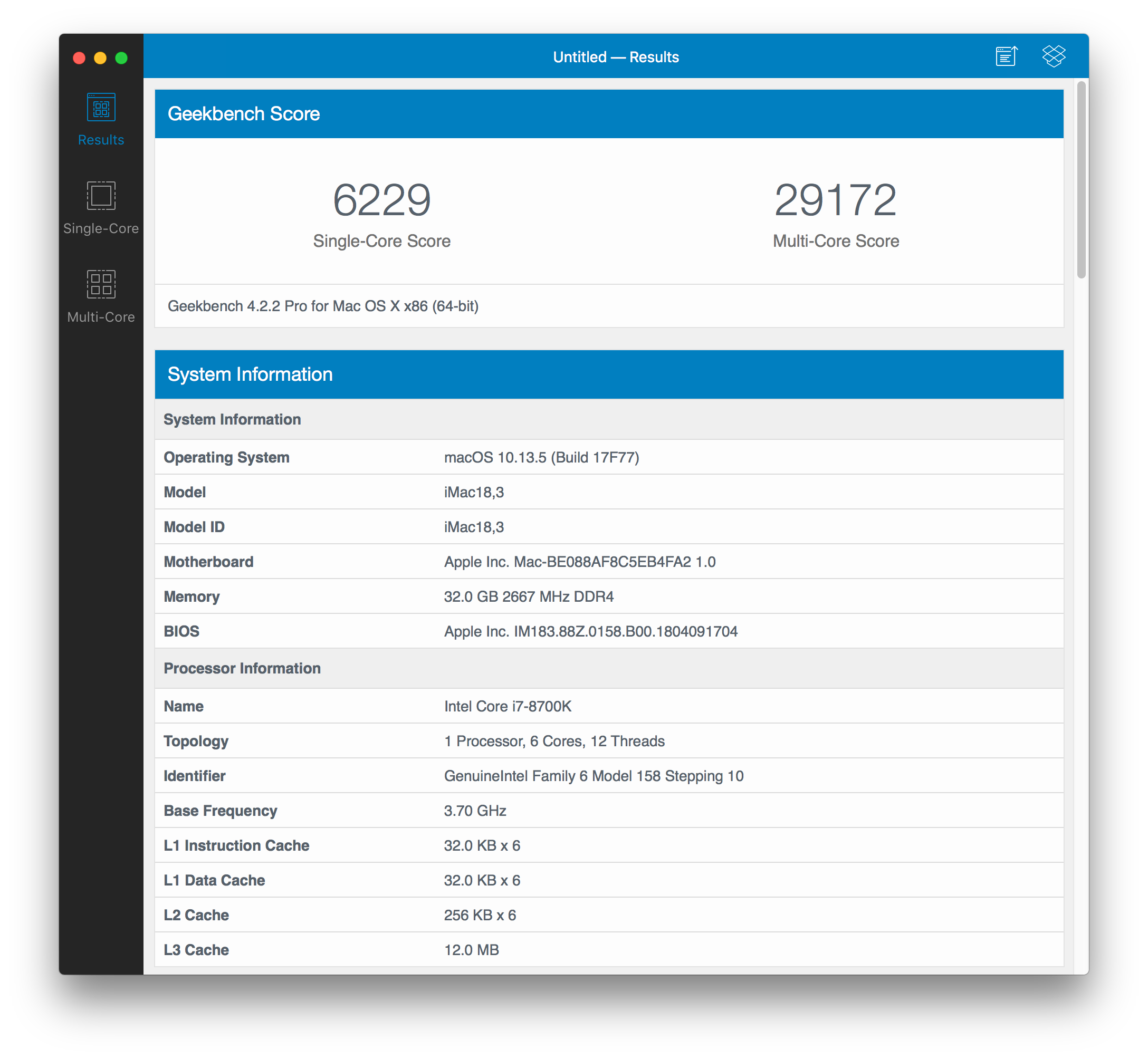

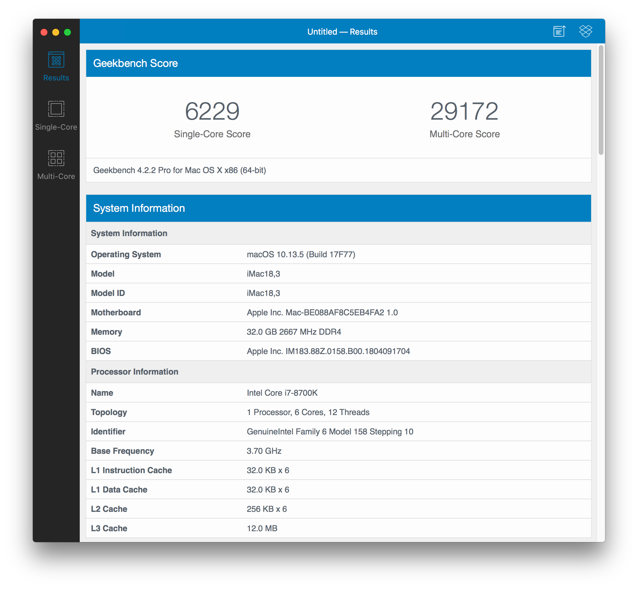

I just did some Benchmarks on my 8700K Hackintosh. In fact, the 8700K's multi thread performance is comparable to a dual X5690 system. In fact, my CPU can run at 5.2GHz stably, but I don't like the extra heat and fan noise. Therefore, only run it at 4.8GHz, and this is the 4.8GHz GB4 result.
Even need / want macOS, 8700k still a very nice option. The key is just pick the correct hardware (mainly the motherboard). Follow pastrychef's guide to get the exact same hardware will allow you to boot and run your Hackintosh effortlessly with just 2 steps.

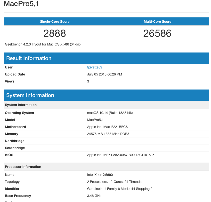

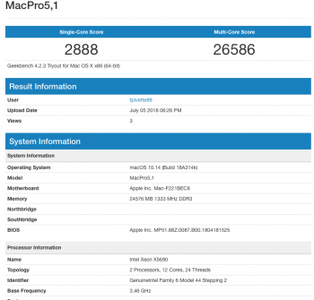

Wow... those scores are mind-blowing. More than doubles the single-core score, and scores 2500 more than the multi-core score of my dual X5690 Mac Pro.
