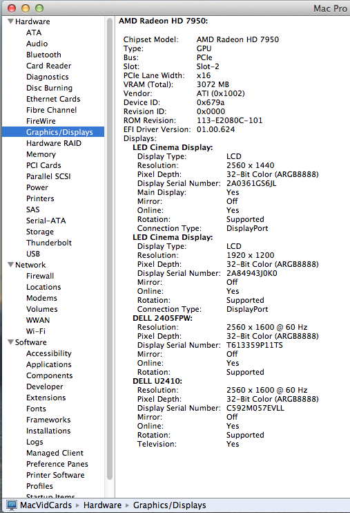

Sweet card, running 4 displays with ease.

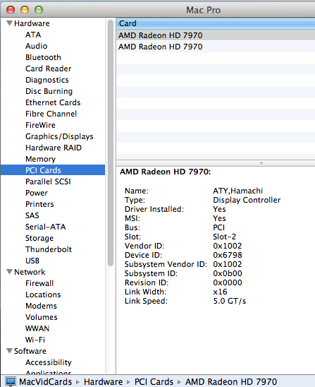

The EFI is useable on other cards. I have already gotten 7870 and 7770 working with boot screens, though the 7770 only shows on VGA. We will need to try different personalities.
Flashed cards will run at PCIE 1.0 without further work, though I have gotten 7970 to 2.0.
A PC 7970 can be flashed to work in a Mac Pro at PCIe 2.0 speeds AND will show boot screens (at least on some ports)? Is that correct?
So there's hope for a fully or near fully functioning flashed PC 7950?
Don't all 7970s use one 6-pin and one 8-pin power connection which would require a potentially problematic 6-pin to 8-pin adapter or an external power supply?

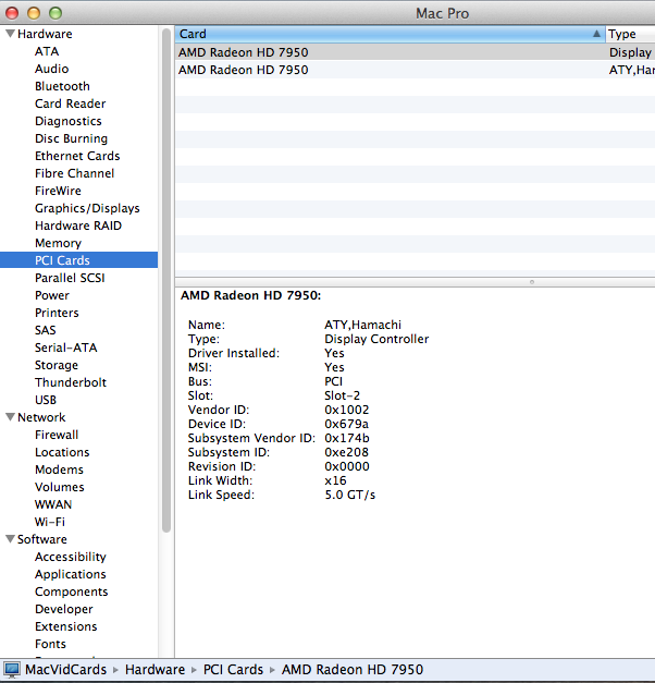

If you flash a 7970 with stock Mac 7950 BIOS/EFI you end up with a slightly faster Mac 7950, that runs at PCIE 1.0.
To get it to run as a full EFI 7970 with boot screens and running at PCIE 2.0 requires some rom modding and is specific to each card.
The OpenCl results only go up a little but the bandwidth numbers are impressive.
Doable though.
