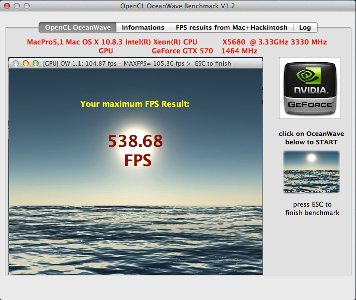

Evga gtx570
Weeee... :p

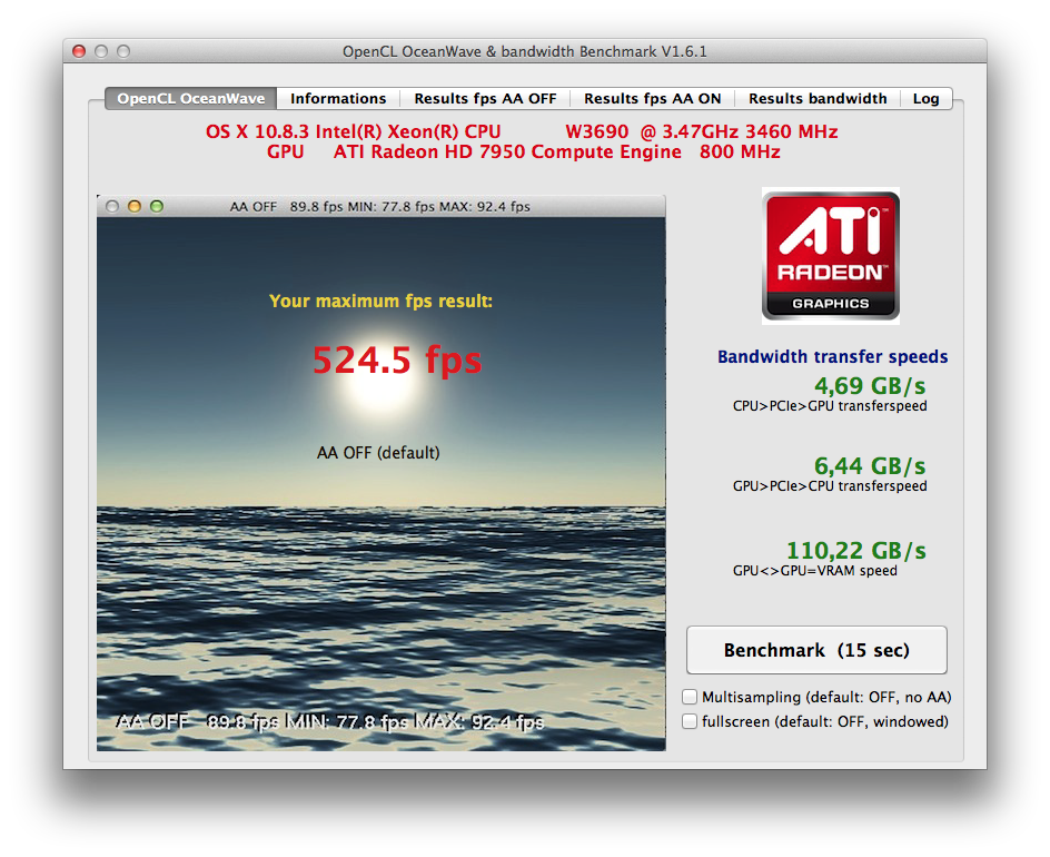

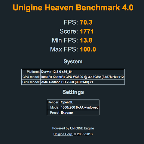

OpenCL OceanWave Bandwidth V1.6.1 GTX570 & GTX680 Heaven 4.0

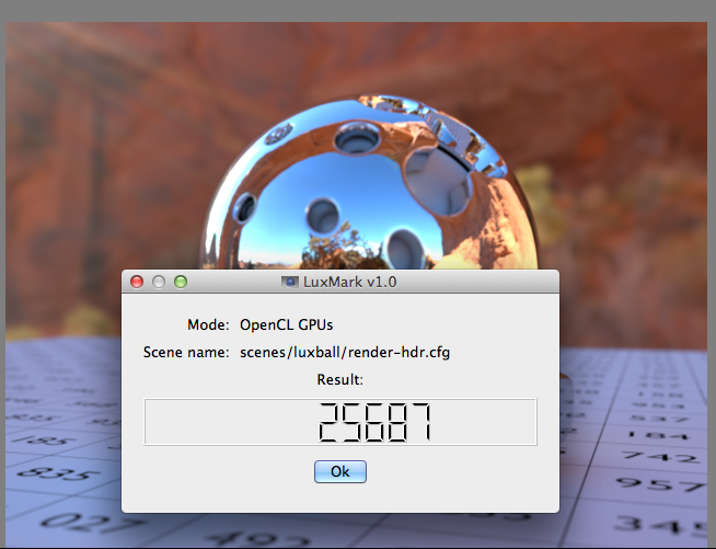

Sapphire Radeon 7870 Ghz Edition:
Now will test Radeon 7950 Mac Edition in a few minutes...:apple:
Sapphire Radeon 7950 Mac Edition:
(Little disappointing, my PC Radeon 7870 is faster) :eek:

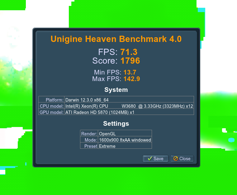

I'm trying to run the heaven benchmark but, as soon as I enable anti-aliasing, I see graphics corruption, as in the background here. I'm running an Apple 5870 in an upgraded Mac Pro 4,1.
Any ideas?
