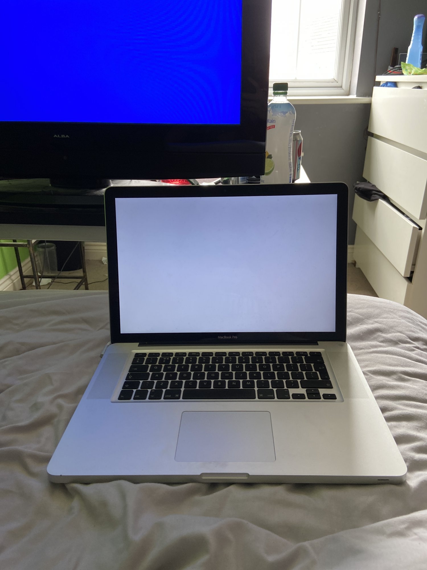

Hello I just had problems resetting my Mac it wouldn’t let me go into recovery mode or anything so I managed to command s and get into root n do it but now my screen has just gone white after going through the system updates etc

Has had that white screen since I had to connect to internet and select language And do a system after that it went to that screen

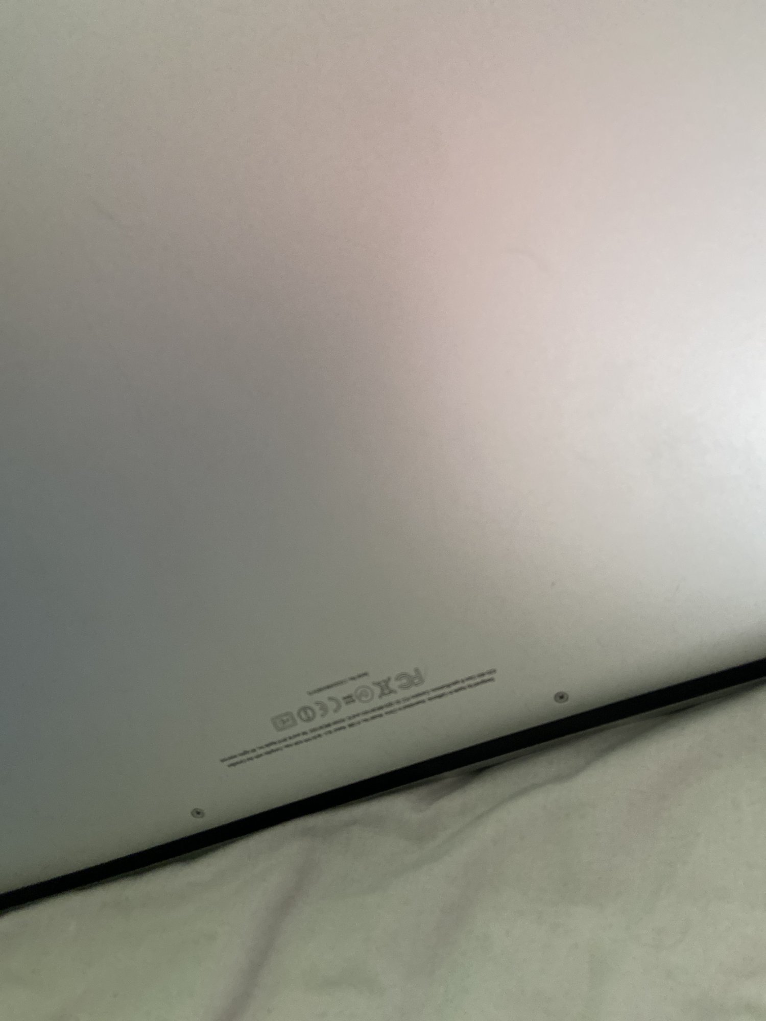

Pre Retina 15" MBP, model number is on the base. You may have to restore from a USB drive is the HDD has corrupted. without the model or OS version makes helping far more difficult as some MBP's have specific issues as has OS X evolved over the years.

Is a Late 2011 15" MBP. This model suffers a lot of issues with the Radeon dGPU, equally as it's booting and the display is working looks to be ok. you'll need to shut it down and try to boot into recovery or single user to see if you can run disk utility and apply first aid. If not, may be best to download OS X 10.12 or 10.13 from Apple and install from a USB Flash drive.
Please delete your picture to protect the serial number

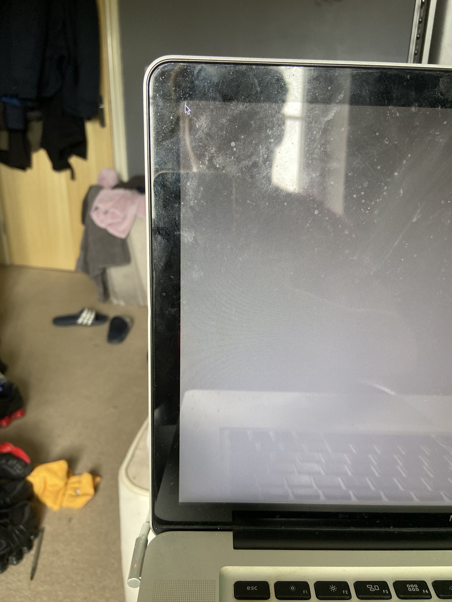

Now comes with this

Log in and see what it does

Doesnt do anything so i just tried to boot in recovery mode if that doesnt work ill try login to it again then if not i have no clue

Had the dGPU failed the MBP likely wont boot or the display would be scrambled. In this case hopefully a SW or drive problem.
2011 15" MBP needs adequate cooling (raise the rear) and usage of the Radeon dGPU should be reduced as much as reasonably possible. Choice of OS X version matters as SW is needed to stop the Radeon dGPU kicking in. Go too high with OS versions and I believe that you will not have that capability.
My own stock 2011 15" remains to run (10.13.6), equally I'm mindful of it's hardware shortcomings and it's potential for random failure.

I had a late 2011 15" with a failed Radeon.
With an encrypted drive, I was presented with the log in screen. Once I entered my password, I would see the progress bar. When the bar got about half way, the entire screen turned white and I could not see anything on the screen. I had the GPU replaced and it's been fine for years.
Th OP's GPU may be in a different state than mine which is why the login screen appears with or without encryption.
