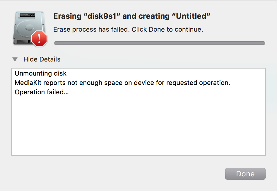

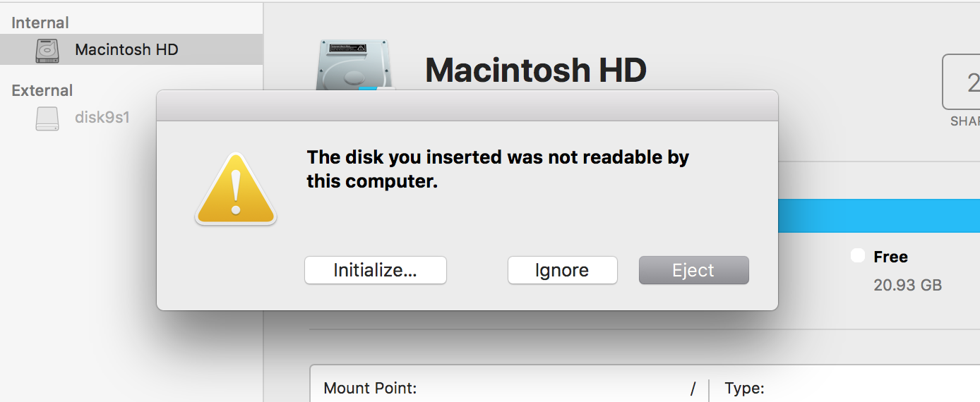

Tell me about it. I've bought a brand new 2TB external drive which came MS DOS formatted. Tried to reformat and it seems to have completely screwed the new drive.
Does OS X have issues with formatting drives? I'm wondering if the new OS X is what has screwed my old drive, too.
[doublepost=1515161843][/doublepost]Says there's not enough space. All the info I can find says the 2TB WD Elements drive should weigh 231g - this one weighs 130g. I wonder if Amazon are selling counterfeit stock?

I recall reading (might have been here) that for some reason, using Disk Utility to attempt to initialize (erase) a drive to HFS+ may "fail" the first time. BUT...
... coming right back and attempting to do it a SECOND time may work.

Did you try initializing the external? APFS is optimized for SSDs and not recommended for HDD. You should format the external as HFS+. Time Machine doesn't support APFS at this point either.

I found some forum where someone had put down a load of Terminal commands to get the external HDD back up and running, so it's working again.

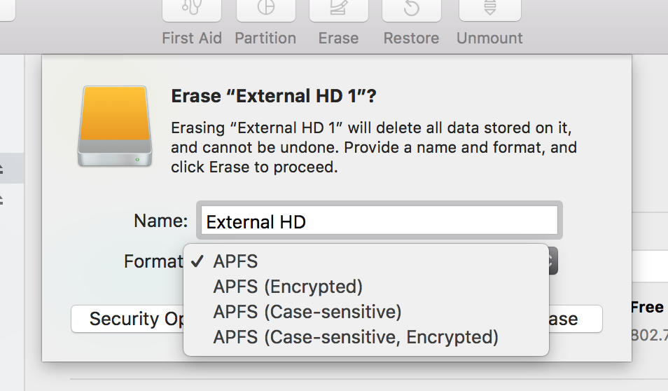

APFS isn't recommended for HDD? Who says this? My Mac knew it was a HDD but offered APFS.
And now it's APFS, I can't reformat it in HFS.
APFS is optimized for flash/SSD storage. If you intend to use Time Machine it doesn't support APFS (yet).
Erase the APFS volume in Disk Utility and reformat it as HFS+ if you like. Keep in mind that you will lose any data on the drive.

I hear you, but you said that it's not recommended for use on HDDs. Could you explain where Apple say not to use it on HDDs?
Because, if so, why does my Apple Mac allow me to do it?

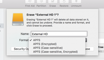

I can't. That option no longer exists.
So far as I know, Apple doesn't say not to use it but rather it's just that there is no particular benefit to using it on HDD as APFS is optimized for SSD.
When upgrading to High Sierra SSD are automatically converted to APFS but not Fusion Drives or HDD.
Just to be clear, are you booting to this APFS-formatted HDD? If so, you can erase it using Disk Utility in Recovery Mode. At startup press and hold Command-R. Once booted into the Recovery Console launch Disk Utility.
Ok, I was confused by your comment that it was "not recommended". It seems that's not the case.
No, it's just a back-up drive.

It seems you're very confused here. It's like you're trying to give advice but don't actually know the facts.
SaSaSushi said:
Then you should be able to erase the APFS volume, if you choose to, using the Erase button in Disk Utility.
As I've mentioned twice already (and even given you a screen shot), you cannot do it in Disk Utility.
You can go through the convoluted Time Machine shenanigans though.
