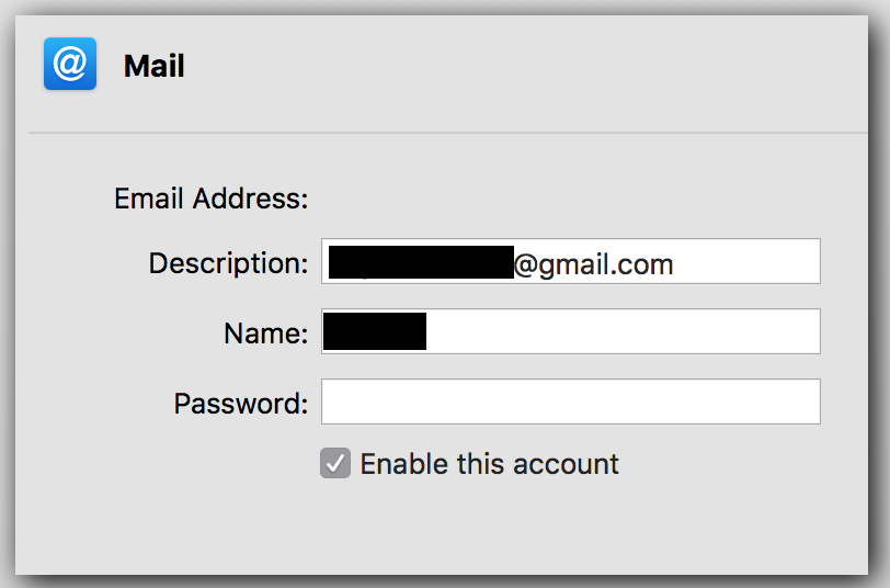

I had this before but then it worked. Google account in my OS X mail, and it normally sends and receives OK, but now and then it pops up with a window (from accounts) saying "unable to verify account or password".
Checking in a browser that OS X is enabled on this Mac, and all other devices work OK, it still says that. Several attempts, I AM SURE the password is correct.
After I try to enter the password, and it says it can't do it, then I cancel that pop-up window. Now I see this:
Notice the password field is BLANK! There are supposed to be some black circles (or large round dots, whatever you want to call them), but there is just blank.
I filled my password there - and now it works fine!
So try this:
1) Enter password or not in the pop-up, doesn't matter
2) Cancel that pop-up after it says "unable to verify account or password"
3) Enter the password in the normal account box, as above.
It worked for me, hope it can help others.
[doublepost=1490329889][/doublepost]Oh yes, and as soon as I entered the password there, literally within a second, gmail popped into the inbox.
Just checked again, it's all good now. And fortunately, a very easy fix!
Please, if it works for you, report back here. It's most likely a bug in Apple Mail.
