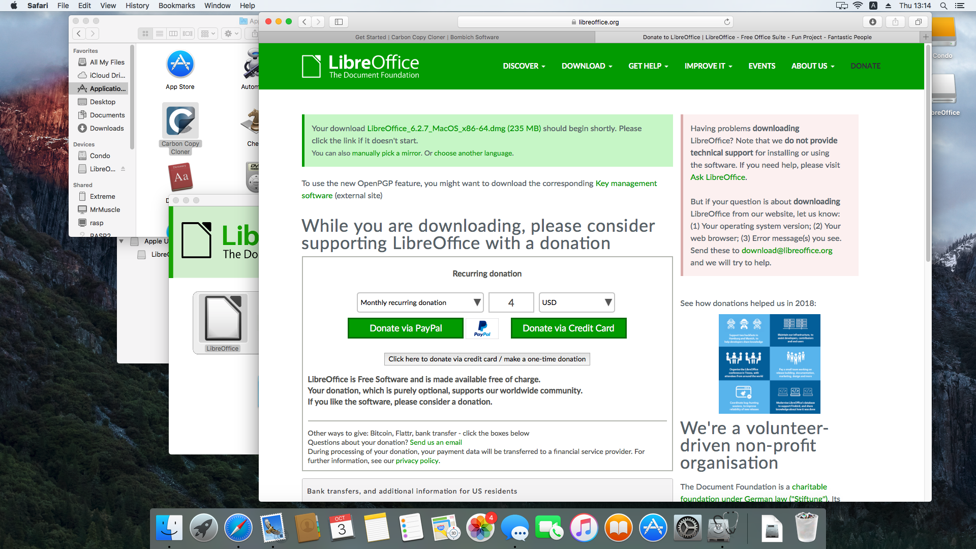

I tried installing on an external drive. That worked fine. It's all set up and running well. Surprisingly snappy!
Next step is to try to clone the external boot drive to the internal SSD.
And now, for the exciting conclusion:
I used Carbon Copy Cloner to clone the external boot disk to what we thought was a failed internal SSD. CCC did the task without complaint. I shut down, removed the extrnal drive and rebooted. Sure enough, the internal SSD booted up normally.
So, I guess the cause of the original boot failure may never be known. It certainly may be a failing internal drive.
