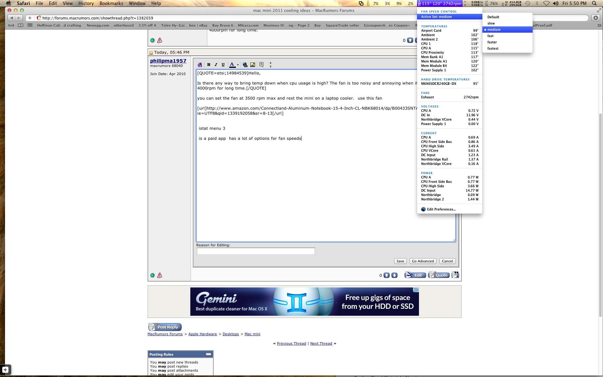

istat menu 3
is a paid app has a lot of options for fan speeds

my mac is running at 2700 rpm and is 113f see the thumbnail I also have 5 speed settings
